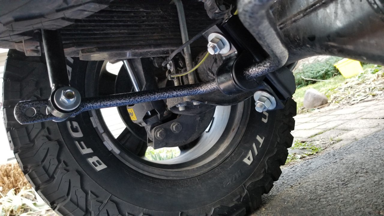

    We initially installed at the recommendation of our builder extreme duty Dobinson springs (model # L59-176-R) which Are not even an option for Tacoma's and are designed for the 2,000 lbs loads on a Hilux aren't cutting it.
    What we learned from this I think for you is to not do your expensive spring upgrades until the truck and camper are finished, then weight each axle and then see if the very good and cheaper Dobinsons or others willwork or then go for a custom spring setup. In the meantime you could temporarily install a add-a-leaf and/or airbags. Our custom Deavers were only $200 more than the Dobinsons
    Theres 10 leafs in there! Also a good view of the rear sway bar
