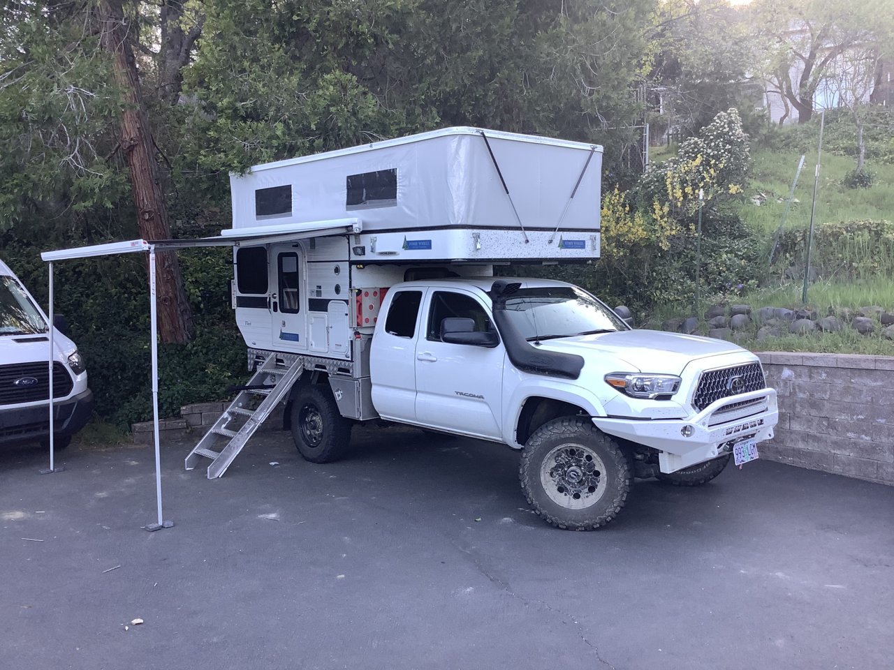

    My stock truck with no people or gas weighed 4,250 lbs.
    Today, with all of the modifications but with nothing (food, gas, water, people) in it, it weighs around 6,450 lbs.
    My Fleet flatbed which has quite a few options and has a sticker weight of 1,560 lbs but that includes 20 gallons of both water and propane (240 lbs) and the original battery which i replaced with a lithium, saving about 60 lbs. So the today my Fleet, completely empty, weighs 1,260 lbs.
    So that means I’ve added 940 lbs of mods! Yikes, a lot more than i thought. I deliberately tried to shave weight with no skidplates, aluminum front bumper, no rear bumper, aluminum flatbed, semi flexible PV panels instead of conventional, synthetic rope in the winch, etc.
    Truck drives fine BTW. It is slower but I’m fine with that

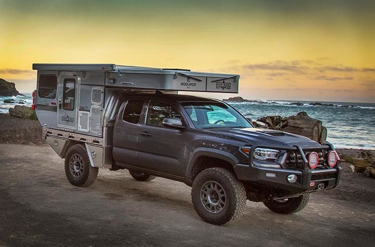

    Beautiful build. I see that you have the OME BP-51s with custom Deavers, which is exactly the setup I am considering for my 2020 DCLB OR. My main concern is the massive weight I'll be carrying (GVW will be near 7000 lbs fully loaded). How do these shocks and the Deaver leafs handle the weight? Do you find this setup equally comfortable on road and capable off road?

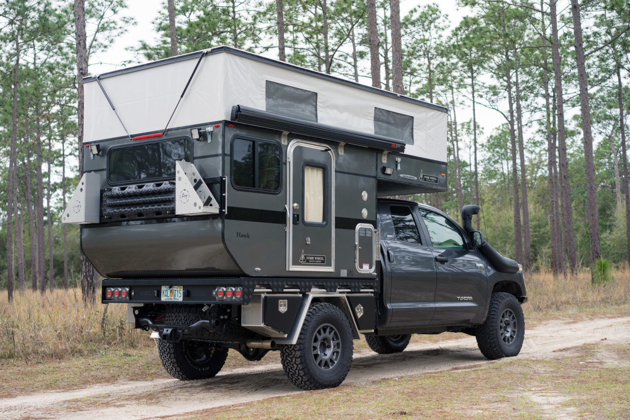

    That's the FWC Gray. The metallic matches MGM. (it was a request by bound for nowhere for their build as seen below).
    We have done many norweld tray/ FWC flatbed builds as we were the original importer of Norweld and had their first tray on a 3G tacoma in the states. This Tacoma is now residing with Travis Burke, but was owned by MLO owner, Matt Henwood:
    TacomaWoolrichFlatbed_Mendocino_760x500_copy_15fa9667-1ac2-472b-a03c-bb47e26026fc.jpg
    https://www.mainlineoverland.com/blogs/vehicle-builds/2016-toyota-tacoma-trd-sport
    We've done quite a few different suspension set ups from occasional use to full-time duty. So if you have questions about the particular application, feel free to reach out.

    The BP 51s Handled the weight just fine and it works really well both on road and off. Absolutely no complaints. We used them because we're planning International travel and parts/rebuild kits are readily available. Originally had Dobinson heavy-duty springs, they didn't cut it. But the custom Deavers springs are great. The handling of the truck is very competent with a rear anti-sway bar, it now corners quite flat. It is like riding in a 3/4 ton truck that has a load in it, the ride is firm yet compliant.
