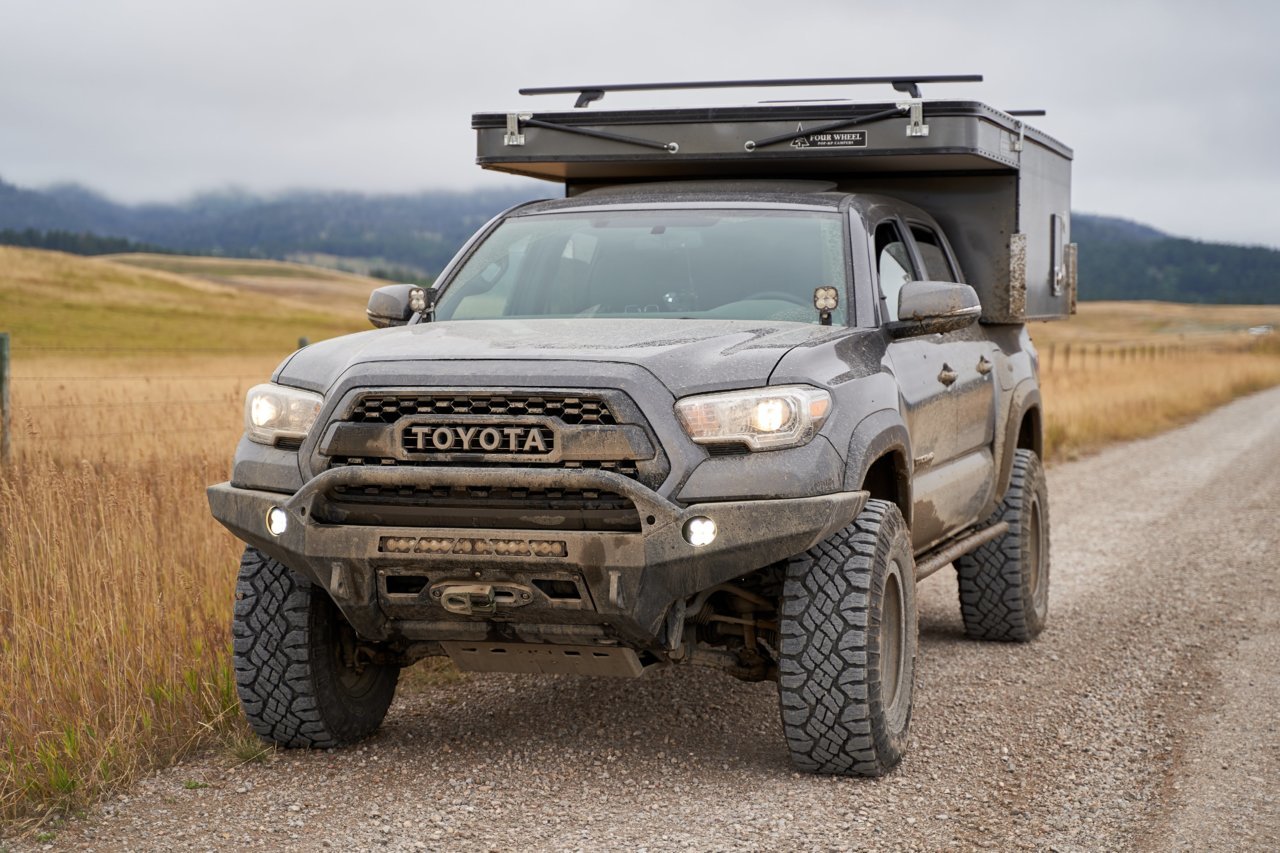

    Whichever truck you choose, the best way to dial in the suspension is to get things installed and then weigh the axles of the truck independently at truck scales. Then you can decide what suspension you need for front and back.
    Basic suspension for these trucks is: front coil springs hold the front weight, with shocks inside the coils to manage movement. Leaf springs in the rear hold rear weight, with rear shocks to manage movement. You can add airbags in the rear to add more support for higher weight carry and adjustability, but it comes at a cost of more things to manage and more things that can go wrong. May be good option for you though since you are removing all that weight when not in use.
    It's good to know how much weight you need to support though when figuring out springs and shocks.
    Tacoma will manage just fine if that's the size truck you want. There are lots of us with lots of miles on our Tacoma/FWC rigs (I'm living in mine in so cal right now!)
    But definitely make sure you pick the truck that will suit your needs and wants before building camper and suspension.
    Look forward to seeing where you land.

    It's a shell model that I've built out so pretty light on the weight compared to fully kitted campers. The dobinson 550kg rated leaf pack has been enough for my needs so far (I'd estimate it's around 1200lb fully loaded, I don't have a lot except tools and 20 gallons of water).
    I like to go fast on and off road, so suspension and power are a must. Would like to move to 5.29 gears at some point, but the manual gearing has been pretty good so far, just need to adjust expectations on highway inclines.
    I'll probably swap shocks to ADS that are custom valved for the weight at some point in the near future as the standard icons I have don't keep up even with compression adjustment. Any OEM replacement style shock kit just isn't valved right for that rear weight. Probably most people will be okay with it though.
    Biggest complaint is the slide in turn buckle setup, as they groan and clunk and need to be checked frequently for loosening when run hard on rough terrain.

    I have the same leaf pack, according to the dobinson spec sheet they're rated at 580kg constant load (1275lb), so you're waaaay over weight on them.

    you’re correct that spring capacity is 1,275lbs each. so the total capacity For both springs is 2,550 lbs which is less than what I’m carrying (camper is 1,400 lbs, flatbed is 250, and the misc gear is might be 300. The rest of the truck rests on the frame and front springs/axle. Still, they didn’t handle the weight

    my 2010 FWC Eagle shell's name plate says 530lbs. i have roughly 245lbs of solar panels/AGM battery/wiring/fridge/yakima bars to bring the base setup to around 775lbs. driver and passenger are under 350lbs which means i can still add 325lbs of gear as my 2013 ACLB 4X4 MT has a payload rating of 1450lbs. that 325lbs does get eaten up quickly especially when you add extra water/fuel etc but its doable.
    when i first bought the shell i planned to add a sink, water tank, stove, shower etc for convenience but never got around to it and after a couple years of use i realized i didn't want it and would rather stick with portable stuff and bring it or not depending on the trip. at times the options would have been nice but more often it wasnt necessary and i was glad i didn't have it on board to carry the weight and give up the space (the 6ft couch and a book is a game changer to wait out afternoon rain). i dont add permanent options for a 5% of the time need.
    the Tacoma makes its money as a small & capable package and i love mine but if i felt i needed a fully loaded FWC i would be looking at a bigger truck. others run more weight than i do and say its fine but i know how mine handles even with significant suspension upgrades on and off road and running it heavier would start to really limit where i could go.
    TL-DR - its totally possible to run a FWC on Tacoma and not be overweight but you gotta start with the most stripped down base setup and choose your gear wisely.

    I don't think that's how it works. You get a total payload weight rating, which is 1275lb total for the truck.
    See this spec sheet which shows quantity 2 payload 580kg.
    Edit: double checked with a dobinson guy, it's for the pair, so you've been running way over weight. No wonder they're sagged out! :eek:
