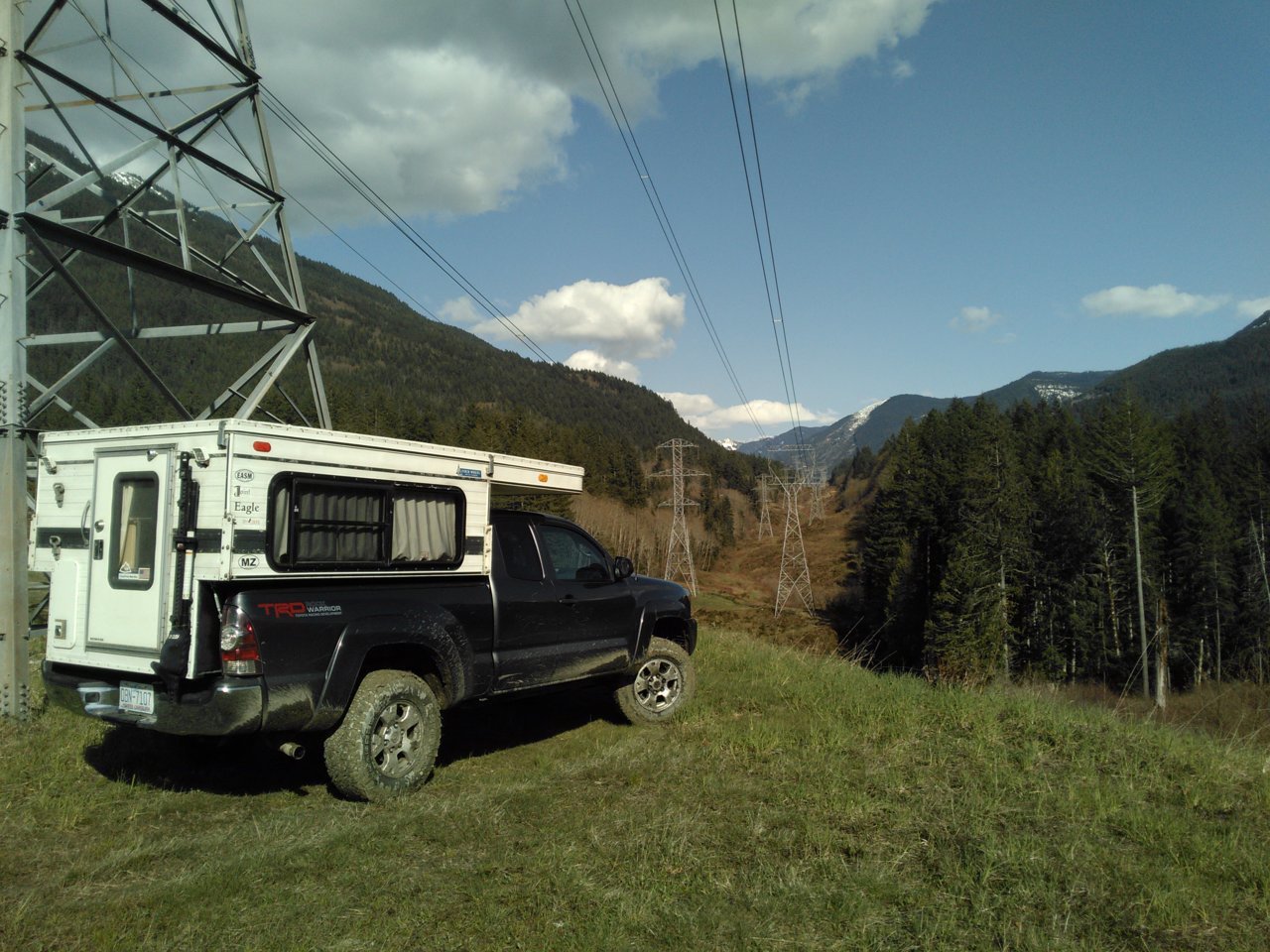

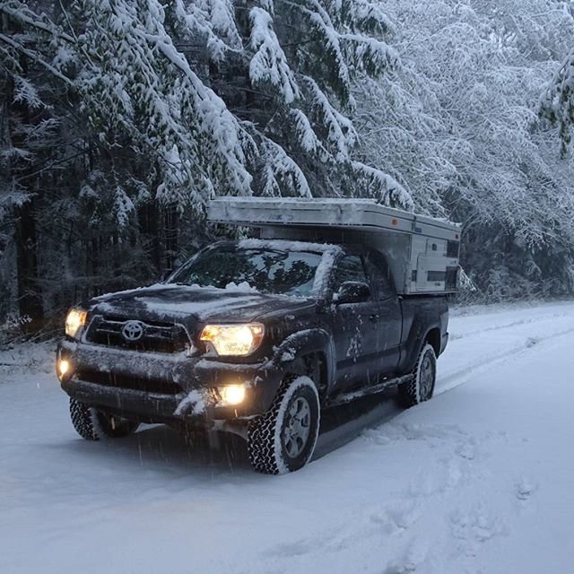

    This photo is not nearly as warm as my last.

    Love this truck!, I was scared away from the four wheel camper idea cause of my 2.7l, but it seems like yours doesn’t have a problem with it! Can I ask what tires/suspension you are running?

    what upgrades are needed on the suspension for something like this? Also how much does this kill the MPG?

    So I am running Fox 2.0 shocks with 600lb coil springs upfront, Old Man Emu Dakar HD Hilux Leaf Springs and Timbren SES bumpstop shackle flip kit outback. I also did EBC stage 4 rotor/pad upgrade with SS brake lines from Stoptech. As for tires General Grabber AT2 load range E stock size just LT version.
    Under the hood the "performance" mod has been charcoal filter delete and K/N filters everywhere.
    I highly recommend the manual transmission with the 4cyl as it really helps with power deliver and fuel economy, which I average during the winter 17-20 and summer 20-22.

    For reference.

    How much did your guys suspension upgrades all cost, in total?

    I bought a combination of used and new parts --> some discounted, total around $1,100.
