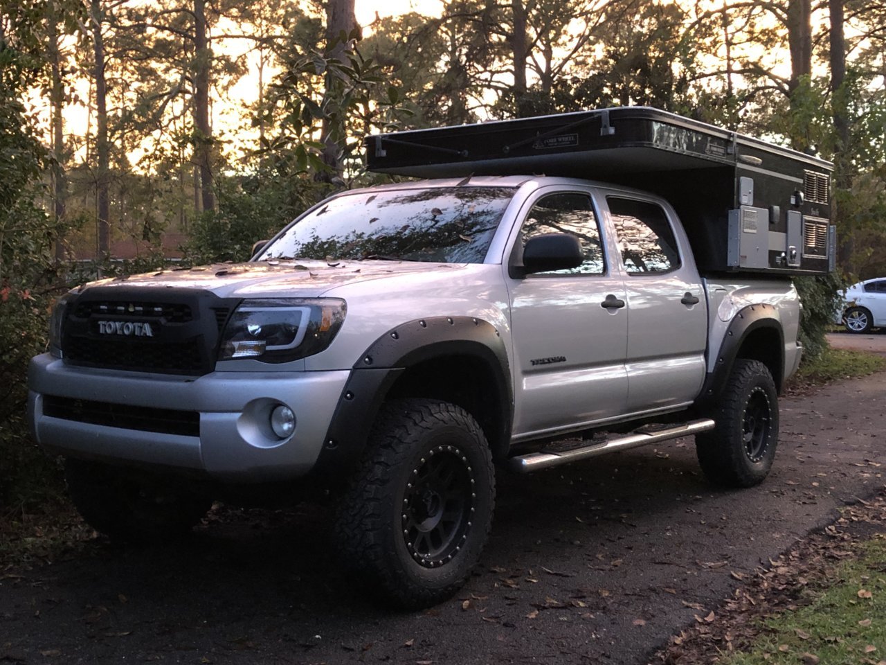

    So, I have taken it off, and since the rear drain was hitting the tailgate, I bought a snailarmor aluminum rear plate and now there is no interference with the drain and the tailgate fully closed. The FWC tacoma plates are super beefy and rock solid, the newer ones include the side to side supports. Bomber! I installed the electrical, the Marinco plug was on the Finch, so I left it and got a Marinco receptacle, unfortunately after getting an Atwood at FWC, live and learn. I like that the Marinco is waterproof, and has a cap. Put on some Sumosprings, the black 1400 lbs and it rides super. Love the low maintenance, and price! $245 from their Amazon store, amazing difference. Leafs are OME HD. Bilstein 5100.
    The first picture is before the sumo springs. It is at least an inch lower without the sumo. Nice thing about sumos too is that you can take them off in 5 mins. I am going to see if they have a super small one to put on when I want to go without the spring. You can see here the atwood is not waterproof.
