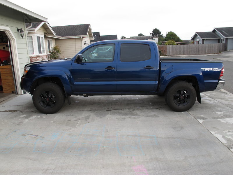

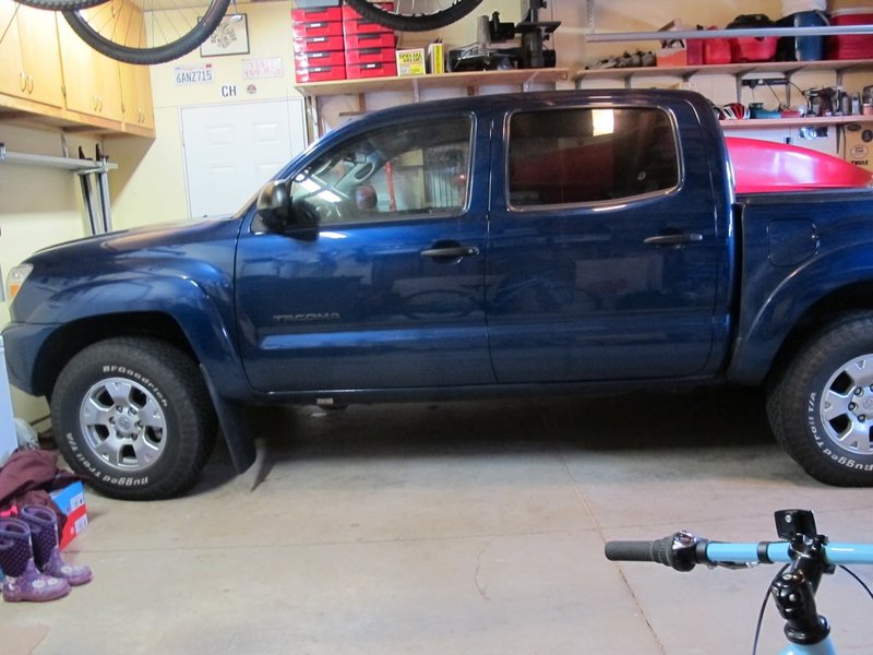

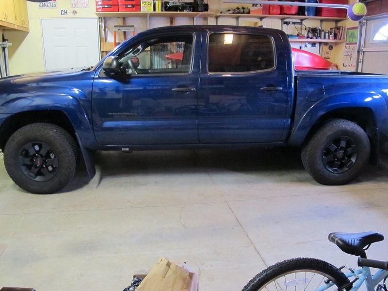

    I changed the stock TRD Offroad suspension to 5100s all around and OME 883 coils in the front.
    It lifted the front by 1 3/8 inch and is now just about level (1/4 inch lower in front).
    I haven't tried it out much, but so far seems more comfortable (less back and forth) on bumpy roads.
    Before:
    After:

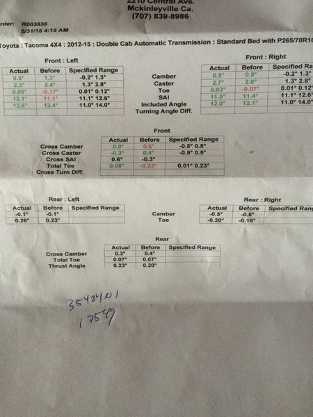

    Alignment

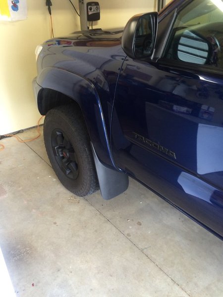

    Front Mudflap Trim by 2.5 inches.

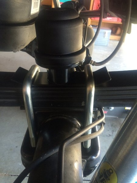

    Installed OME TP04 5mm spacer under driver's side leaf spring.
    Installs like an add-a-leaf. (Used chris4x4's instructions "AAL Install. second gen")
    Longer centering pin needed. Corrects for driver's side lean in rear.
    New U-bolts.

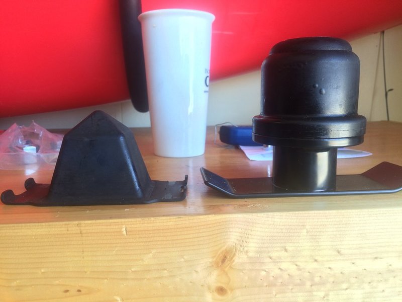

    Installed Wheeler's Super Bumps in the rear. They are 2 inches taller than stock.

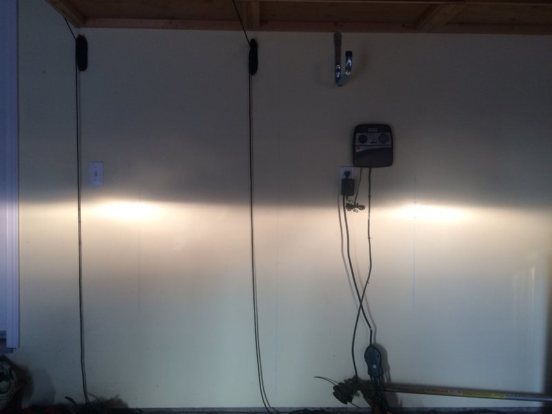

    Still have to adjust the headlights.

    Adjusted Headlights down.

    Added 1/4 inch spacer to Wheeler's superbump passenger side.

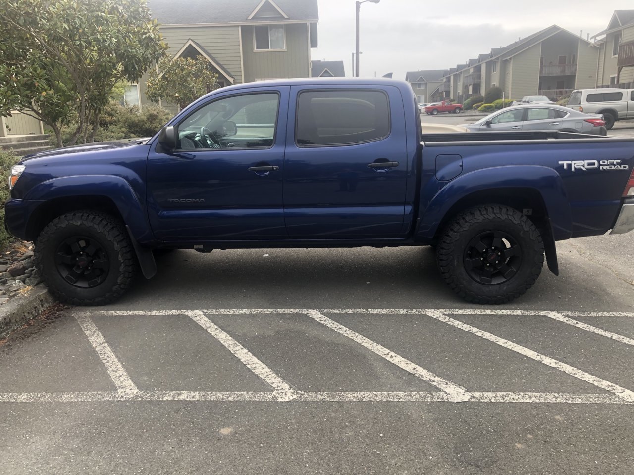

    BFG All-Terrain T/A KO2 DT RWL LT265/75R16/E
    Tire pressure recommended by Tire Center: 35psi

  8. Jul 11, 2019 at 2:28 PM
    gusmung1011
    gusmung1011 Member
    May 27, 2019
    #294567
    9
    Gus
    Downey, Ca.
    2015 Siver DC TRD
    DV8 Rear Bumper with Led Bumper Lights Lasfit Led interior lights, 3rd brake light, reverse light
    great looking truck, what kind of wheels are those?
  9. Jul 11, 2019 at 3:02 PM
    fourpointTRD
    fourpointTRD [OP] Well-Known Member
    Mar 22, 2014
    #125886
    152
    Humboldt, CA
    14 DCSB TRD OR 4WD
    Bilstein 5100s x4, OME 883 with 1/4 inch spacer on driver's side, OME TP04 leaf spring trim packer, Wheeler's Superbumps rear, black FJ Trail team wheels, Gorilla Wheel Locks (73631T), Huskyliners xact contour, Rockymounts Clutch SD and Driveshaft, Toyota OEM Bedmat, Plasti-dipped badges and front emblem
    FJ Trail Teams

  10. Jul 11, 2019 at 4:15 PM
    gusmung1011
    gusmung1011 Member
    May 27, 2019
    #294567
    9
    Gus
    Downey, Ca.
    2015 Siver DC TRD
    thank you fourpointTRD
  11. Jul 12, 2019 at 5:13 AM
    Wattapunk
    Wattapunk Stay lifted my friends !
    Jan 26, 2010
    #30098
    4,075
    Uncle K
    TX
    2005 DCLB 4WD
    Nice. Maybe do a chalk test but personally I think 35psi may be a tad high. I like to run mine around 30psi and it's much smoother with even wear on 285s
  12. Jul 12, 2019 at 12:43 PM
    fourpointTRD
    Mar 22, 2014
    #125886
    152
    Humboldt, CA
    14 DCSB TRD OR 4WD
    So far so good, but chalk test would be a good idea! Thanks!
