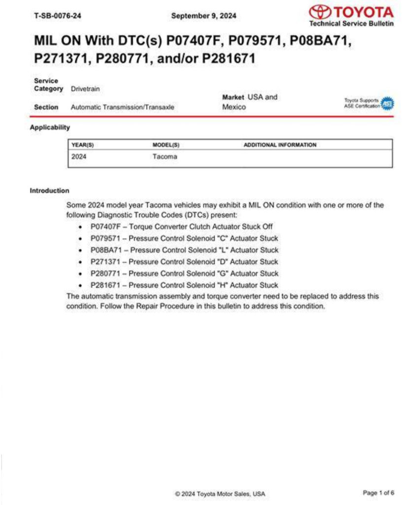

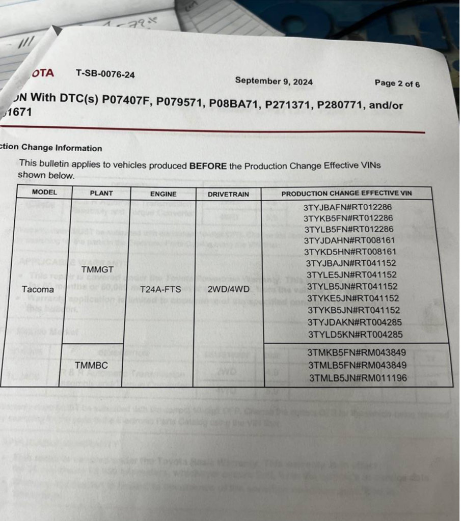

    IMG_5107.jpg Is this old news? Posting in case it helps anyone. Looks like transmission issue identified and fixed as to certain vinsIMG_5108.jpg

    Yeah actually, have to keep up on the failures so I can make a decision. The new TSB on the trans pretty much was the final nail in the coffin. Saw that one coming while many denied it.
