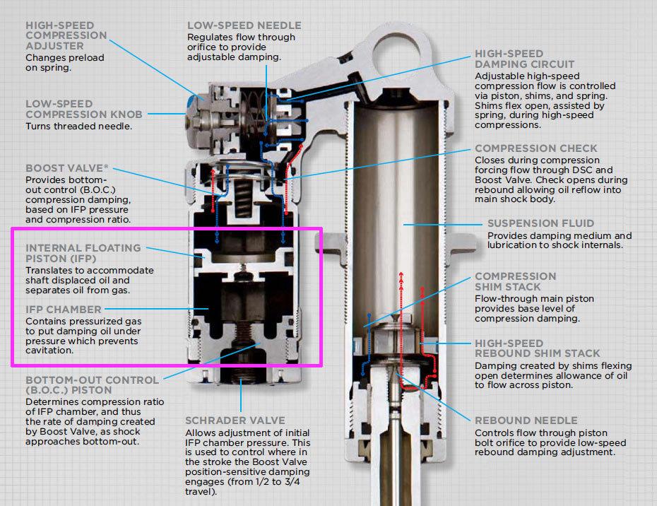

    Just in case you ever wondered what the inside of your shock looks like
    Hope you enjoy them. I love my fox setup. Tons of fun.

    Nice, thanks for the diagram, love it! Yep, I have the 2.0 up front to level and then the 117s in back (obviously not adjustable lol). Thanks again!
    m603holden[QUOTED] likes this.

    It's been figured out. He doesn't have the adjustable shock
