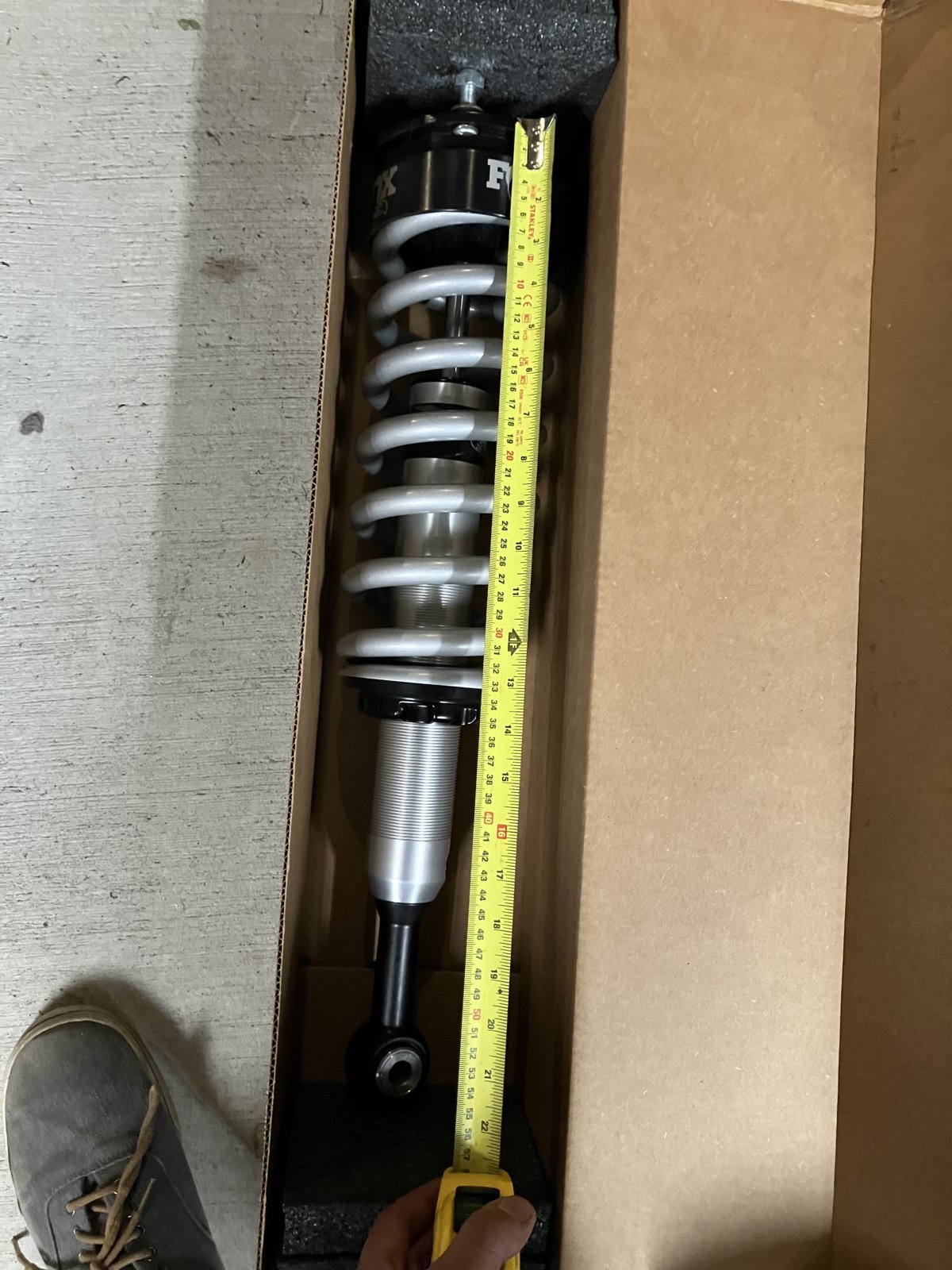

    I just purchased some Fox 2.0 Coilovers for a wicked deal.

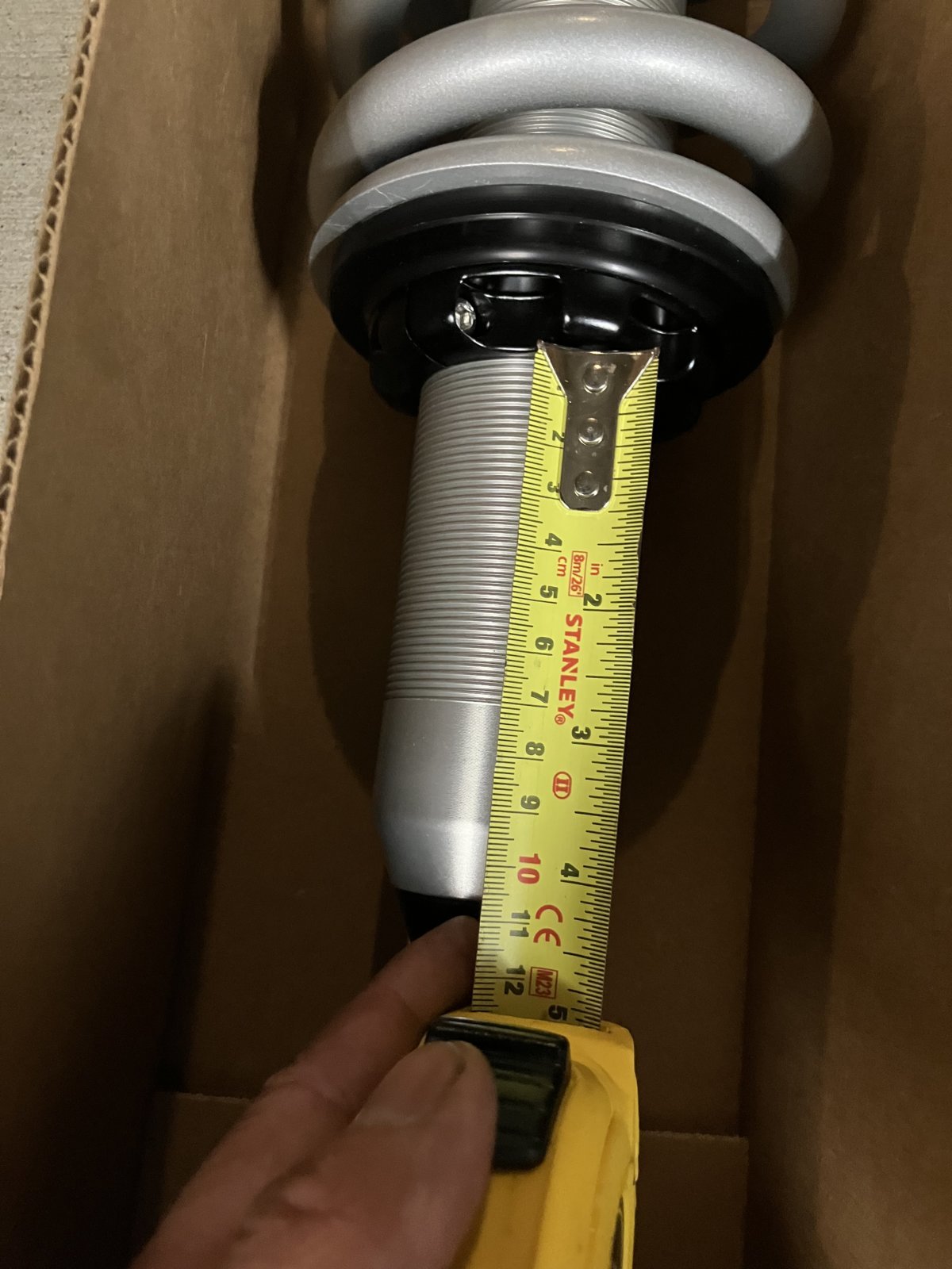

    Right out of the box it comes set at 7cm (2 3/8in)
    I’m going to be renting a spring compressor to adjust the collar by hand.
    I have a few questions.

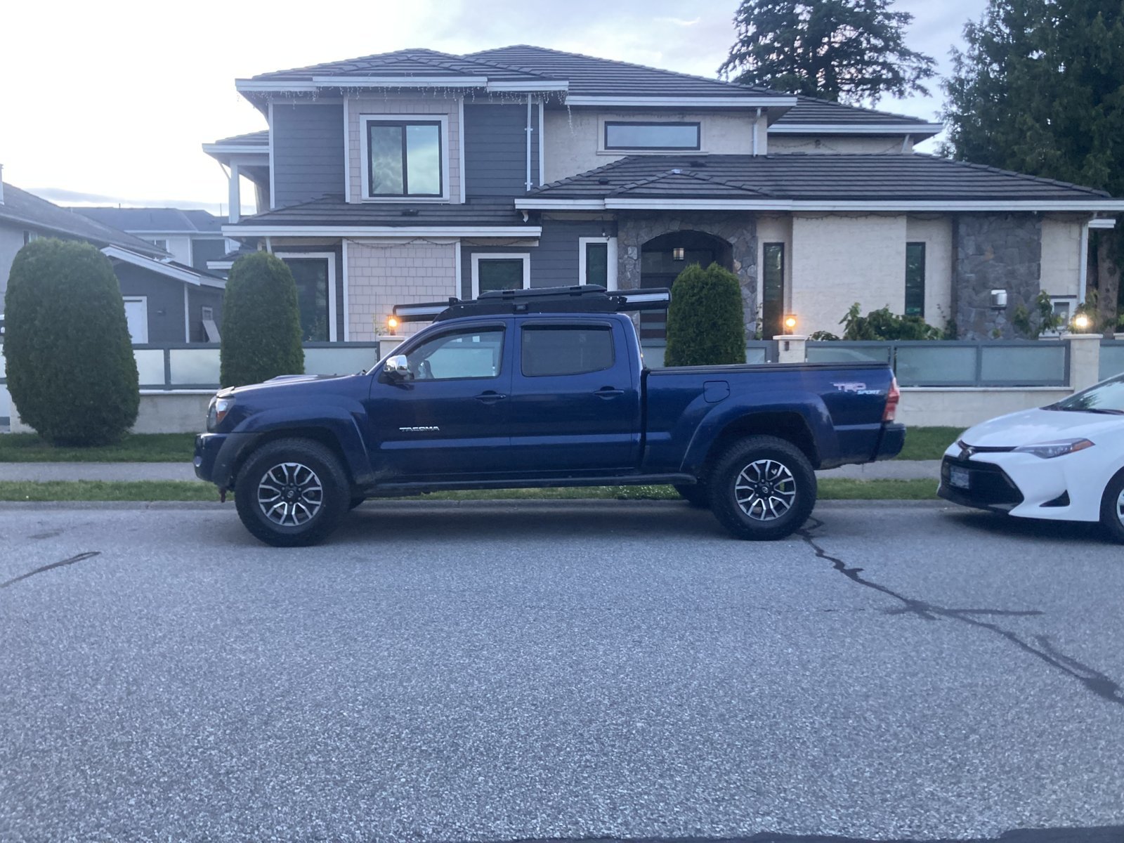

    I’m at 20in today with my old shocks. Before I added the slider I had 21 1/2in.

    I don't know the number of turns offhand, but the lift adjustment amount will always be a 2:1 ratio.
    So if you want to adjust your height by 1", adjust the collar up or down 0.5".
    For 1½", it'll be 0.75" of adjustment, and so on.
    The rest will have to be by trial-&-error unless you can find someone else who has your exact same setup.

    If they've never been installed, throw them on a few weeks to cycle them and let them settle. You can adjust them on the truck if you jack the front end and use compressors to ease the tension on the landings.
    Get your baseline and adjust from there. You'll likely end up with 1/8" to 1/4" more thread on the driver side to compensate for the Taco lean. Take your measurements from the center of the hub to the fender to take tire compression out of the measurements.
