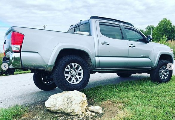

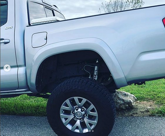

    I just installed these pro shocks on the rear of my truck. The back clearly lifted. The rack is more pronounced now. My old stock shocks only had 25k.
  18. Oct 16, 2018 at 10:15 PM
    #18
    bzzr2
    bzzr2 [OP] Well-Known Member
    Jan 26, 2011
    #49986
    2,060
    Def looks right the way it is sitting! Ppl usually take the measurement from the centre of the hub to the fender, i always found that left a bit of room for error and like the idea of taking it from the edge of the rim also. Are your rims 16's or 17's? What size of tire - 265 or 285? That might have an impact also sue to the measuring tape having to contour around the wider tire when measuring from the rim. I plan to run the wild peak at3 in mellow little 265's on the stock TRD 16's to keep my mileage nice, just waiting on their arrival. which length fox rears are those? 2-3 inch or 3.5-5 inch they look nice and long. Thanks!!
