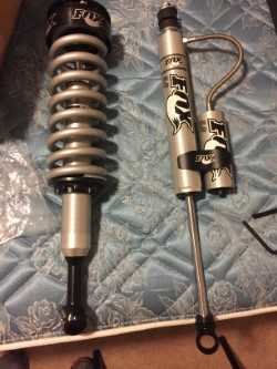

    Made the most of Wheelers' Black Friday deal. Got the 2.0s front and back with resi in the rear, 3 leaf aal. Happy I was able to get the front superbumps for free so bought the rear superbumps and single roost guard too. Beyond hyped, supposed to get here next Monday. None of y'all had spacing problems running stock TRD wheels right? I'll eventually be getting some 16" VTX Terra's with 265/75/16 falkens. Student loans just started up this month so this is definitely gunna be it for a little hahaha

    AWESOME. You should be stoked, your suspension will be done. No clearance issues with TRD wheels. Grease the leaves with marine grease when you rebuild them and you won't get squeaks.

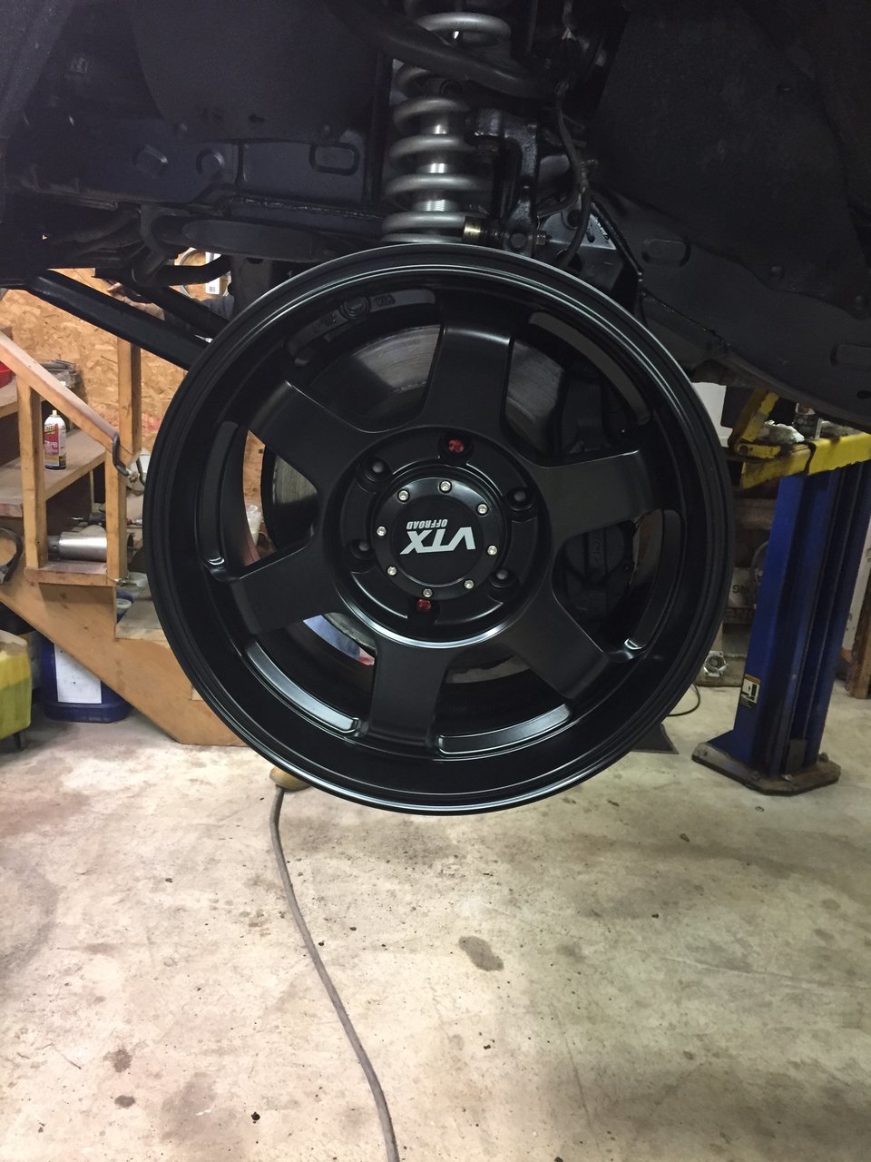

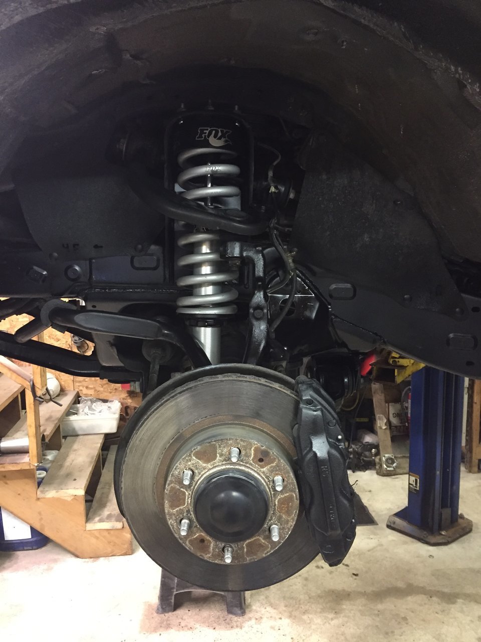

    Finally got the full kit installed yesterday, phone died before we finished the front end so these are the only pics I have for now. I think the future father-in-law has some from the back end. Tested the fit of the new VTX Terras, gunna get some Falken Wild Peak 265/75's and be done for a little while. @Chaz84 I'm pretty sure my install was the complete opposite of yours...rear got finished with little to no issues whatsoever, front took about 3-4 hours to do...let's just say thank god the father in law knows a guy with a full garage and a rotary lift, there may have been a guest appearance by the acetylene torch and a grinder or two. Rear was a piece of cake...shocks removed, broke leaf pack apart, scraped everything down with a wire brush, cleaned, primed and painted frame, greased leafs, had to remove one of the rear retention shackles on the stock leaf pack to make room for the 3 leaf aal, and notch out a small portion of the shock bucket to make room for the resi hose, other than that the rear was a breeze, took maybe 2 hours simply cuz we cleaned up some rust.
    The fiance and I were supposed to meet with her friends on the way back up north last night around 4...we didn't finish the truck til 5, go to her friends in Merrimack around 7...oops. Took some sweet talking but she didn't cut my nuts off. Getting the front end aligned either today or tomorrow...didn't have time to get in yesterday. Agree with everyone so far about overall ride, even the wifey noticed how much better it handled the shitty-always-under-construction-highways of Massachusetts on our way back to NH and overall ride in general feels smoother and more consistent, not as stiff as stock but definitely not too soft. Cant wait to bounce her around and test out the superbumps. Will get a few pics in over the next couple days of how shes sitting and maybe get some cliche AF snowy mountain side of the road pics this weekend.
    Side note....didn't realize the dealer probably only did a pad slap before I bought her in august...pads are fine, rotors though....once the snow is gone they're getting chucked in the dumpster.
