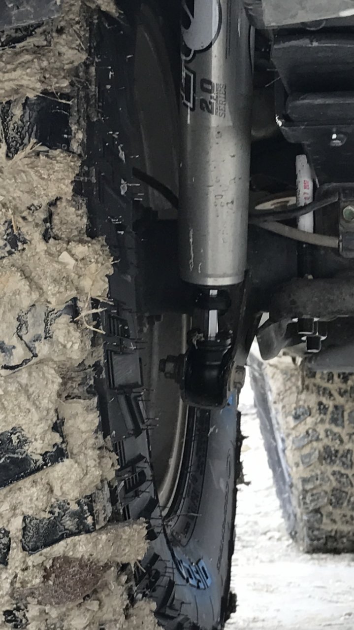

    **Question** By manually compressing to full compression, w/your hands or whatever:
    On the Fox rear 2.0 resi's does the shock compress completely to the bottom mount?
    Or do they bottom out internally before the shock body hits the lower mount?

  14. Feb 19, 2018 at 10:47 AM
    #214
    Chaz84
    Chaz84 [OP] Well-Known Member
    Feb 14, 2014
    #123079
    192
    Dr. Chase
    GA
    09 blk Tacoma TRD OR 4x4
    FOX 2.0 coil-overs, rear 2.0 RR's CD adj & roost shield, Wheeler's Off Road progressive 1.5" AAl's & Super bumps front & rear, 1' angled block, airlift bags w/ in-cab control & under hood compressor, trailer brake controller, Warn 1st gen M8000, U.S. Off Road hidden winch mount, Body Armor rear bumper, Trail Gear sliders (all Bullet-lined & welded), Sony touch screen dvd, JL Audio Stealthbox, 500/1 amp, Helix tbs, URD intake w/shield, 4 D-rings, in-cab wEnch controls (pics), door sill guards, weather tech mats, black-out headlights, LED cab/backup/bed/ trail/tag lights w/ hidden in-cab switches, PIAA yellow xenon fogs and PIAA extreme white plus headlights, AVS bug & vent visors, red Devil Horns, Undercover tonneau cover, two 30ft straps, tree saver, snatch block, tire plug kit,125psi compressor w/ 1.5 gal tank, 4 5k lb tie-downs, Mag light Pro w/glass breaker seat mounted (drvr&pass), diff breather mod (behind driver tail light), anytime locker mod, Mobil 1 diff oil, Mobil 1 extended performance oil and filter, 840 amp Energizer battery, 285/70/17 XD's, Nittos, 2x2 Cali Raised hyper spot ditch-light pods. CMC
    They have an internal bumpstop that stops it; however, the actual truck bumps will stop the compression so nothing to worry about.

    At what point will the truck stop the compression? I totally forgot to look @ my bumpstop situation while I was flexed like this. I got mine this close & had more flex left!

    I have Dakar rear leaf pack w/ Fox shocks part #985-24-118.

    Geeze man, I suppose you should gently totally flex her out in a ditch and see if it contacts. The Dakar packs are designed to flex more so this one is kinda on you bc I just have the progressive aal's. I'll try to look at mine today and see if I've made any contact. It does look close w your pic. Mully, calling Mully.

    My rear shocks are different, I have a piggy back resi and air bags. I can say that I have never fully compressed the rears. I don't think he has anything to worry about. Just wheel it. Good luck.
