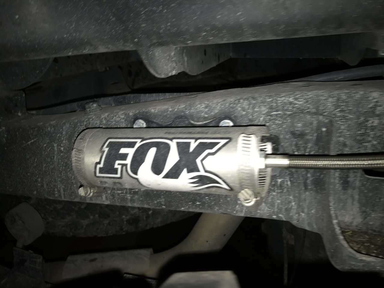

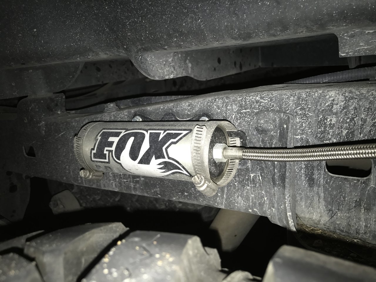

    I used the Fox kit and it is too damn wide! It just baaaaarely holds the resi's. Pics in my build thread.

    Here's a pic showing how they Fox mount is too wide. Resi is 6" wide, measurement to outboard side of straps is 6.5". It's like this on both ends. IMG_1170.jpgIMG_1171.jpg

    So from what I understand from my research before installing my suspension was that the inverted rear shocks were actually FJ rears that an off-road company (maybe headstrong?) modified for the Tacoma... And they don't sell them anymore. I could be wrong, but that's what I remember.
    Also, I would call Fox about those frame mounts. Their customer service is pretty dang good. They might have other options for you. Better to check than have one of those come out off road. Honestly, I might slide the resi back and just use the rear of the mount with the retaining ring towards the middle of the resi. Likely more secure.

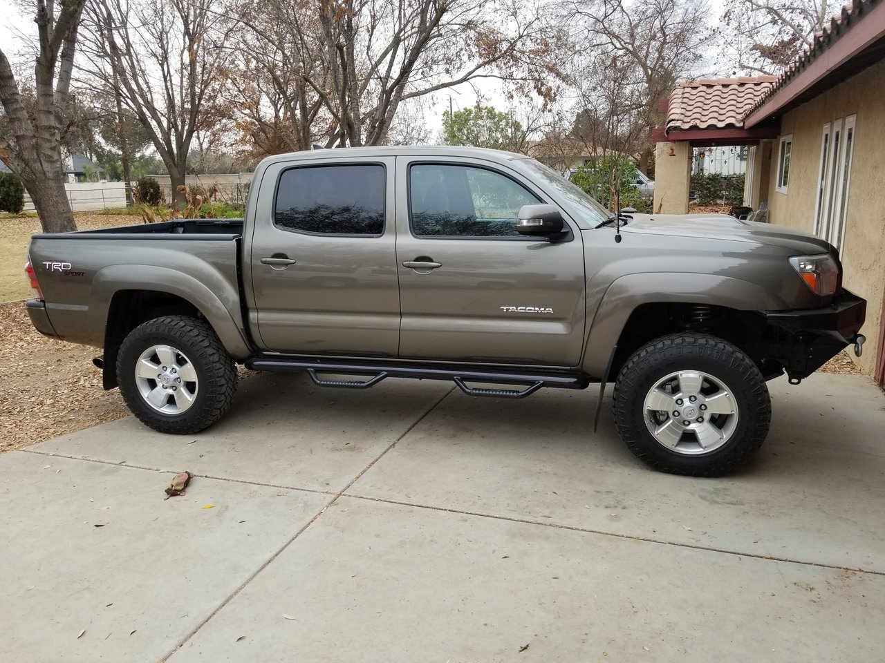

    Mully how many cranks did you do to get 3" of lift? looks good

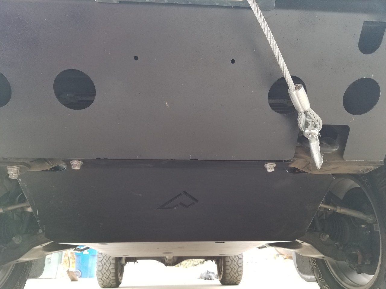

    About an Inch, but I also had a steel TC skid. See pic, you can see where the collars used to be. I also have the old double collar adjusters.
