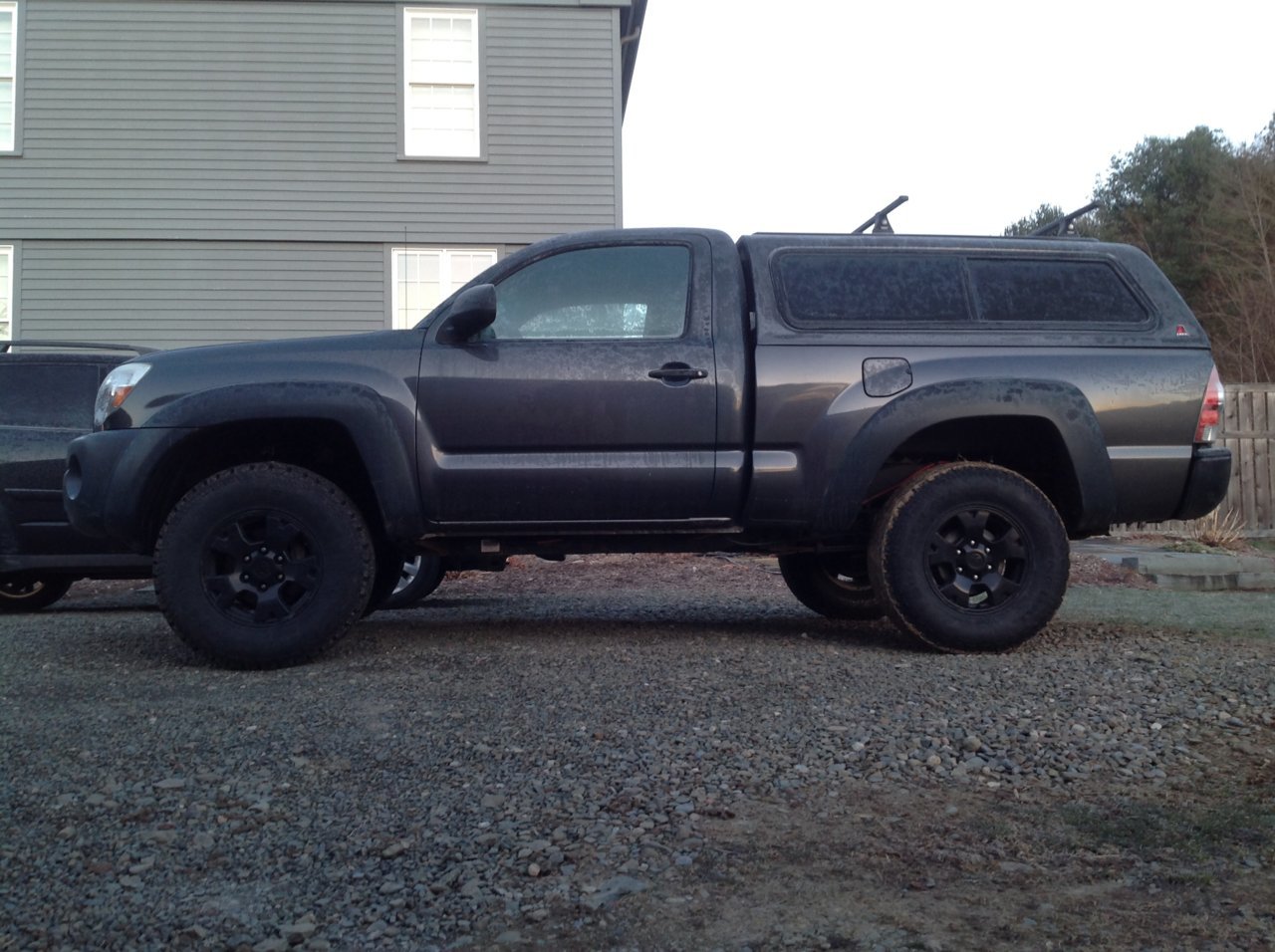

    So, I couldn't get the rear shocks off myself due to time and equipment constraints. (The top nut was rusted onto the shaft badly). I ended up having my friend deal with everything at the garage he works at. 3 turns down on the driver's side front and 6 turns down on the passenger's side front yielded 22" and a maybe an eighth or so on both sides hub to fender. Effectively 1" passenger, 1&1/2" driver. Cam bolts ares seized into the bushings, so alignment numbers are not awesome but not far from what they were prior to install. It drives fine, so I'll put the parts on my wishlist for down the road. Camber was relatively unaffected, which is good. Buy a used truck in the northeast, things will be rusty. It was cheaper than a new side by side, and still is, so it makes a great firewood hauler and third vehicle.

    Passenger shot, no more stink bug. It looks more lifted in person. Passenger reservoir is facing the front (the hoses weren't very long). My friend just trimmed the roost shield down, no biggie. The ride is much better now. Much more controlled and plush at the same time.

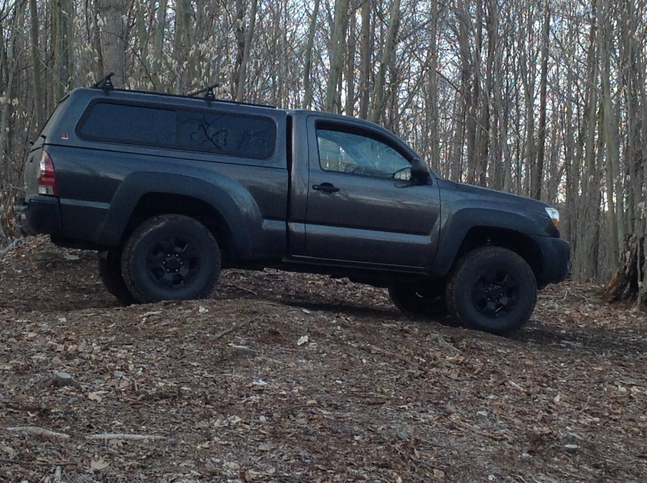

    A side shot from this morning (22 degrees F) . Frost on the truck. This highlights the stance a little better. No mudflaps, as they would just get ripped off in the woods.

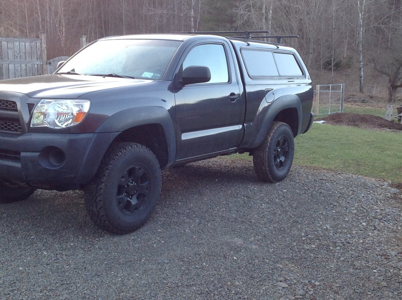

    Last vanity shot from in the woods tonight. Hardly a level trail up there. Always dropping a tire or going over something. Again, thanks to all who posted in this thread. I am so glad I was able to get a predictable lift from these coils.

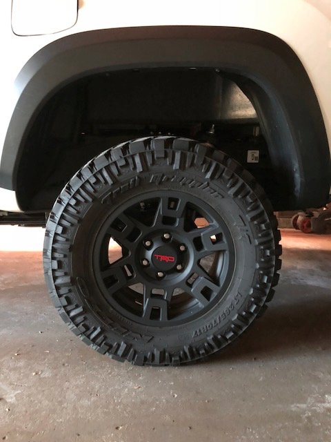

    Installed the 2.0 front and rear with Dakar medium Leaf Pack. Will get better pics tomorrow. Rides great.

    Looks great. Hope to hear a more detailed feedback/comparison on the Fox kit vs your stock OR suspension.

    I know right. LOL. I am very happy with it so far. I will report more in detail after I get some miles on it. So far though. It is very nice.

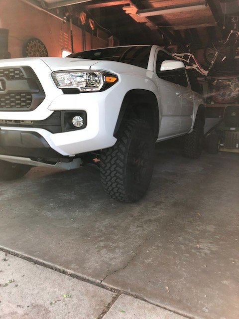

    So it has been a few weeks since I installed the Fox 2.0 front and rears with the medium duty Dakar leaf pack. I did have some front end settling (which I expected). I ended up going up another 6.5 turns on the drivers side and 6 turns on the passenger side. The ride from the initial instal was IMO, a better overall ride compared to the stock Off-Road suspension. Definitely handles the crappy Northern Illinois roads far better with the Fox Suspension. I also added some Spidertrax 1.25" wheel spacers.

    looks great so you have how much lift out of them up front? did you use a spring compressor to adjust?

    Thanks. I think that I have about 2" of lift up front. Yes, used a spring compressor to adjust, and then re-aligned. I thought that I have read that there a few folks on here that have adjusted while still on truck. @Mully may have adjusted on truck; not sure though.
