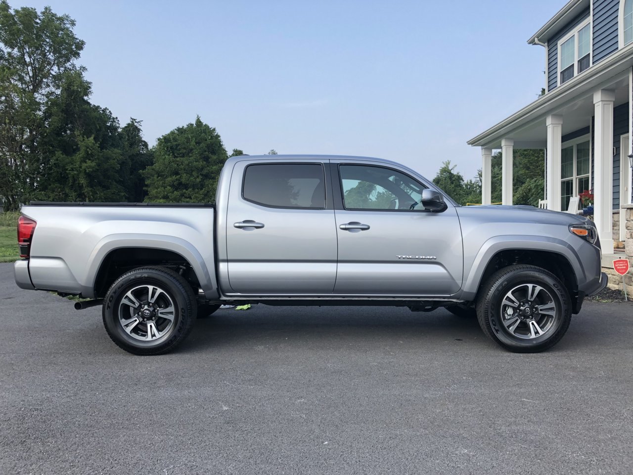

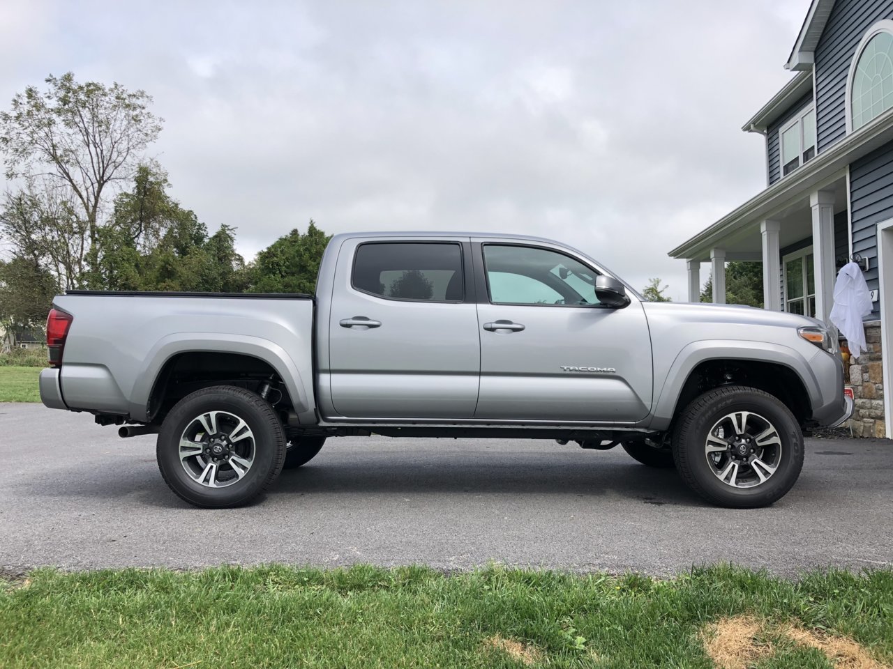

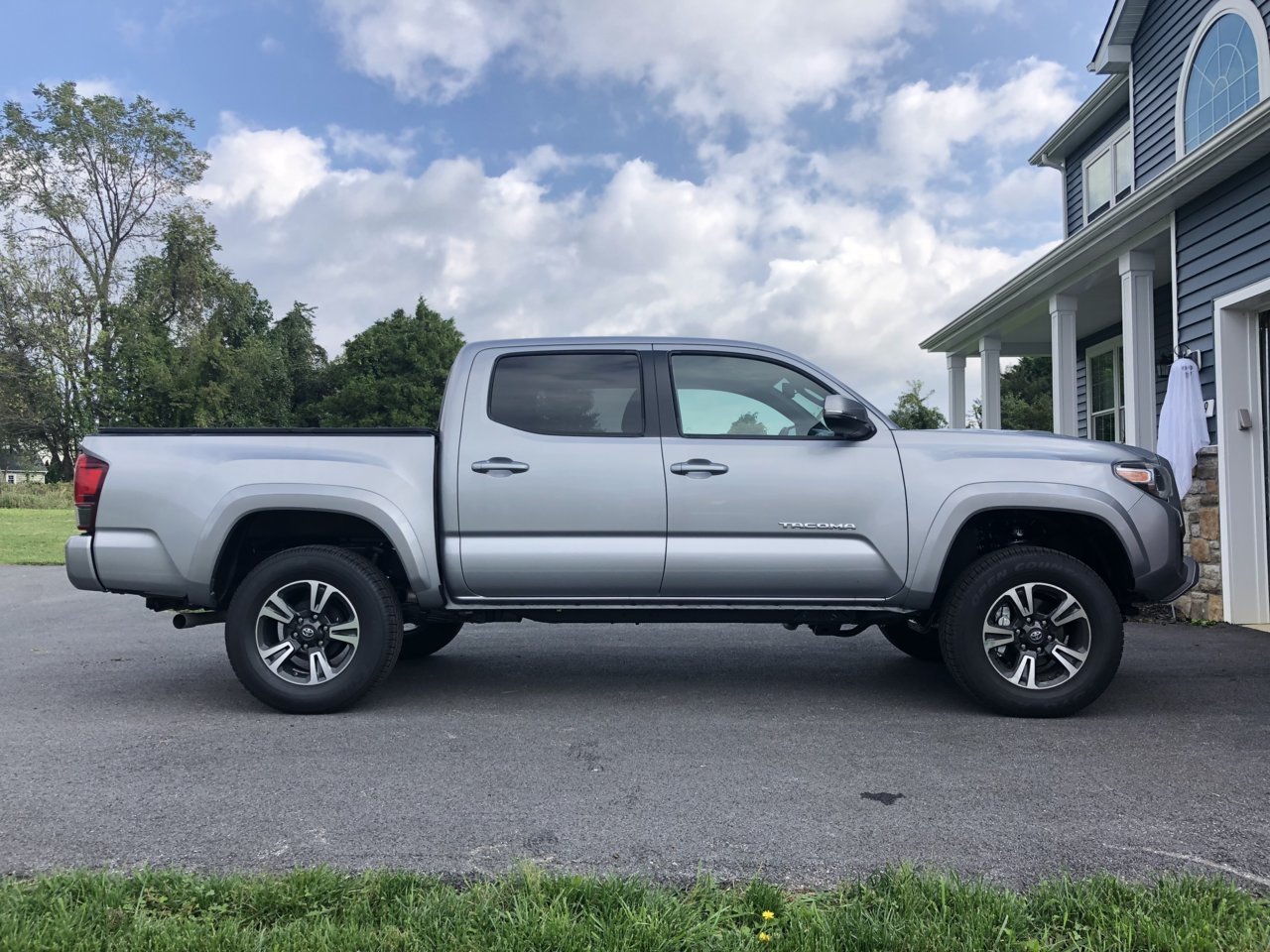

    Finally got my setup put in this morning. Went with the Fox 2.0 coilovers in front, and Fox 2.0 shocks with reservoir in back, along with a Headstrong AAL in the rear (factory overload is still in the leaf pack).
    First pic is stock.
    Second pic is with front coil overs in.
    Third pic is with front coil overs in and rear Headstrong AAL and rear shocks installed. Good progression.
    Need to adjust the front coils to get a bit more close to level, but overall the ride is great. Wheels come this week, so, will get the alignment when the new wheels and tires go on and post some updates. I think once I adjust the fronts up, I will net about 2” front and rear.

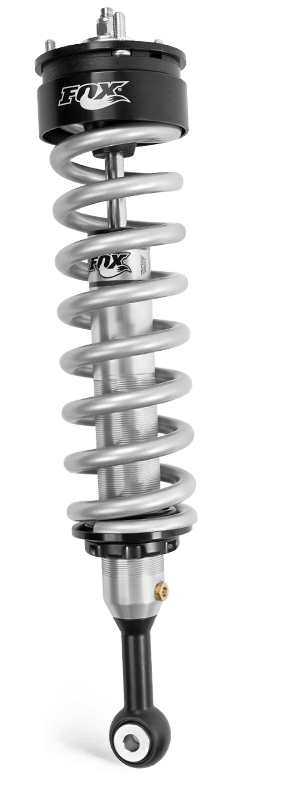

  16. Oct 8, 2018 at 3:23 PM
    #336
    Mully
    Mully Well-Known Member
    Feb 12, 2014
    #122907
    5,256
    CA
    12 DC 4x4 Lifted Sport
    Lifted, Kings, Locked, 295s and more.
    This is exactly what I have been saying for years. Adjust them on the truck with the wheels in full droop. Never had a problem either.
  17. Oct 8, 2018 at 3:28 PM
    #337
    Mully
    Feb 12, 2014
    #122907
    5,256
    CA
    Post a pic of the new 2.0s please.
  18. Oct 8, 2018 at 3:36 PM
    #338
    mattylmbr
    mattylmbr Well-Known Member
    Aug 27, 2018
    #264326
    114
    2018 Tacoma TRD Sport
    Here ya go. Collar is totally different than the one MolonLabeTaco is referencing.
