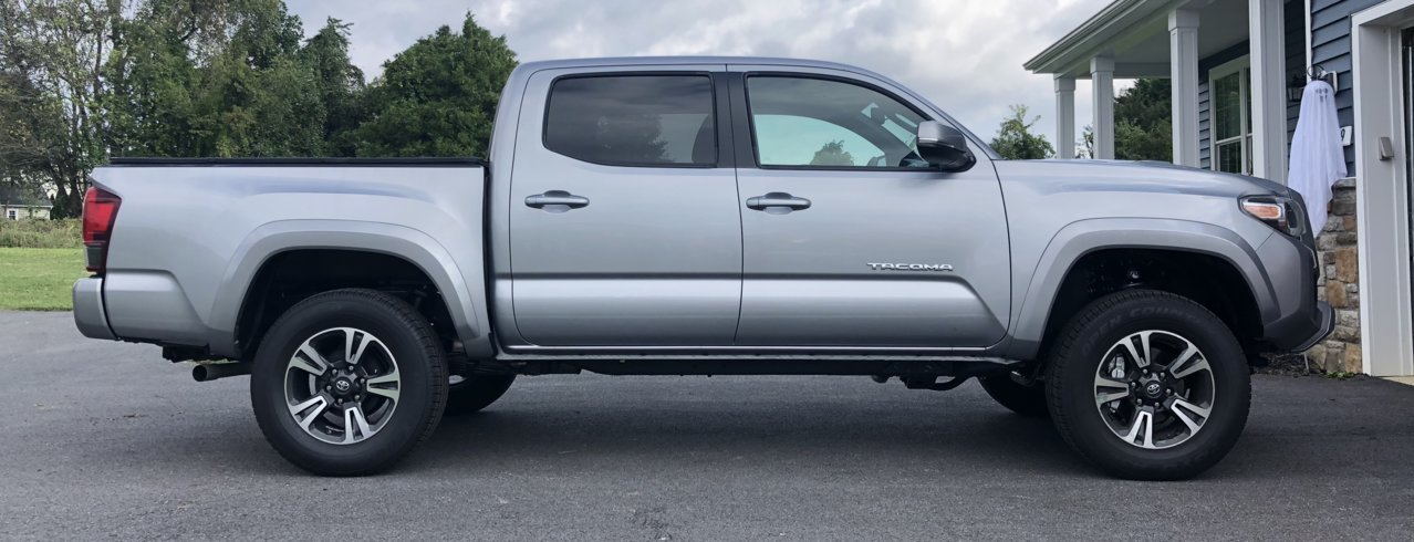

    Got the fronts off and adjusted them in a hydraulic press - both sides done in an hour flat total.

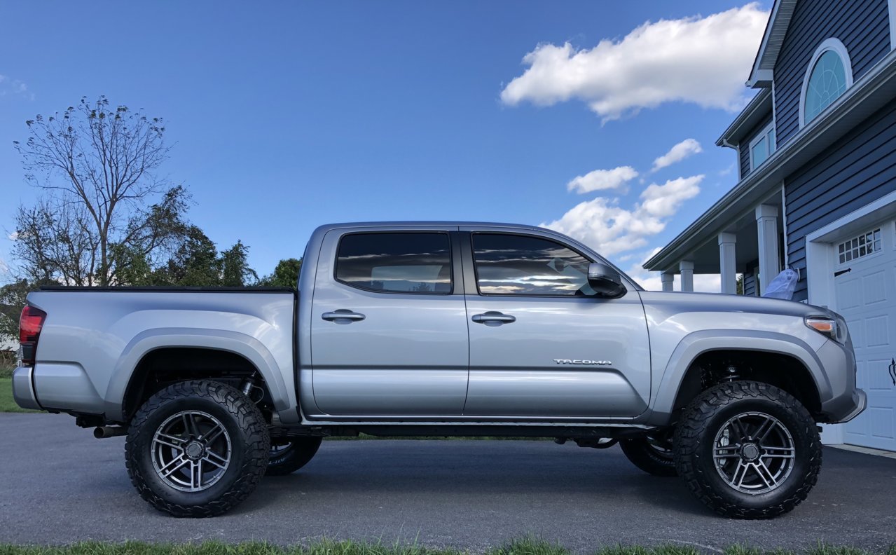

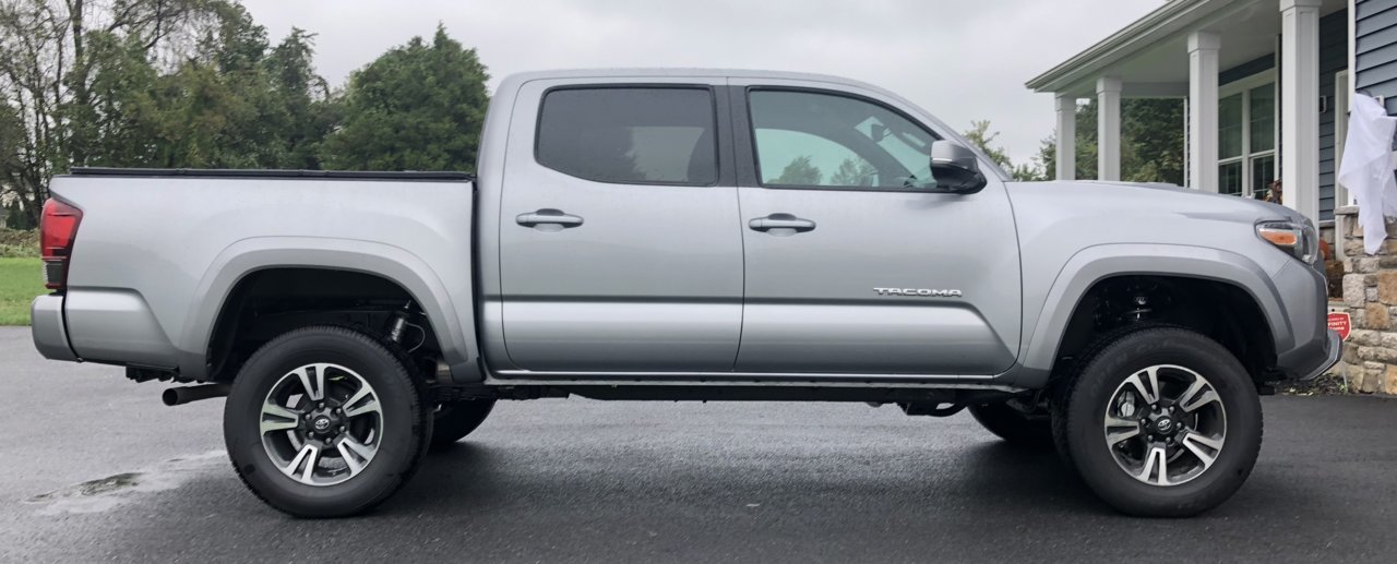

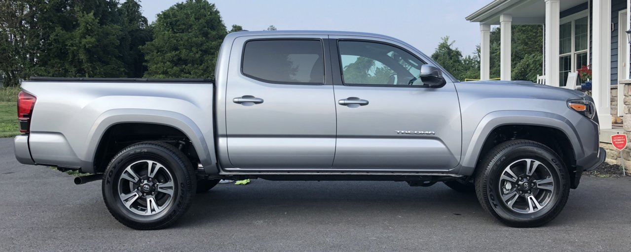

    So - here she is leveled/raked how I wanted - went up 6 turns on passenger side and 9 on drivers - I’m within 1/8” left to righ in the front and dead level in the rear. Pretty happy overall - and - alignment this Wednesday and new wheels and tires that day as well.
    Below in order is:
    - stock
    - fronts on
    - fronts on (not adjusted) and rear shocks and AAL on
    - fronts on and adjusted up 6 pass and 9 drivers, along w rears and AAL in
    Good progression shots.
    50C7F97F-442F-4E0B-845D-791BEAD2C6CD.jpg A25F421B-7A8D-4A3A-B500-AFBC189CCC74.jpg 83A87342-9D33-446C-99BA-830C5BC9FD8C.jpg 0B9139EB-FDDC-42C3-AFC3-6F8945E31264.jpg

    Wheels and tires went on today to round out the build. Cap is next - but - need to recover from the expense of the suspension and wheels/tires for a minute.

    Fox2.0 front and rear. Timbren bump stops, Timbren U-bolt flip kit, Low Range 7/8" rear block,275/70 x17 Kuhmo AT51 tires on Charcoal FJ 8 hole wheels, vent-visors , Alum. skid plates, Total chaos bed stiffeners, n-fab led lightbar bumper, 30" LED light, rollup tonneau cover, bed mat, weather tech floor mats, aftermarket trd emblems.
    Don't see why you couldn't adjust on truck as long as you compress spring till pressure is of the seats.
    If the spring compressor will fit in there?
    Let us know if you do it.
    I'm thinking of doing it for some fine tuning.

    I took them off to adjust them before they were aligned. Wasnt enough room to get a compressor in there - and - even off - the compressor I have didn’t work well with the thick springs and tighter coils. I used a hydraulic press - worked like a charm. Had both offf, adjusted, and back on in less than an hour.
    The ride of the truck is 100% better than stock and the stance is great!

    @mattylmbr Damn truck looks awesome! Been following the thread for a while now, nice to see your progression. Just wanted to see how much lift you got after settling and all that. 2" all around? Also are those 285's you got on now?
    mattylmbr likes this.

    I netted 2” all the way around after adjustments and settling.
    The tires are 275/70 17 KO2’s
    And - thanks!

    I got a hair over 1” out of the box on my 3rd gen and adjusted to 2”.
    Went up 6 on passenger side and 9 on drivers.
