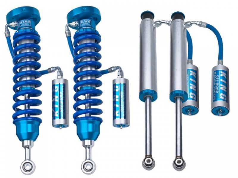

    Nice, I've been thinking of replacing my 2.0s and going with a 2.5 long travel coil with a 650 or 700 pound spring for the bumper + winch setup I'm planning.

    That's exactly what I did. Ordered these.

    You go for adjusters? I’m on the fence about them whenever I upgrade my suspension. They seem like a worthy investment for the rear, but kind of a waste of money for the front. That is in my application at least.

    No adjusters, I am not racing, just towing, and a little bit of exploring.
