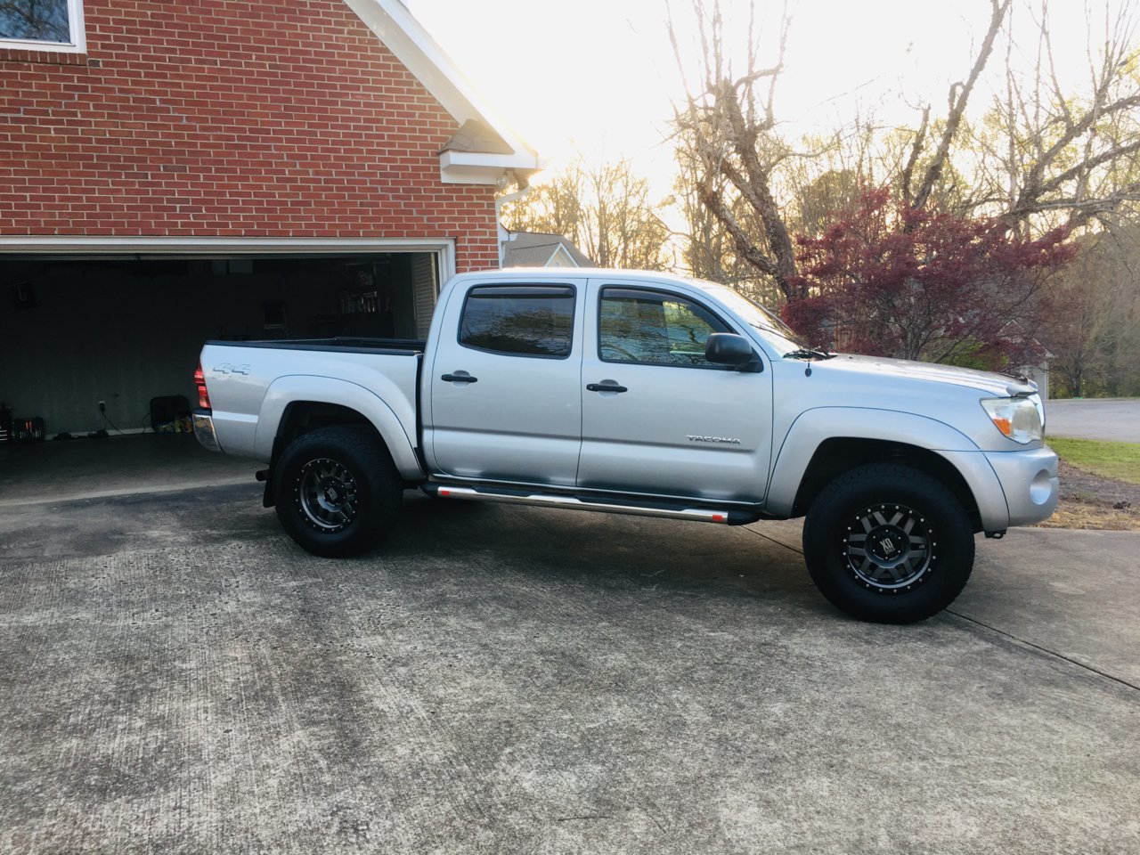

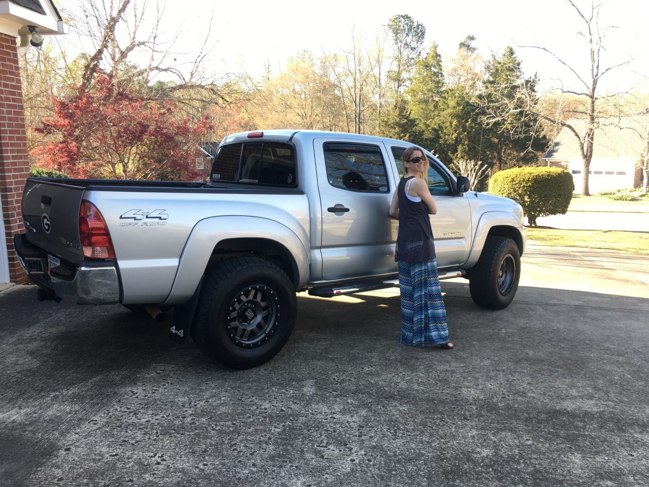

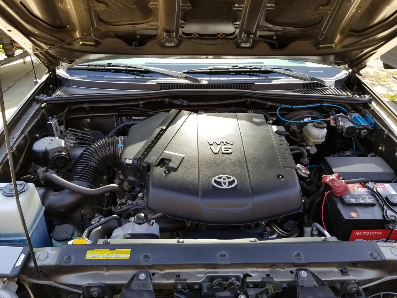

    Update: father gave the wife his '08 silver Taco 4x4. Did all necessary maintenance (wheel bearing, timing chain, etc), had Wheeler's off-road put Toytec coils (Eibach 620lb coils... Same as on the Fox coil overs) on Bilstein 5100's, and recall leaves with 5100's out back (Wheeler's super bumps all around of course!!!!... Some fender trimming as well to fit these...). Happy patient sold me his XD wheels and 285/70/17 Nitto terra grapplers (18k on Em) for $700. Put 2 JL audio 10's behind the back seat, JL components, and a Sony touchscreen in her and the wife is happy... Happy wife, happy life.
    Point: FOX is waaaaaaaaay more forgiving. Billies are stiff as F. Granted, her truck handles like a race car and straight awesome on-road (first road trip this weekend and rides better than a Lexus), but my Foxes are super plush by comparison when hitting the S. Like both a lot, but if you are going to wheel your truck, spend the extra $800-1k for the Fox setup. The valving is second to none... Why they keep it secret.
    3 turns up on the driver's out of the box, 265/75/16's and wheel the F outta it... Like me.

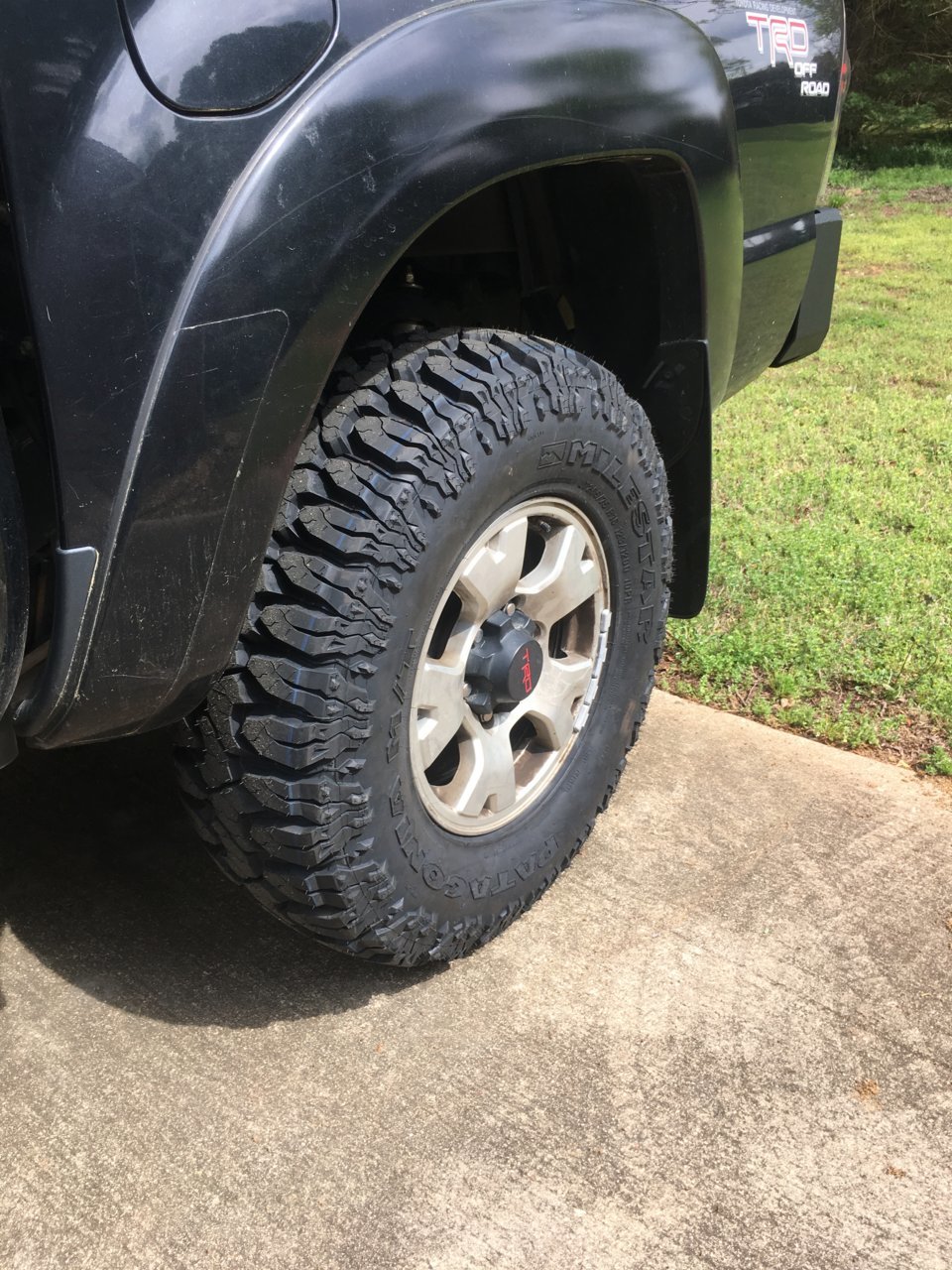

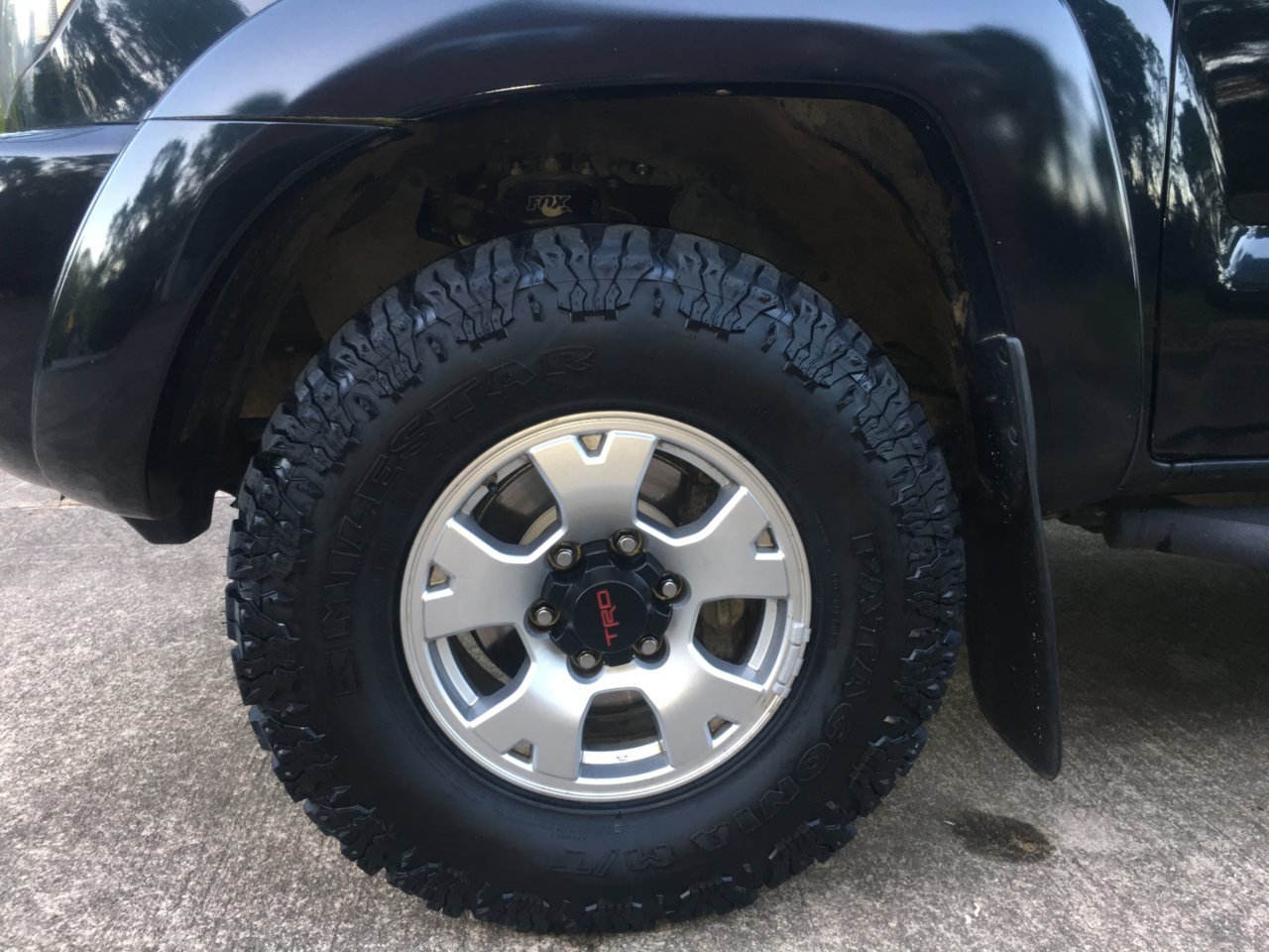

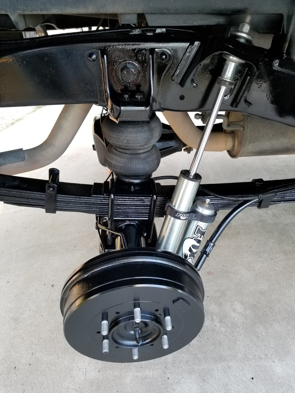

    Just installed 265/75R16 Milestar Patagonia's on the Yotota fellas. Simply the best tire I've ever driven on, period. $136.68/tire shipped from "the devil" Amazon. Tech said they're the ONLY mud tires he's ever not had to make a single adjustment on when road force balancing in 20 years. They ride like car tires (got up to 80mph) and have almost ZERO road noise. Will likely be doing a review of these tonight. I'm straight mind blown. Better than Wife's '08 Taco's 285/70R17 Nittos, my old KM2's, Goodyears, and even my dad's '19 Taco's Michelin road tires. Pics to come after my truck gets a wash haha, Mully would be disappointed if I posted pics right now! Will add a quick preview though...

    Nice looking tire. Want to see that write up and the washed truck.

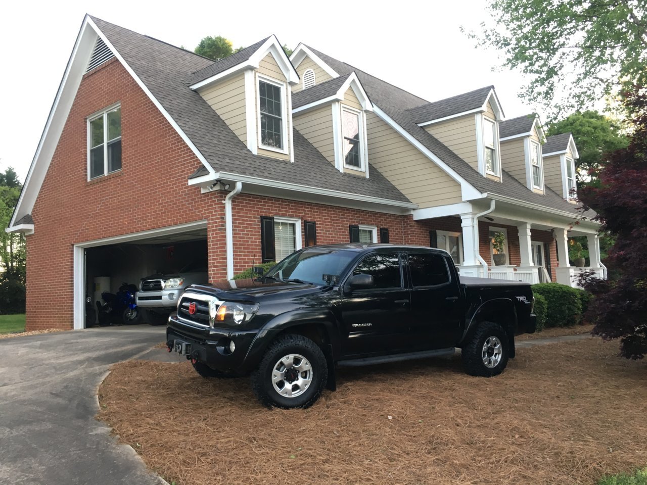

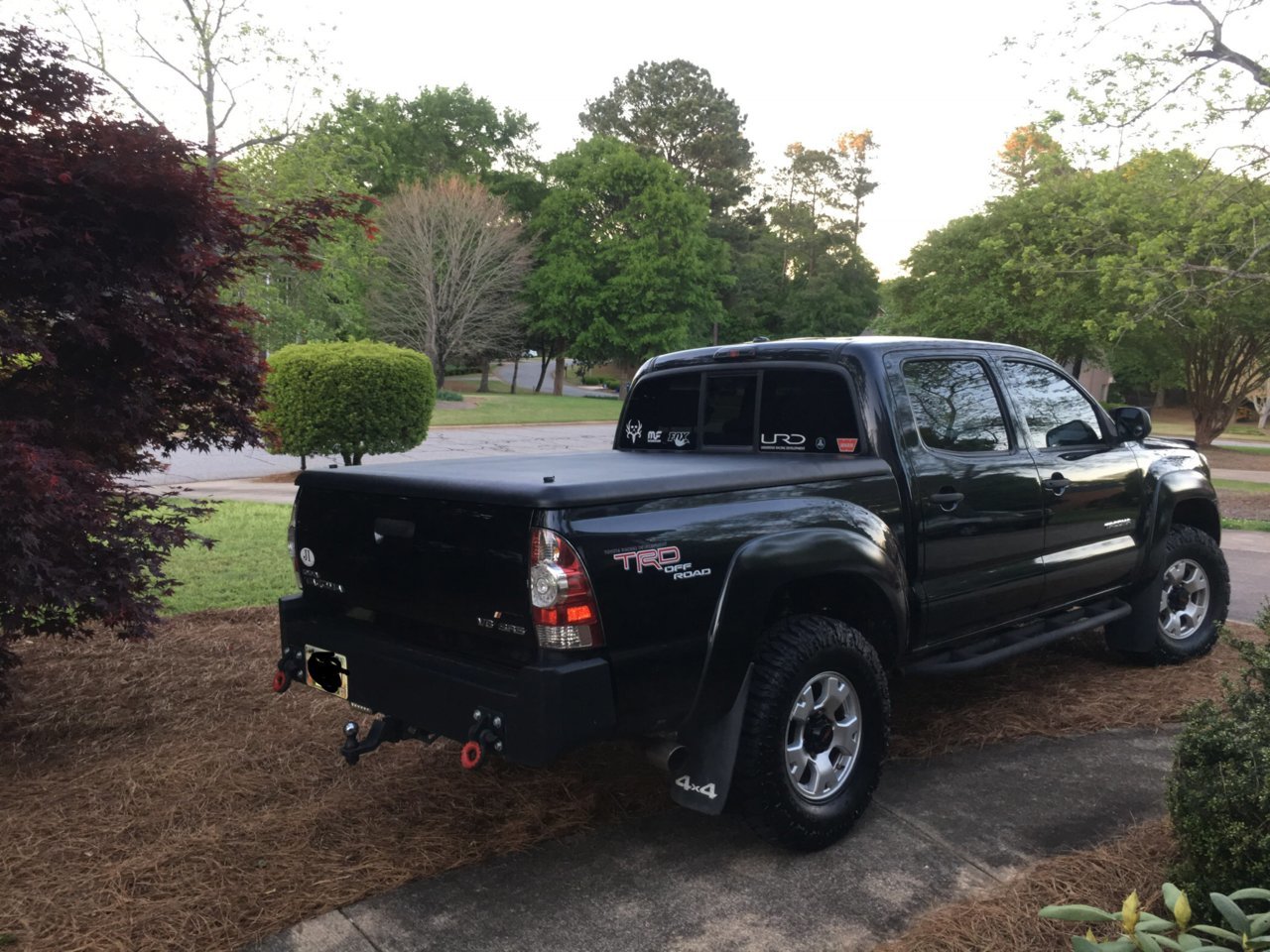

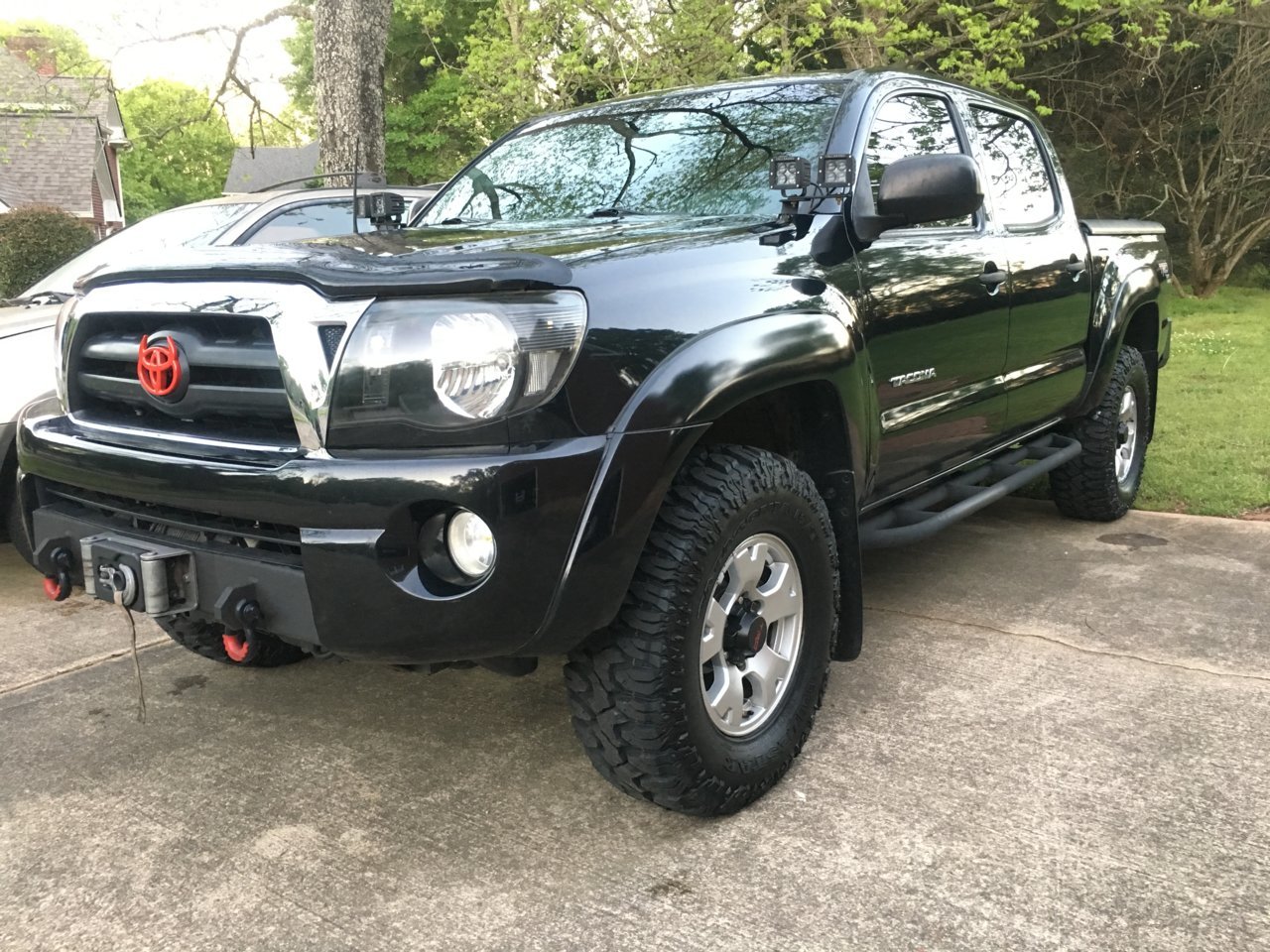

    Washed... she’s gonna get really really dirty this weekend. Want to turn up the 2.0’s to where I should’ve set them, but just not worth the $ for the alignment and all. She looks pirty though in the yard...(note the rear bumper, haven’t posted pics in a while. Twisted factory “bumper” crossing the creek... not a bumper, more like a chrome plated pos. Body armor replaced it. Jumped, bumper hit. No twisting!! 7F262EB0-FC83-4EA3-B36F-A84BF3C3E164.jpgEB9C4FA4-0E72-4814-A8D1-982E865BE369.jpg A98078BE-45E4-4AC1-AC90-4132B65D8349.jpgC72489EA-DB81-40D9-AF44-73BB5B59A72A.jpg

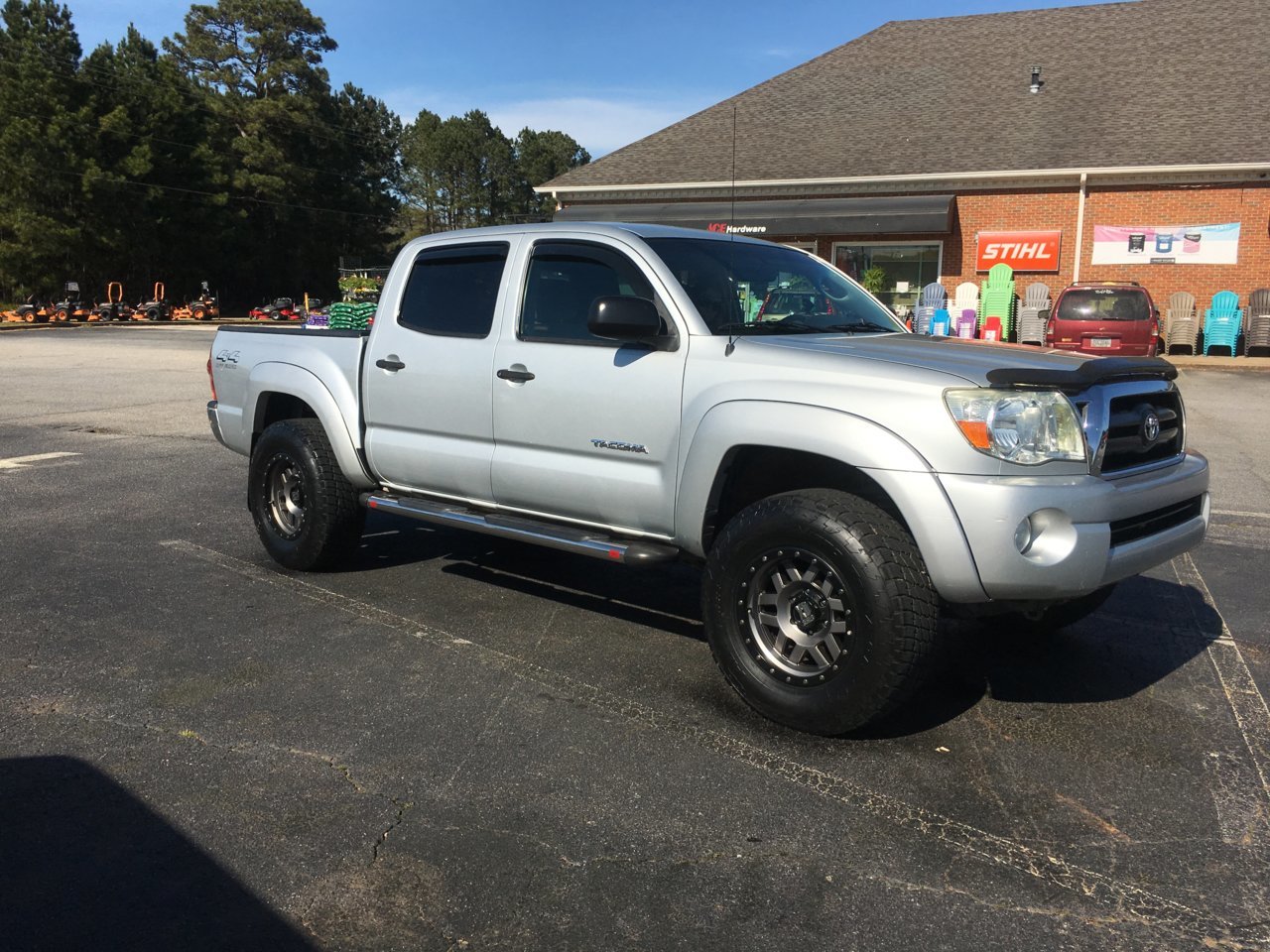

    8708BB5B-83E1-48D0-90D9-AF5932261EDD.jpg Wife’s Yotota on 285/70R17’s with the bilstein setup. Toytec Eibach 620 coils (again, same as Fox 2.0’s) on Billy 5100’s, rear 5100’s, and recall leaves... handles like a track car it’s so stiff. Dead level though. JL Audio all around with 2 10’s out back and Sony iPhone mirroring head unit. Happy wife, happy life. Point: FOX!!!!!!!! Iffff you want a super plush ride off road. You drive these two trucks and you’ll know where the extra $$ went... to straight sweet aluminum awesomely valved awesomeness. P. S. More test driving on those stupid cheap Milestar Patagonias and will say the wife is getting those once the Nittos need replacing. Hear ya on the cab chop Mully, prob ain’t happening, she’s just gonna scrub a bit on road until the Patagonia’s wear a bit. Really don’t think her rig can handle what I do to mine. Suspension not there. Looks nice, just not FOX. Do what I say fellas and your rig will fly... if you want it to! 4D07D708-CC62-4E60-BE52-31312ADEE0E1.jpg

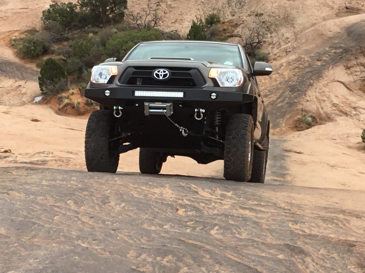

    No worries Brother, these COs are worth every penny and more. They ride great even cranked up, but I have a lot of weight hanging off the front of my truck. Think that helps when you crank them up to 3". My leak is only a very slight seepage that just started and I got over 43K miles almost 8 years before this happened. I will be rebuilding them after Kings are installed. They still look brand new after everything I have put them through. I wheel my truck in Moab each year. One hell of a good product.
