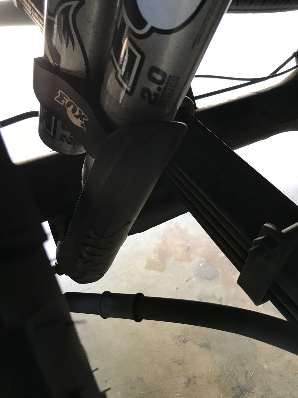

    three questions:
    1) are roost shields necessary -- what's the likelihood you harm your shocks without them?
    2) do you get roost shields for both sides?
    3) what's the best way to mount the 2.0 adj. -117's reservoir up higher and not connected to the main shock body? i've seen people run them this way and i like the way it looks
    TIA!

    One roost for the pass side is def necessary; otherwise, your rod will get hosed... And not in a good way. Pass shock is totally exposed. Mount the resi to the frame if you can. I will likely move mine eventually.

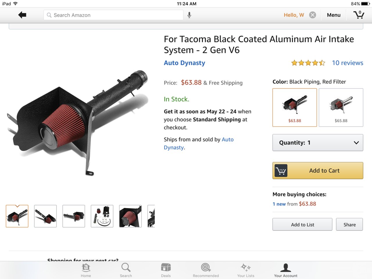

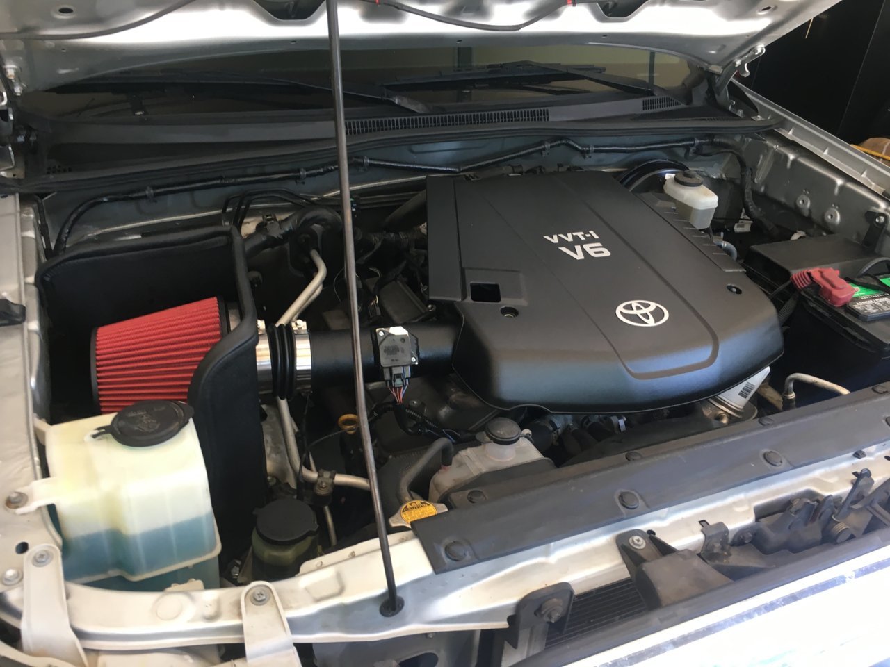

    Put this on the wife's taco yesterday and it is an absolute steal. Added more rubber piping to the heat shield to seal it better. It sounds better than my URD intake, and the truck (after pulling the ecu fuse for 15 mins to reset it so learns it has more air flow) pulls like a mad man.
    Update: def buy this if you don't have an intake. It's a straight awesome crazy steal. Growls at ppl when you floor it. Wife loves it!! Also, bilstein setup breaking in, still not as cushy as FOX, but springs take time and softening up nicely.

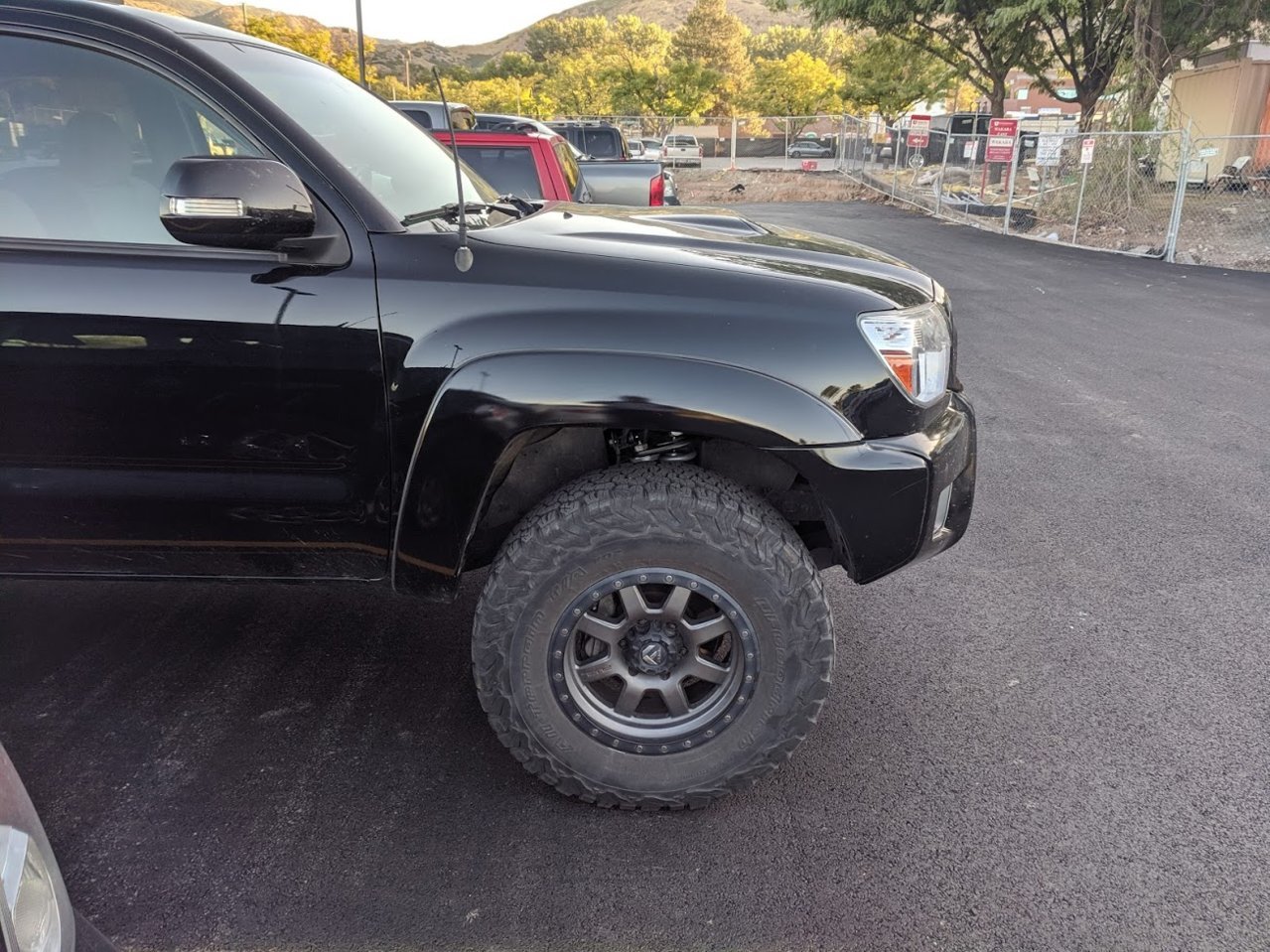

    Just got these shocks installed on my truck (plus some SPC UCAs and the Icon RXT leaf pack). It rides like butter now! Thanks to everyone in this thread, especially @Chaz84 and @Mully , really helped me make the decision and I'm mostly* very happy with it.
    8z63pm_ledchp9w726c8D4U611QvWrVyWBbwd1FG_245b0f43be800ed89aa219e953d9079ce2000a73.jpg S0sSvRGYxMdGweh5I4j4btmyqOtDjUIi6ITj_hsr_27f939640f68920b7f859f7bcd7e2a0e9f0ced6a.jpg LH8SQgW6S1s-w5-s0jRRySzwd2Zb_n_eV8IKNDU4_df380ad938bc59045d49cd45b8ff257d0b095581.jpg
    *The mostly is cause I was replacing a spacer lift that was on the truck when I bought it and my 285s are now rubbing slightly. I'm debating between turning the coilovers up to 2.5-3" or doing a little chopping at the back of the wheel well. I think I could also bump the caster up slightly to push the tires forward slightly.
    Update: Cranked the front coilovers up to 2.5" and pushed the caster out to 2.7*. It still rides great and the rubbing is completely gone! Looking forward to getting this thing on the dirt this weekend.

    I ordered front and rear 2.0s, with the rear being adjustable reservoir. Question is, can I run the roost shields without remote mounting the reservoirs?

    Yes, you can. I run mine piggyback. But you only need one for the passenger side.

    As already stated, yes! Just piggy-back them with the clamps but also know that you only need one for the passenger side since that sits in front of the axle, DS is protected by the axle.
