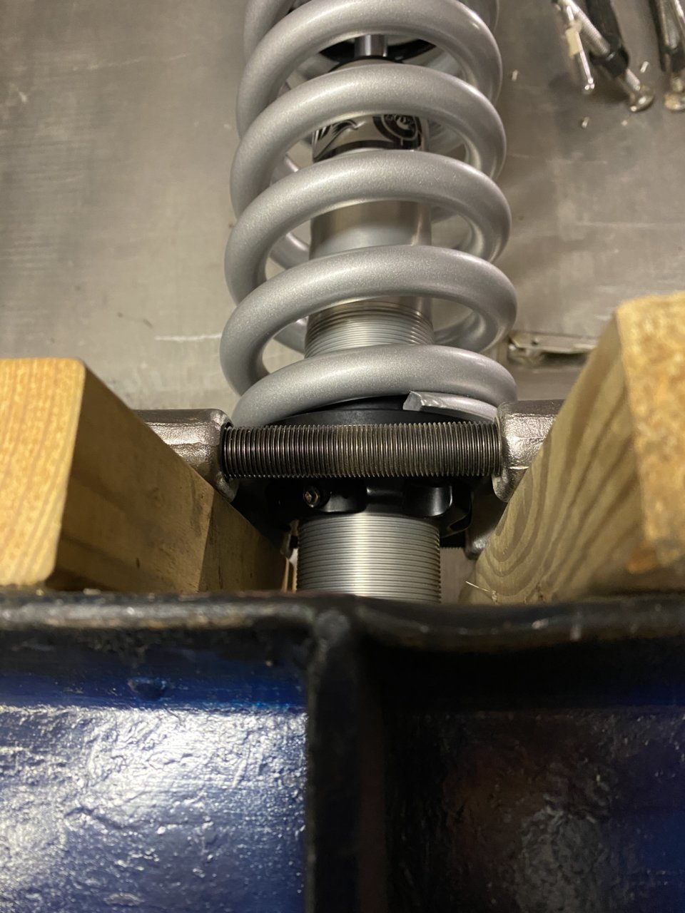

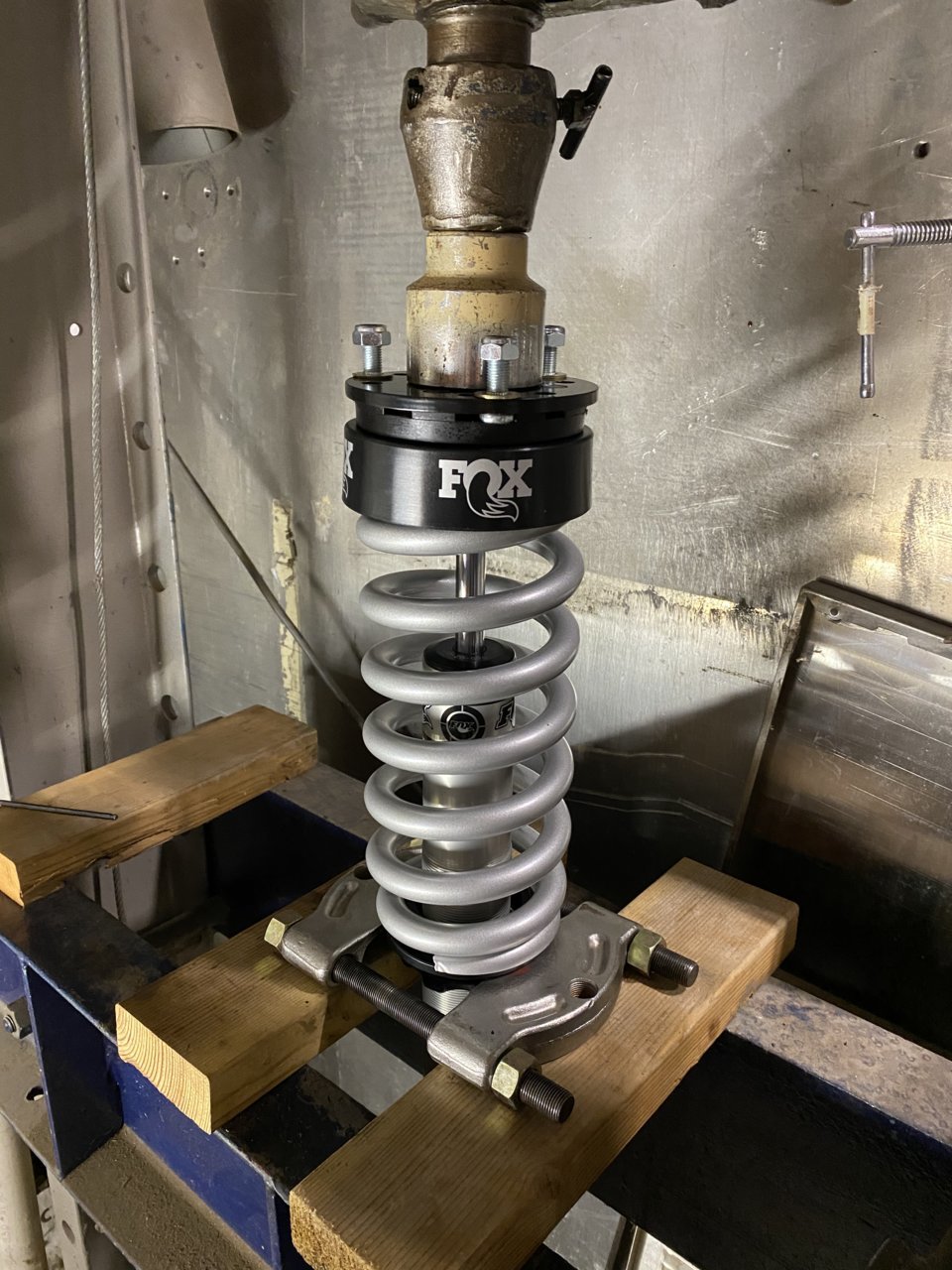

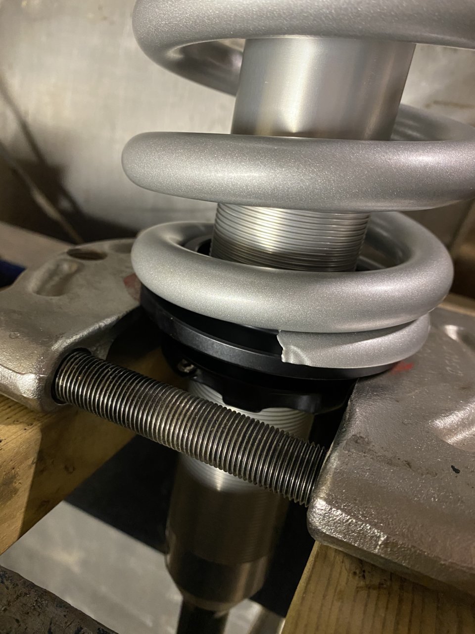

    Went ahead and adjusted my Fox 2.0’s in preparation for install. Went with the recommend 9 turns for the drivers side and 6 turns for passenger side. Figured I’d share some pics utilizing a press to make the adjustments. I used a 2” 3/4 drive socket on the top hat. For the bottom I used a bearing splitter to hold the black bottom spring perch.
