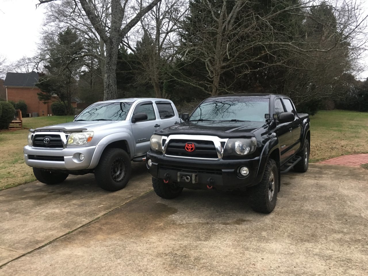

    Latest pics the other day... Dirty girls! Silver is the road truck and black is the wheeler. Underside of silver still looks brand new.

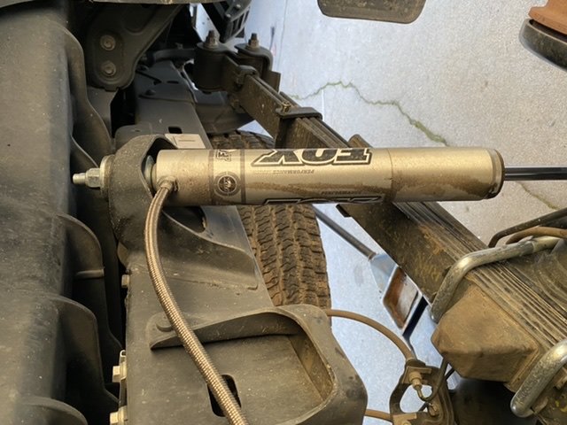

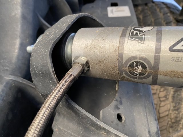

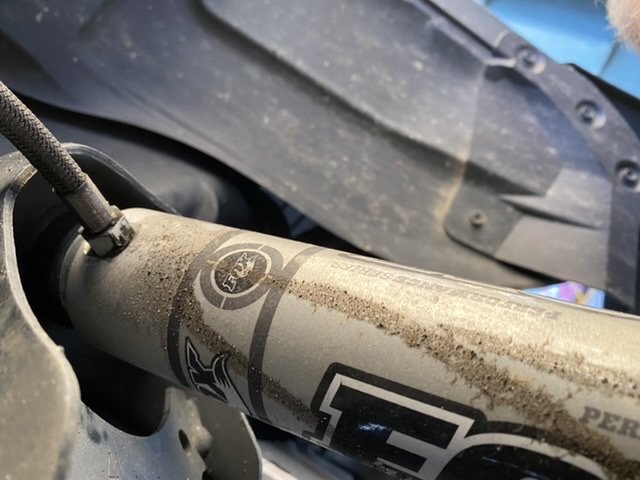

    Has anyone ever seen the 2.0 Coilover blow the cap out of the top of the shock (not sure of the exact name of the part)? I was driving around town and was experiencing a rather loud clunking noise and got out to find that the shock had opened up and all the oil had come out.
    Still waiting for fox to respond to my email regarding warranty as I just bought these in September, I searched around and didn't find anyone with a similar issue.

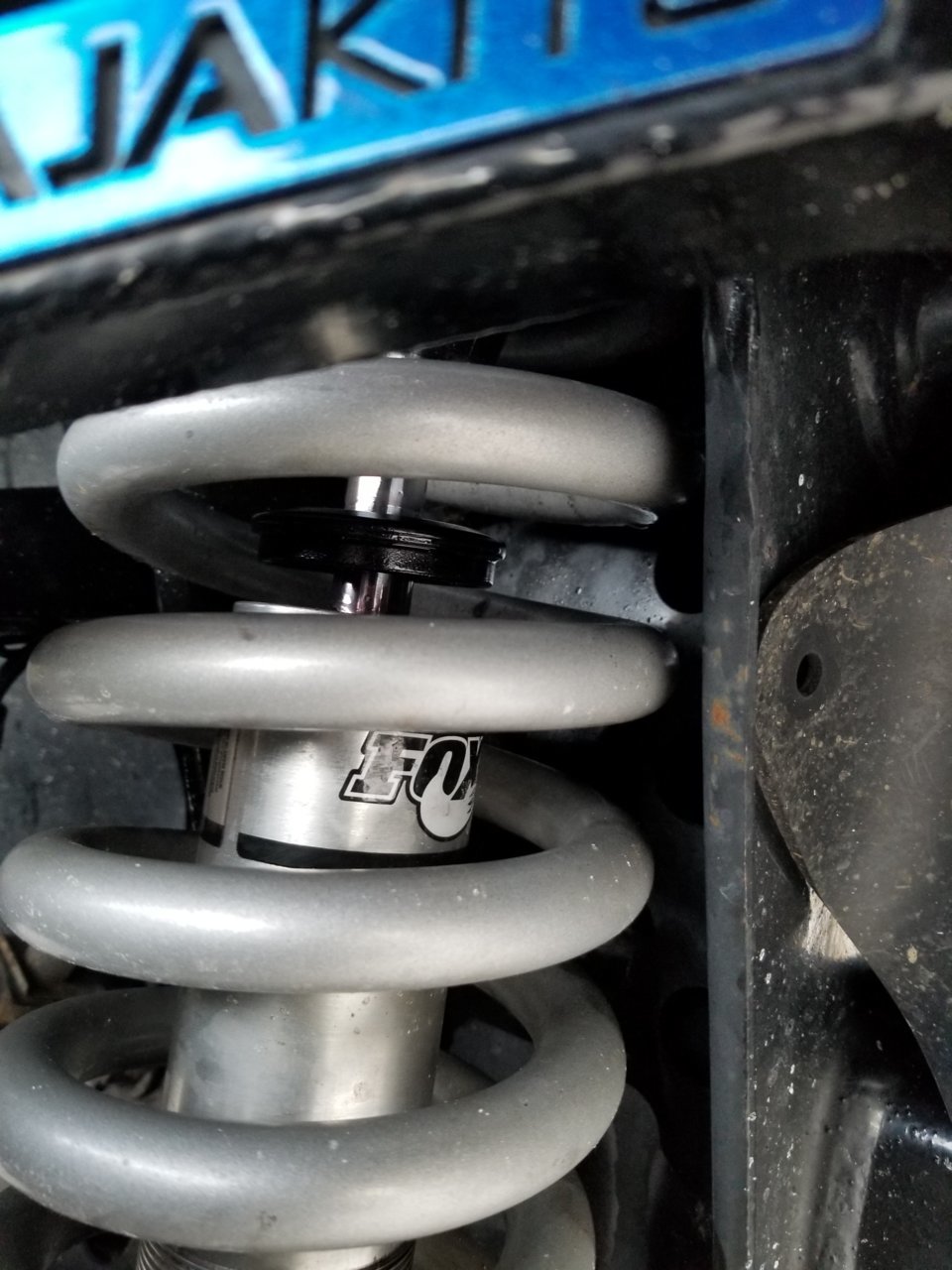

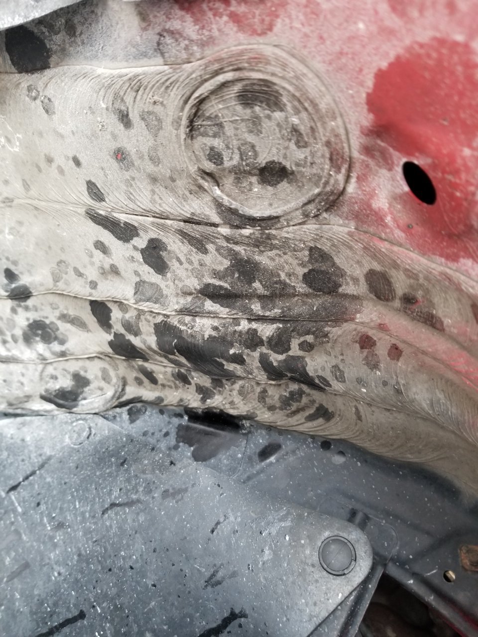

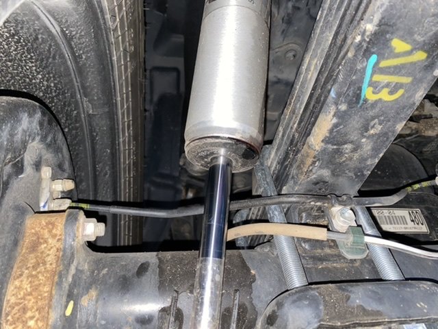

    Figured I’d give you guys a quick update on my Fox setup. Approx 500 miles after install I went to retorque all the hardware and was a bit surprised with what I found on the driver side rear...
  19. Jan 31, 2020 at 12:31 PM
    #479
    El Chivo Norteño

    That doesn’t look good :puke:

    Yeah really not to happy. Hopefully the warranty process through Fox won’t be to much of a hassle.
