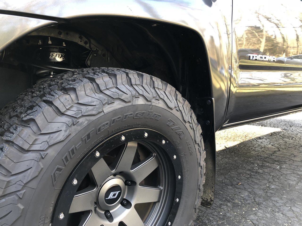

    Finally got the fronts installed! Stock rear leafs and shocks. I turned down the passenger side 3 turns.
    I measured from the ground to the bottom of the fender arch. It was like 36 1/4 up front and 36 3/4 in the back.
    Had a little help!
    I purchased the 117 rear struts. I really want to use them. But im not ready to buy rear leafs.. am I going to have issues with the extended travel they have?? Should I get a set of the super bumpstops when I order the guard from wheelers to prevent bottoming out the strut? Also what bracket are you guys using to frame mount?
    Thanks all!

    Yes on the turns. The 3rd gens still have the driver's lean bc all Toyota did was put the 3.5 in the 2nd gen frame. You may have to do some fender trimming like I did with the wife's setup.

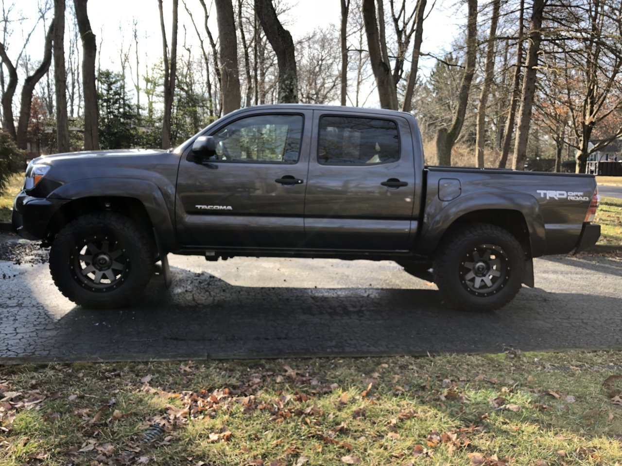

    This is Mully and a pic just before I sold my setup.
    Mind you, this is with 40K miles on them also.
    I take extremely good care of my stuff.
    The FOX 2.0 is an excellent coilover for the money.

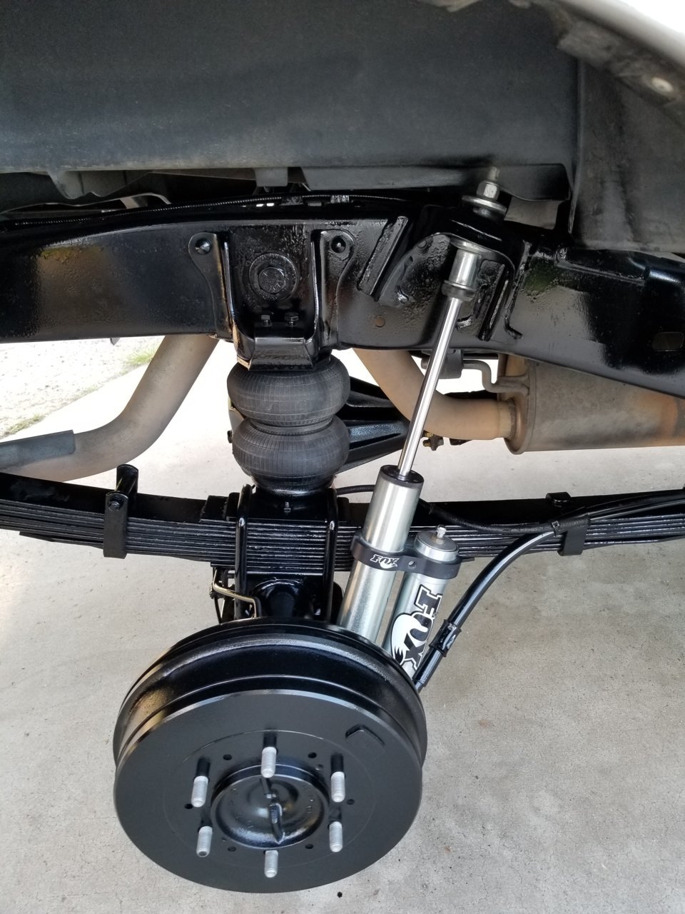

    Mully. What rears did you run? Any pics on how the resi was mounted if it was a 2.0? Looks awesome!
  8. Feb 3, 2020 at 10:16 AM
    #488
    Mully
    Mully Well-Known Member
    Feb 12, 2014
    #122907
    5,270
    CA
    12 DC 4x4 Lifted Sport
    Lifted, Kings, Locked, 295s and more.
    I ran an inverted piggyback resi.
    Got a smoking deal on them, they were new, returned item, never used, so they gave me a 50% discount. Couldn't pass it up. Besides, I wasn't crawling over rocks, so they worked great.
