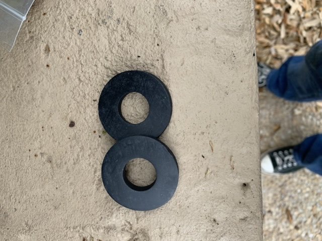

    50D58054-FA75-4BBC-AAED-1A0D90C05F7C.jpg Installing these right now. Anyone wanna chime in on what these washers are for on the rear shocks? Got the right bushing in for the Tacoma which was a PITA but can’t figure what this rubber washer is for.

    Fox includes extra hardware for diff possible setups. They're likely shock mount bushings. If everything looks like the pics on here and there's no metal touching metal, you should be good lol.

    Thanks for the reply I was thinking there couldn't possibly be a use for these in the tacoma application but as things sometimes go, I would have found out that they are a vital component - RIGHT AFTER the install was finished.
    However, I figured as much and went ahead and finished the install. Man, I wish I never even went with the Bilstein 5100's to begin with. I like these Fox's so much more. Night and day. Lot of good info in this thread - made the install a breeze.
