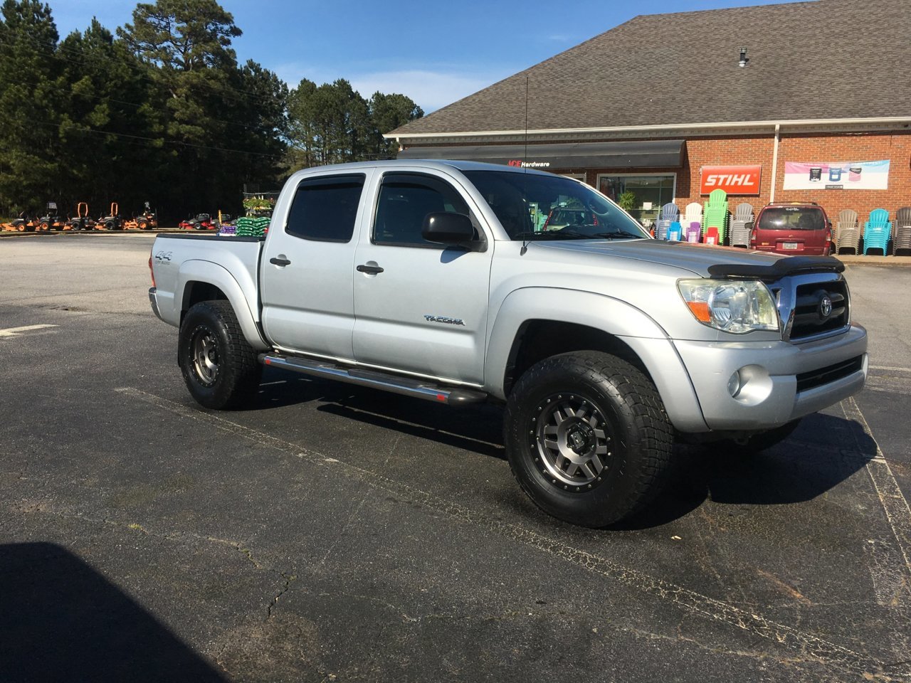

    Chaz84, your wife's Tacoma looks awesome. Here's what I have. I am sitting on 5100s on all four corners. Front set at 0 with the OME 883 ciols. Which gave me a little over 1 3/4 on an inch with the drivers side spacer. Out back I have a one inch block. Would like to get 2 1/4 inches up front or as close to level as possible. Thank you for your reply!

    Oh, so you already have suspension on there.
    If you just want her level and not looking to spend 2k, I’d just go to first setting on the billies Bc those coils are not progressive and the ride will only be slightly more stiff bc of the LCAs.
    Now if you have some miles on the billies and want superior ride, go 5 turns up on driver’s side 2 on pass and get the progressive AAL’s out back (far superior and cushier than stock, if that block has put a bend in your factory leaves, then you’ll need Dakar replacement springs). That’ll put you dang close to level and give you the Fox ride.
    Add wheelers super bumps on all corners either way.
    Really depends on your mileage, $ to spend, and how badly you want your truck to ride smooth as butter.
    Question: how many miles on your current setup, how do you like the current ride, and how much do you wheel your truck?

    I don't wheel at all. Have about 25000 mile on this set up. Rides good. Just a slight bit harsh on rough roads but nothing horrible. I do have the Alcon 8 leave + 200 pounds leafe packs. The didn't lift me any that is why I installed the 1 inch blocks. Got the extra 200 pound capacity because I had a shell at the time. Reson I was looking at the Fox was for the ride quality and to fine tune the lift.

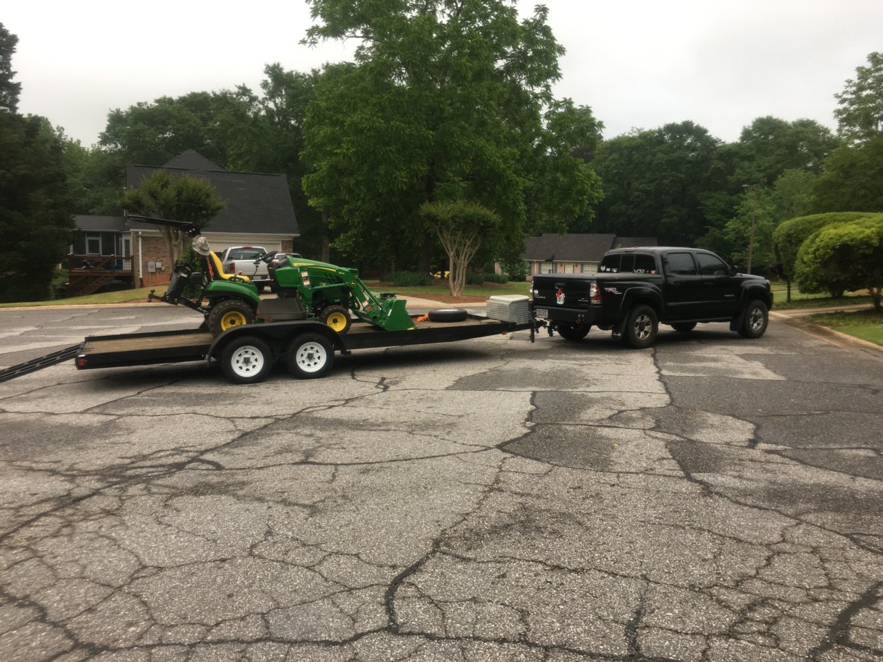

    Rear settled after experimenting pulling new trailer and sub-compact lawn toy. Think I'll be investing in airbags like the all knowing Mully.

    There's a reason I kept her center of gravity low... where I grew up. Drove home with Zero issues after a day of wheeling. Not a bad 360. Had a heck of a time posting the video, hope it worked. Wish there was audio, girl sounds like a pissed off animal.

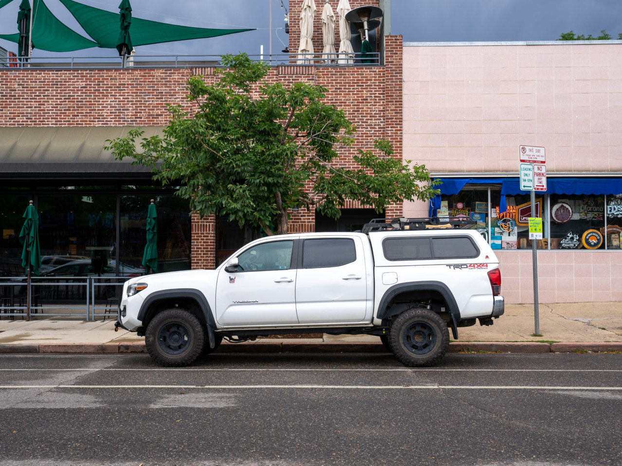

    Here is my Fox 2.0 installed with OME heavy duty leafs. Shes got a little rake now.
    Also here is a video of the install. https://youtu.be/kvSMeyqTt88
