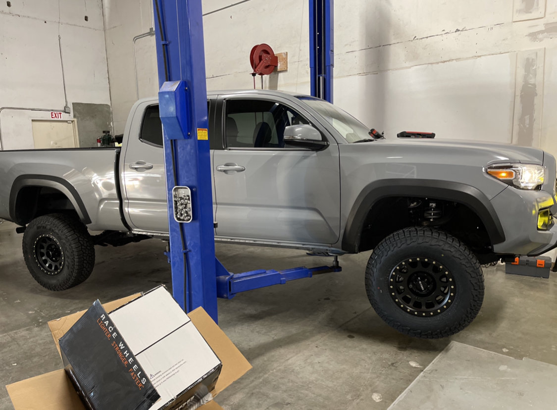

    Coming soon!!!

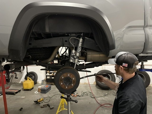

    Almost there!!

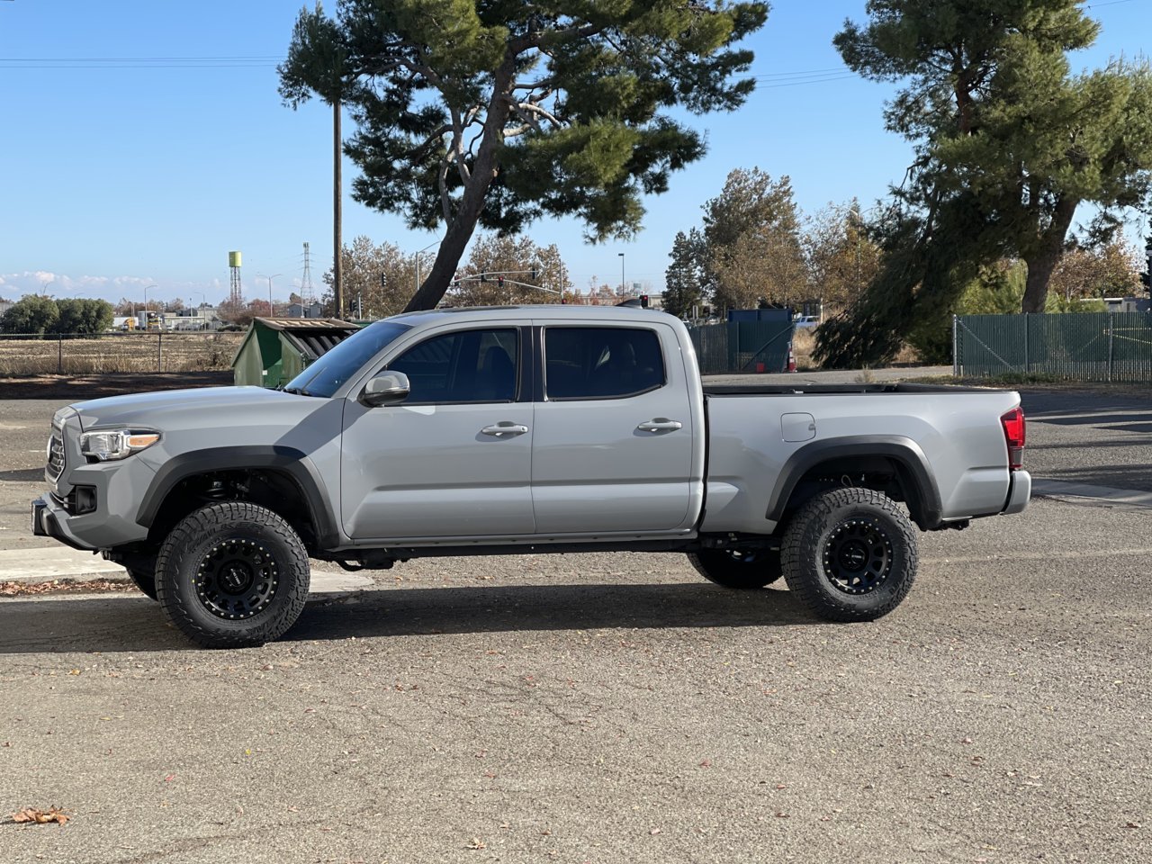

    Update-
    Somehow the Icon 3 leaf progressive AAL w/overload left in netted me almost 3 inches of lift in the rear?
    We had to crank up the front 2.0 coilovers just to get the front level with the rear and the ride was pretty stiff.
    Pulled the overload out the rear and lowered down the front coilovers a bit and the ride is much smoother.
    Don't have official measurements yet but it should be closer to 2-2.5 inches of lift now and I personally like it much more with my 265/75/16's.

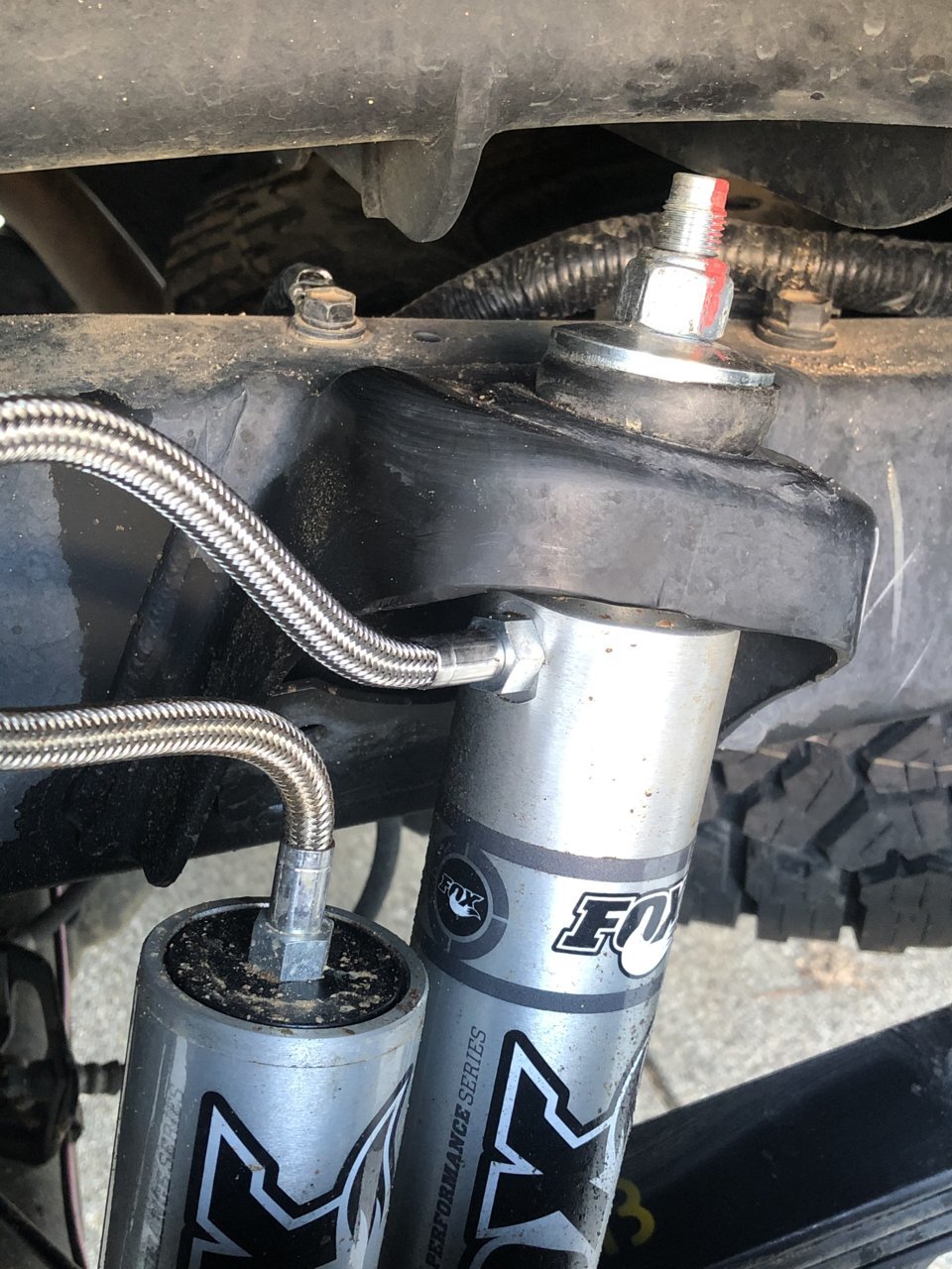

    Anyone one have a pic of how low your reservoir is mounted to the shock body?
    I think my shop installed them too high up which caused the hose line to have a bend which ultimately got pinched :(
  15. Dec 2, 2020 at 8:58 PM
    #555
    franzgod
    franzgod Well-Known Member
    Jan 25, 2018
    #242421
    181
    Frans
    Los Angeles, Ca/Bay Area
    2017 DCLB TRD OR
    I have mine mounted just as high as yours. After doing some full compression tests on the rear end I noticed the reservoir would hit the axles.
    Moving them up that high is one way to prevent this or I've also seen some people rotate the shock around and cut a notch in the mounting cup to clear the hose.
    But if you don't ever plan on doing some serious wheeling and fully tucking your back tires, you'll be fine moving that reservoir down.

    Appreciate the info. That’s definitely why they mounted the reservoir up high as they thought it would hit.
    The shop wants to do notches to clear the hose as opposed to lowering the reservoir. Is notching a risky thing to do?
    I may just buy a frame mount kit for the reservoir if they make one?

    So the shop ended up grinding down the overhanging part a bit and rotated the shock and reservoir a bit. Looks much better and plenty of clearance. I’ll throw up a pic tomorrow.
