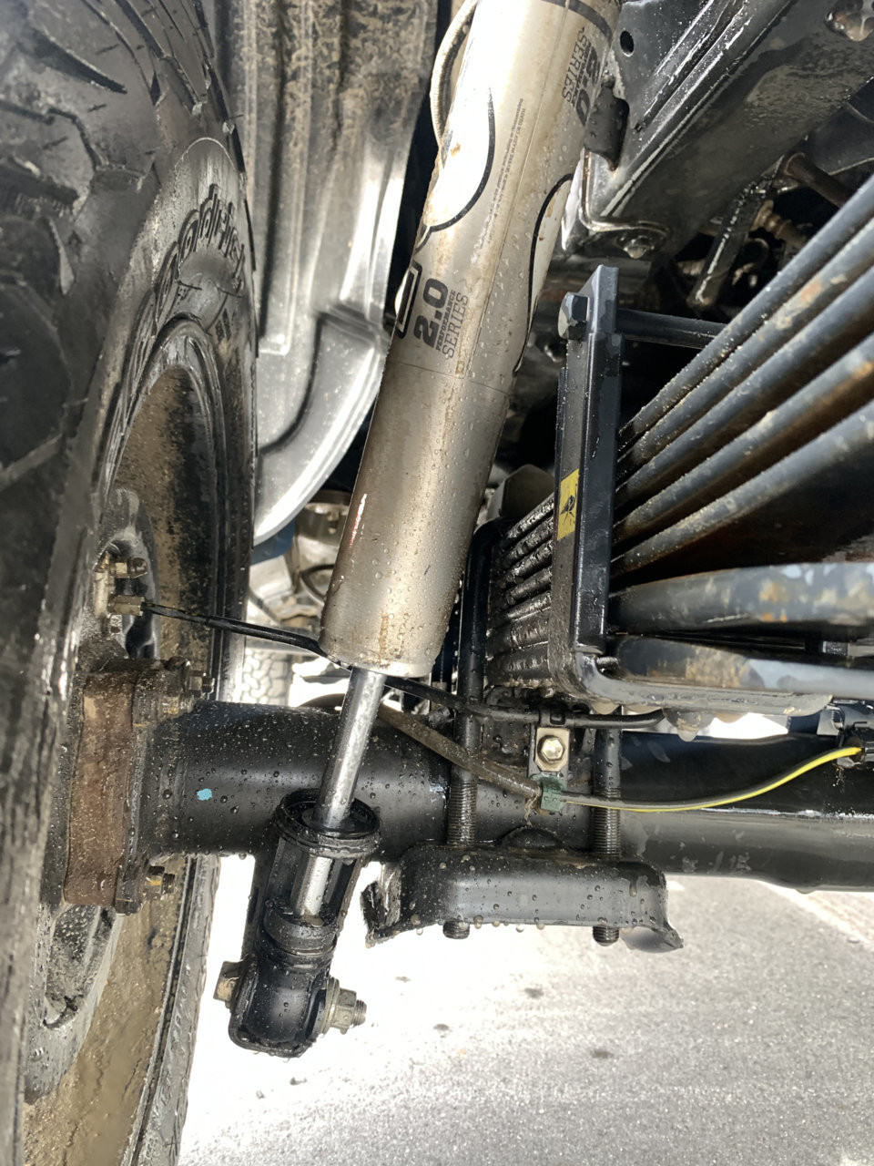

    Move the resi up to where it doesn’t contact the axle. You’re good. The lines are designed to handle 30+ degree angles. Bend them up bruh, you’re good. No stressing. Only thing is make sure you don’t twist them when mounting Aka Don’t twist the hose structure... put everything on without tightening the resi collar... slide it up with hoses about 30 degrees... tighten... and go get in a ditch to flex to see if it contacts.

    thank you Chaz, That is the only option with this setup in my mind. I may be able to slide the resi up another inch , we will see,

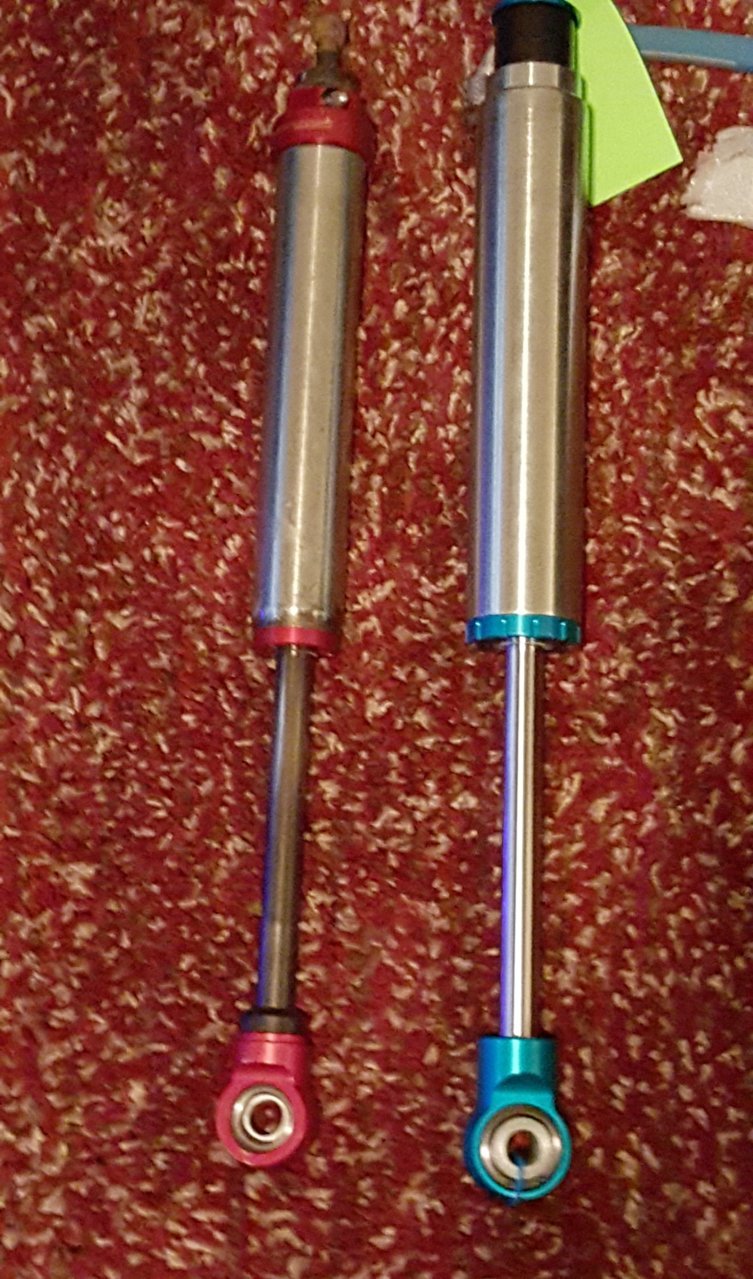

    There is a pretty significant change from 2.0 to 2.5 and seeing as you are in my neck of the woods......skip the KINGS. Their cold weather performance and cold weather durability is poor.
    2.0 on the left and 2.5 on the right.

    went with elka cause they actually care about us northerners :laugh:

    Nice. Elka will be what I am going to change over to, the KINGS will be relegated to back ups......or sold.
