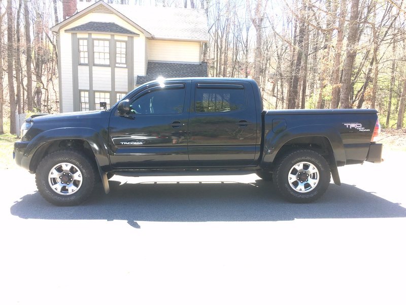

    Took the pic earlier, she's <.25" driver's side low (I went 2.5 turns down on the passenger side... Shoulda gone 3 full turns. Note earlier posts... Needs 3 full turns up or down depending on rear lift).
    So the pic is today w/ the rear settled and I couldn't be happier. Fox rides better than anything I've experienced. Def worlds better than my buddy's Icon setup (granted, he has 700lb coils prepping for major bumper... I just love the Fox valving... Tight, but plush... Perrrrrfect for me).

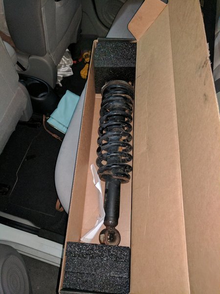

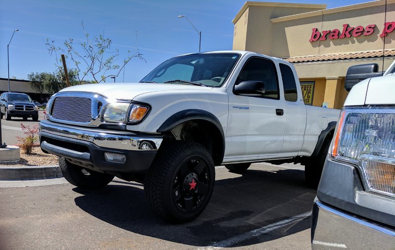

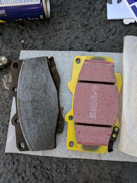

    Got new EBC brake pads, Fox 2.0 coilovers, and Bilstein 4600 in the rear, and it's like driving a new truck! I got a 2 inch lift from the Fox 2.0's. Love the truck and the brakes are awesome too!
    Truck after shocks
    Don't have a picture of the new Fox's, but they look awesome! The old ones are pretty beat:
