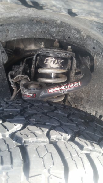

    Had a Bday on Fri and spent the wknd in the woods... found out my m8000's control pack needs some attention after being submerged a couple of months ago the hard way... it didnt work. Anyway...
    If you have LR UCA's then you are set. The fox's will still ride like butter because the 600lb eibach springs aren't progressive. Absolutely positive on that.
    Also, if I were you I were you I would call Dan (the man) at Wheeler's Offroad, order 1.5" progressive ALL's (and their superbumps... awesome), then follow my advice on turning up the driver's side Fox 2.0 3 full turns.
    In saying that, you can go the full 3" of lift up front (7 turns on driver's and half that on passenger) bc you have the UCA's and do the progressive ALL's and leave the overload spring in to put you where you are now and vastly improve everything. Just be aware, you are stressing components being that high and if you plan to have your truck until it blows up (like me), I would go with the first suggestion.

    BTW, do you get any popping sounds out of those Camburg UCA's?

    I have had them installed for roughly a month, just the other day backing out of my driveway I heard a pop. Has happened a couple times. I use tri-flow dry lubricant. Seens,to work pretty well

    Just be sure that pop didn't happen when the wheels were turned. Popping when suspension moving up and down=uniball on UCA (not a problem)... Popping when turning tires sharply at low speed=too much pressure on CV axle and too much lift for them.
    You may need to back down the front a bit if the CV joint is stressing. Just looking out.

    I'll keep this in mind. I don't recall having the wheel turned. I have it lifted 2.5" in the front. Hope it's not the cv axle.

    Don't worry about your CV joints unless they pop with the tires turned in 4wd, that's all I was saying. My fault for not being clear on that Mully. That, and I wheel the crap out of my Taco, need to maintain low center of gravity, need front mud flaps (GA red mud) so not going bigger than 265/75r16's, annnnd the Yotota has to last a long time bc wife & I are doctors w hella student loans... Thank you obamass for making it to where you accrue interest while still in school... Added ~$70k, ugh.
