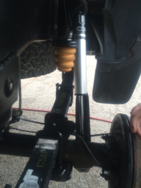

    This was my inspiration to use these bump stops from a Silverado(wheelers super bumps in the front). I used Icon strike plates for their air bump kit as a landing surface. Rides amazing and cost around $75 in parts.

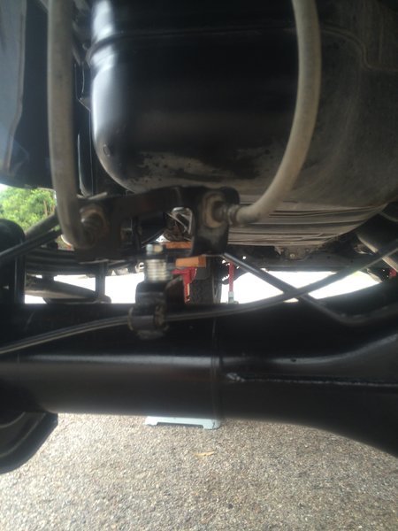

    While in there I made a 3/4" spacer for the brake line bracket. They were getting pretty tight under full droop.
    Now no more worries about stretching the brake lines or bottoming out my shocks. thanks for the great idea OP!

    That bump is tall enough to prevent your shocks bottoming out? Did you add the stack of washers the OP recommended? With my 8" stroke shocks and dakar leafs the calculations found required a 3 3/4" tall bump at compression....

    Yeah, my shocks are 10" stroke and I have a Dakar pack out of which I removed the middle leaf and the top overload. The bump stop has to compress 2.5 to 3" before the shock could bottom out and it feels progressive meaning that the more it gets compressed the harder it gets. But it's smooth at first I can compress it 0.5" by hand

    These are 4" tall

    And no I didn't add that many washers, just two on each side. I measured and found I didn't need so many

    Looks fantastic, good idea finally someone went ahead with this, I've been following this since I became a member, maybe longer as I was a lurker for few years. Good work.
