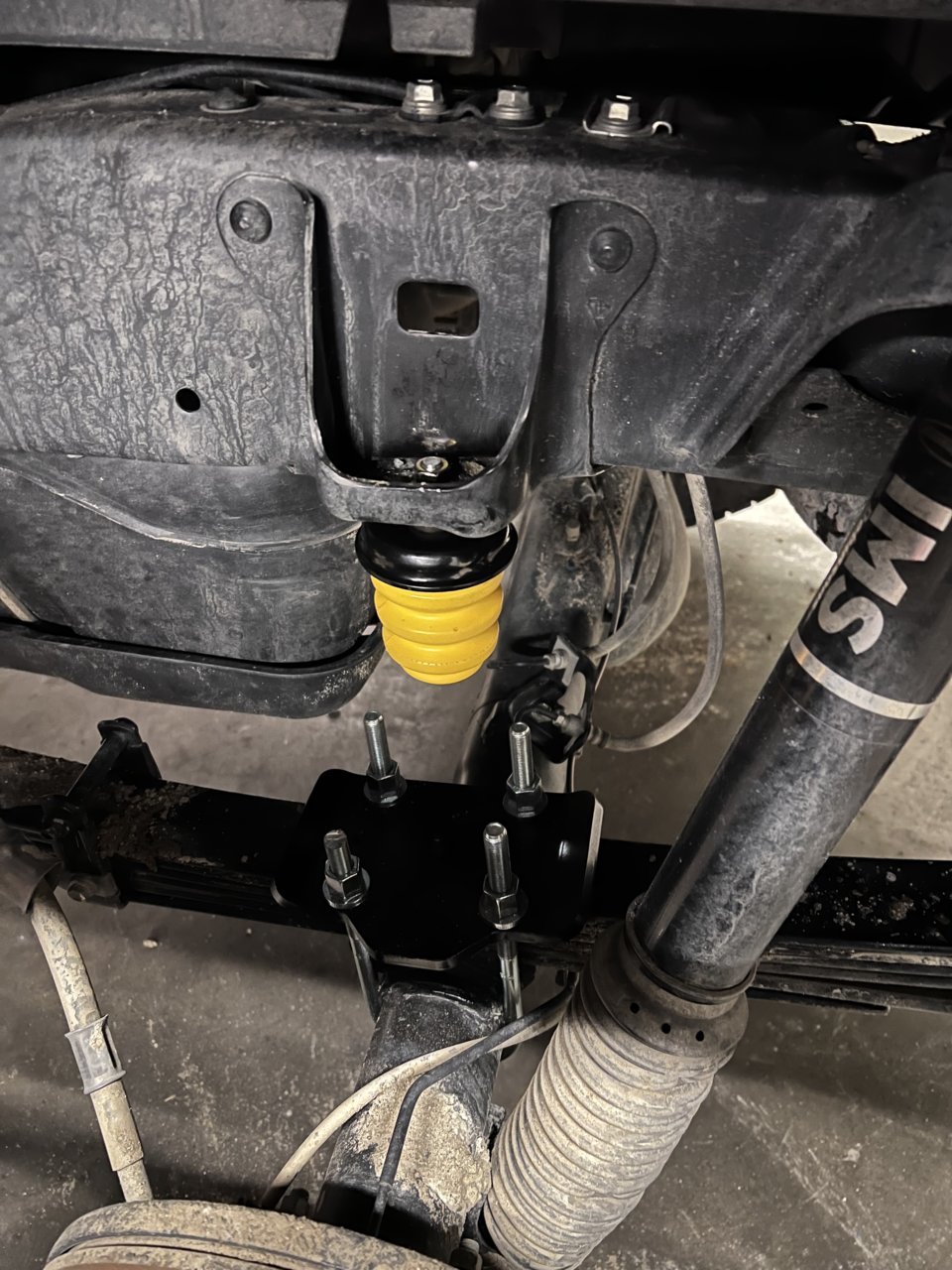

  13. Feb 25, 2023 at 9:48 PM
    #53
    MoonRockToyota
    MoonRockToyota Member
    Apr 19, 2022
    #395388
    24
    2022 Lunar Rock TRD Off Road
    This thread saved me so much. I ended up installing the GM bumps with a Wheeler’s flip kit and it rides so plush in the rear now. Crazy people spend $300 for the same stuff from sumo or timbren. Cost me $110 and 1 hour! (Before I get flamed, I trimmed the excess bolt shanks after this picture)
  14. Apr 21, 2024 at 12:43 PM
    #54
    Oreo Cat
    Oreo Cat Worst Member
    Sep 19, 2016
    #197755
    5,406
    Coeur d’Alene, Idaho
    how much spacing did you add to the bump stop to keep the shocks from damaging themselves? im planning on getting king shocks for the rear and doing this but dont know how much these bump stops will compress
  15. Apr 22, 2024 at 5:44 AM
    #55
    MAG GRY TACO15
    MAG GRY TACO15 Well-Known Member
    Sep 5, 2018
    #265273
    5,110
    Alan
    GA
    '15 TRD Off-Road
    Same crap everyone else got
    I did 4 thick washers. About the thickness of 4-5 quarters.
