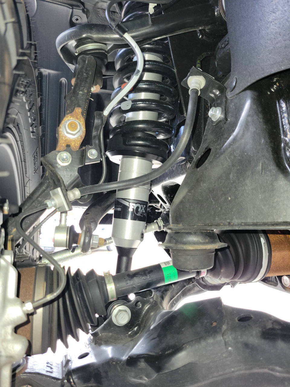

    Those entry level Fox 2.0 shocks are "far from top of the line off road racing shocks".

    Your cv boots will wear out exponentially quicker at that ride height.
    In the fall of 20 there was a 6 month back log to get them. I had to send my old ones
    out for refurb at almost the same cost to be able to use my truck again.

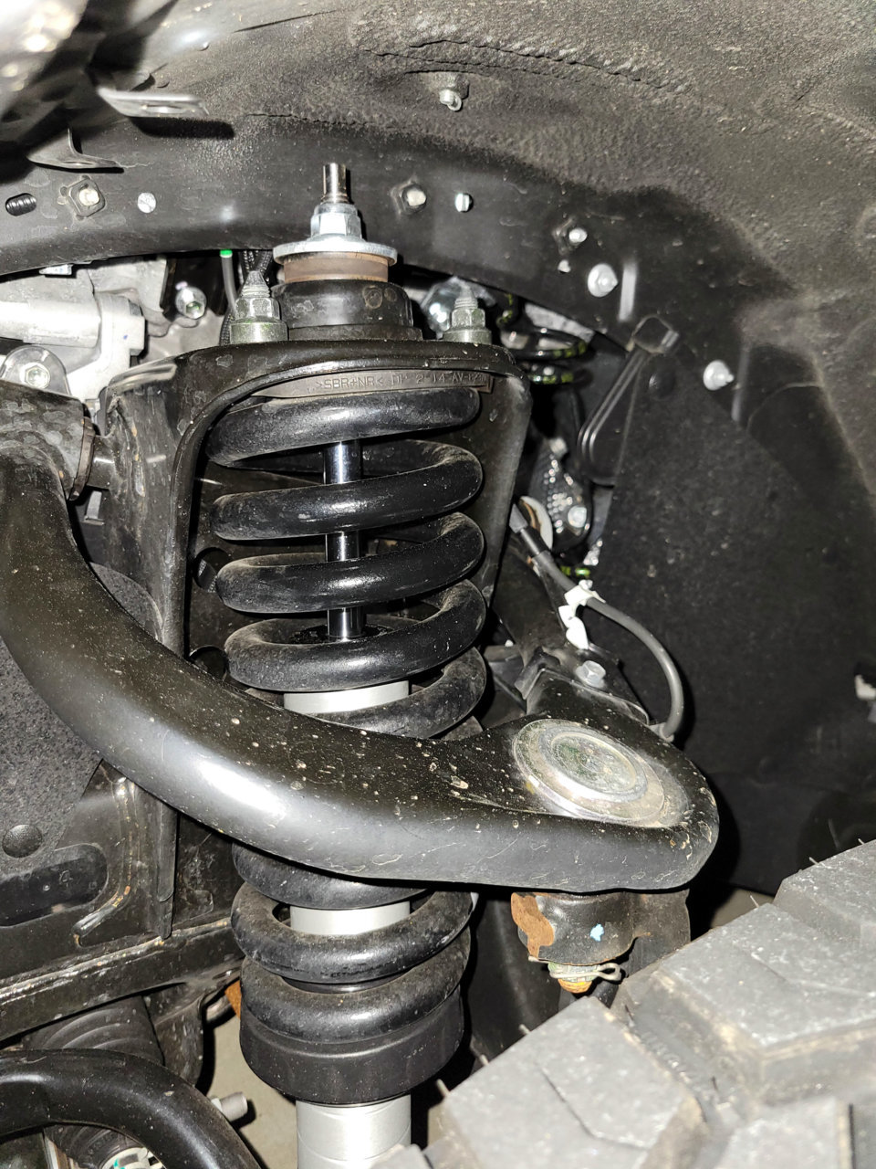

    Take a picture of the preload on the top of the dampener
    Clearwater Bill likes this.

    So is this something the shop should be able to fix? When going in I was told this was 2" to bring to level. Now I'm up 3.5 and need to raise the rear 1.5 to level. I asked if they could be adjusted and was told no. Kinda feel fucked over or they don't know wtf is going on.

    Yes it needs to be lowered about an inch. You are probably close to out of down travel, and your cv axels are rubbing. You need to start over. Check the part numbers and see if you were sent wrong parts etc. something is definitely wrong. Should be 1.5-2” with those not 3.5”.

    are those clip positions for setting the lower spring cup which adjusts the spring preload and ride height?
    can you take a picture of the top of the shock where it bolts to the upper mount?

    Looks like it to me.
    Needs to come down at least one, maybe both, depending on the spring rate.

    ok, I had these on my second gen. They were harsh and definitely an entry level ‘adjustable’ coil over assembly.
    they want pictures of the top because most chiller assemblies you can adjust from the top to set pre load.
    On these, you need to compress the spring then adjust the bottom. You need to remove it from the vehicle to do so.
    Edit; I’m lookin closer. I don’t know what you have bro. Are these even for a Tacoma? These don’t look like the normal 2.0 fox shock/coil

    255/80 e rated & "struts" and wondering why it's harsh...
    No uca's and those shocks look like they have more lift than my 3" Ironman setup. Is your bed loaded in the pic?
