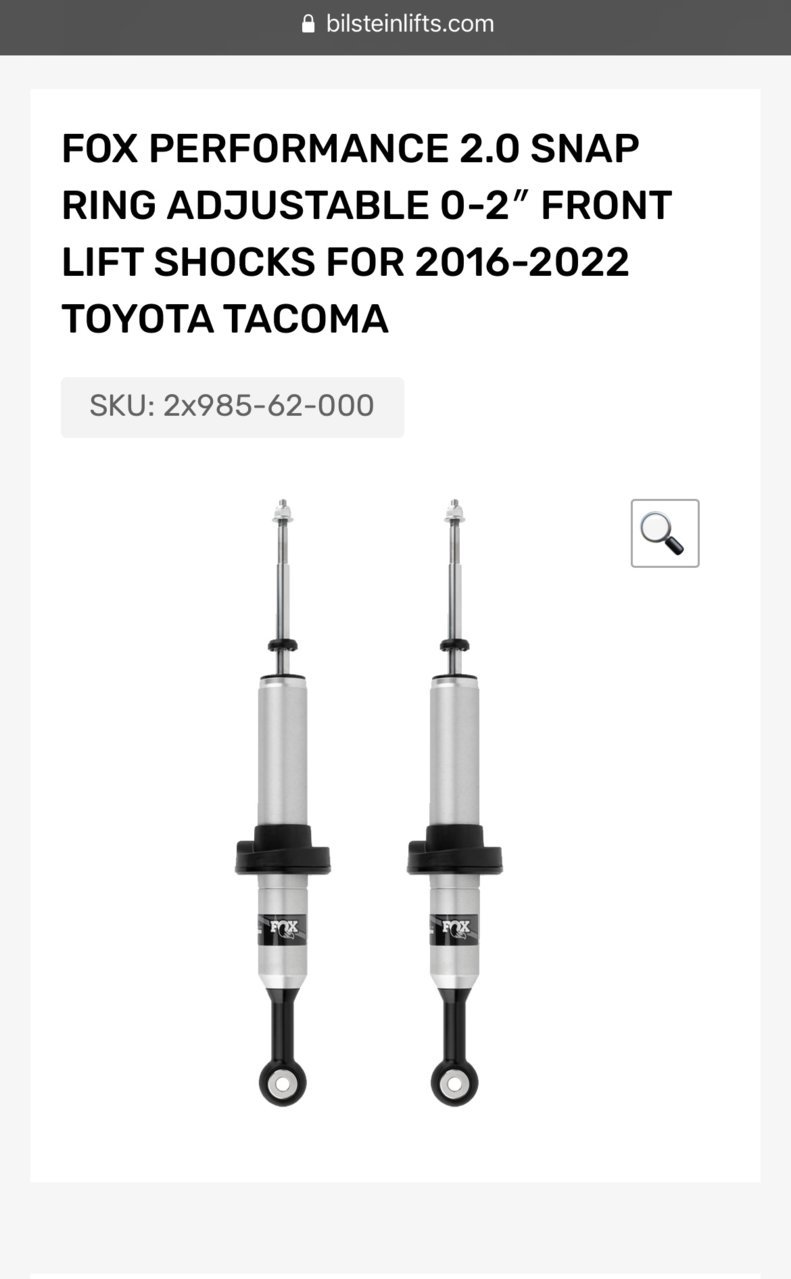

    It looks like he has these shocks

    here are the install instructions for the Fox shocks you have
    FOX Performance Series 2.0 Snap Ring Coil-over IFP Front Shock Absorber - 985-62-000
    https://www.4wheelparts.com/sku/FOX/standard/985-62-000.pdf
    Wondering if they need to be used a bit to settle?? Per the directions the clip position
    on your shocks are set up for a 2" lift.

    These are what I have. They're comparable to the 5100 that are on back order.
