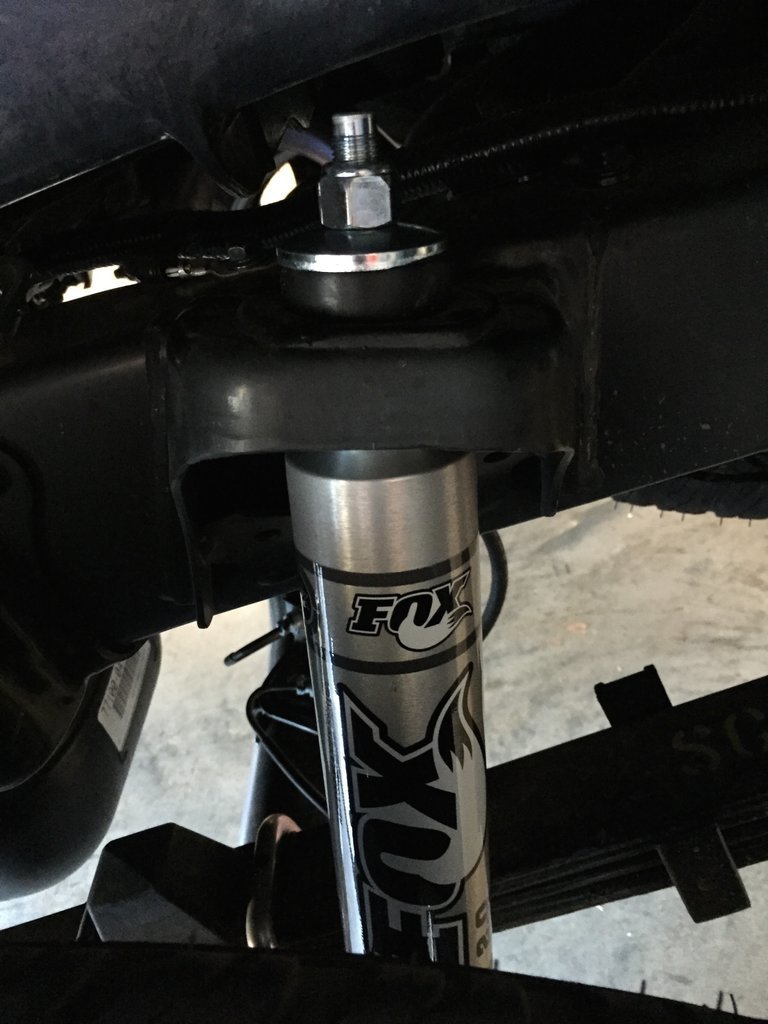

    I installed the rear shocks first. for god sake, lube your rear before pounding in the bottom shock mount. you heard me! lube that sucker up as the new mount is a tight fit. torque the bottom mount and finger tighten the upper mount. I lowered the vehicle before torquing the upper mount. Is that a word... torquing? Is that where you bounce your ass to the beat while squinting and making duck lips? looks sexy right? the shock not the dance. Anyway...

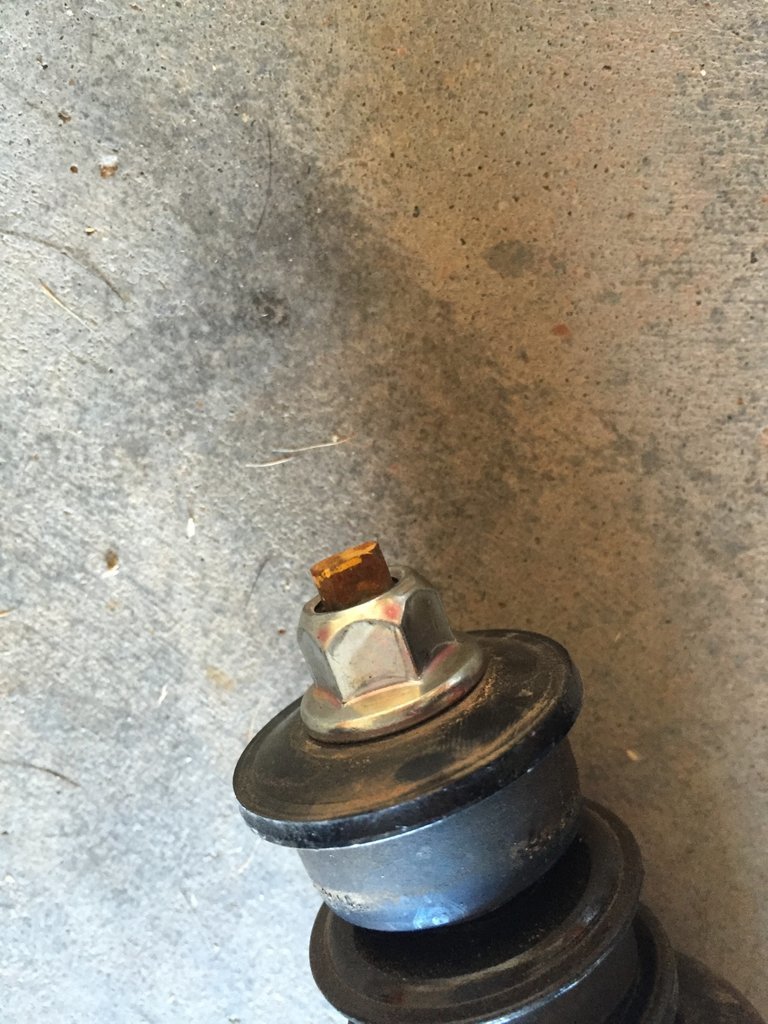

    So, after the install I inspected the OEM shock. This is a 2015 with less than 1000 miles. I already see rust. Sigh.

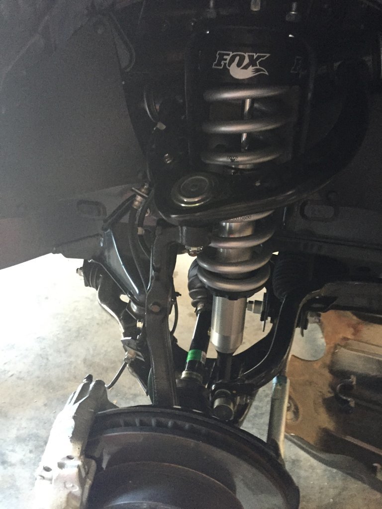

    On to the front! I'm not gonna lie, this one was tough. I removed the sway bar ends, dropped the tie rods and busted one using a ball joint separator. Thank god Autozone had a moog replacement. Use a pitman arm puller not the demon spawn that looks like a big fork. you know that thing that doesn't help you do anything at all but tears up ball joints like your minds eye when you google blue waffle. Don't google it!
    remove the bottom mount and the top 3 mounts keeping the center intact but that sucker was stuck in there. Using a prybar braced against the frame and pushing on the lower control arm got the OEM sucker out but I knew the new one wasn't going in the same way. I removed the UCA ball joint but in hindsight I think I would drop the LCA ball joint instead. After some grunting with a rope to pull the UCA back down to secure it and my neighbor checking on me because he thought satan had opened his hell's chasm in my garage and I got it pieced together. Shiny!
    After piecing it all together I went back to torquing..hehe...the rear shocks and back to the front upper and lower mounts just to make sure.
