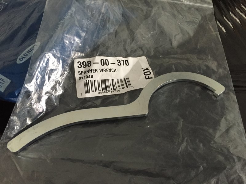

    Chas or anyone with the 2.0s. I wanted to adjust my preload today and this is the spanner that I was sent but it doesn't seem to fit on the bottom ring to adjust! Is this the wrong spanner? When I place it on the ring it's keeps slipping. image.jpg

    Are you trying to adjust it on the truck?

    yeah from what most people are saying, all i need to do is take the tires off and lift the truck so its at full droop. Then I can just loosen the set screw and turn it, but this spanner obviously doesn't even fit my collar. I thick it fits the older style ones that Mully has.
    If I have to keep removing this coilover each time to make adjustments that would just be ridiculous. I'm sure theres a way to adjust these while on the truck.

    I'm sorry to disappoint you but you will be required to remove them from your truck each time you wish to adjust them. Doing so on your truck will ruin your shocks.

    Not, I have adjusted mine several times on the truck.

    I dont think most cars or trucks require that. Isn't that the purpose of adjustable coilovers to be able to adjust them on the car for convenience? If you look at most youtube vids, most of them just use two spanners. the 2.0s in this case only has 1 collar.
    Its probably safer to remove them, but shouldnt be a must.

    IFP 2.0's are aluminum bodies and most certainly shouldn't be adjusted on the truck. Sure you can force it and possibly ruin the threads on the body if you choose to. It's already been confirmed by more than one technician from Fox when I tried to adjust mine. Anyone with the earlier steel bodied Foxes can adjust them on the truck.

    Well then if thats the case i'm very disappointed in my purchase. The sales rep at truck fest told me they were adjustable while still on the truck. So each time i have to check adjustments I have to spend 2-3 hours for each adjustment removing all the parts. Horrible design then and might need to return them.

    Yes I was equally disappointed as well. I also mentioned to more than one associate at Fox that they should've made a note for their aluminum bodied 2.0s a) so we can make an informed purchase b) so that owners don't permanently ruin their shocks
