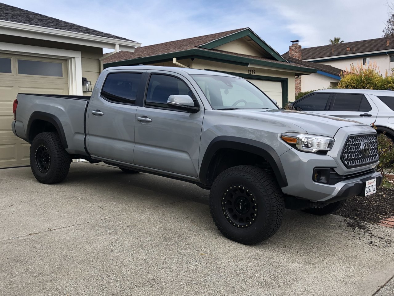

    I had 2.0 coil overs and rear resi’s installed a few months ago and am loving them.
    The ride is smoother and steering feels much more planted while on road.
    Oh yeah the look is nice too :)

    nice! how high id the front lift?

    I still haven’t measured exactly but it’s about a 2-2.5 inch leveled lift. I do have the 3 leaf progressive AAL in the back as well.
