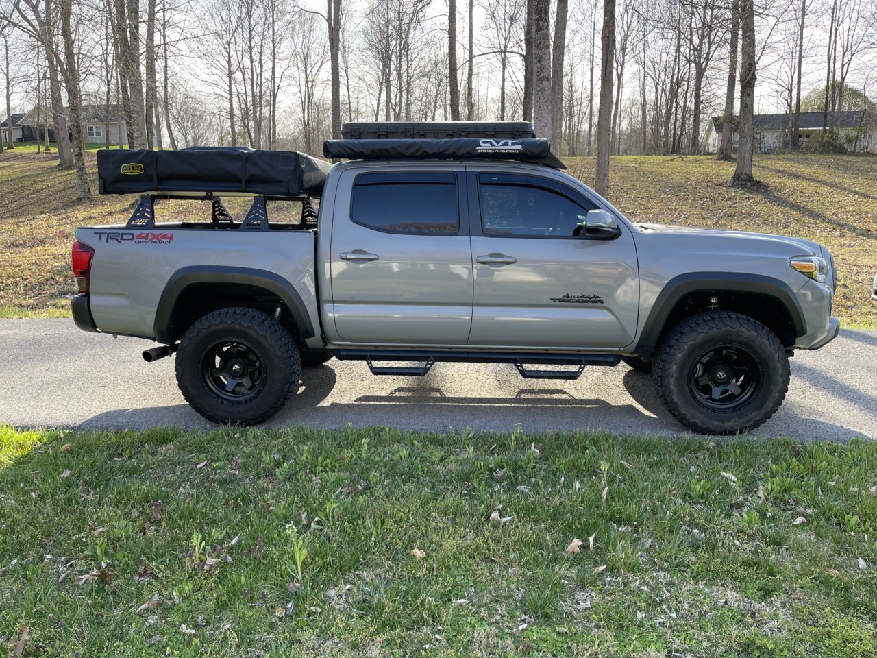

    When I bought my 2019 TRDOR it had a 1.5" spacer lift in the front and a 2" lift block in the rear.
    Originally I planned to ditch the spacer lift go a little bit taller. I found a set of Freedom Offroad UCAs for a great price and stored them in the garage for when I needed them in the future. Non-adjustable, but couldn't complain for the price. Plans changed and I'm happy with the smaller lift height on the truck. So I picked up a set of Fox 2.0 coilovers and shocks from a guy who had just traded his truck in for a great price. ~5K miles on them.
    I compressed the springs and gave them a few turns, and ended up netting a little less than the 1.5" spacer I had originally, probably ~1.25" if I had to guess. I can still clear my 285/70/17 BFG KO2s just fine on the road. (Haven't checked at full suspension flex yet). I'm also planning on the Icon 1.5" AAL in the rear soon.
    My question is, should I install the UCAs since I already have them? Freedom Offroad has them listed as 2"-4" of lift. I don't get nearly as much bump steer with the Fox coilovers as I did with the spacers. I noticed while installing the new suspension at full droop the stock UCA hit the coilovers.
    Benefits? Disadvantages? I know they aren't technically needed, but I do already have them and wouldn't take much work to get them installed.

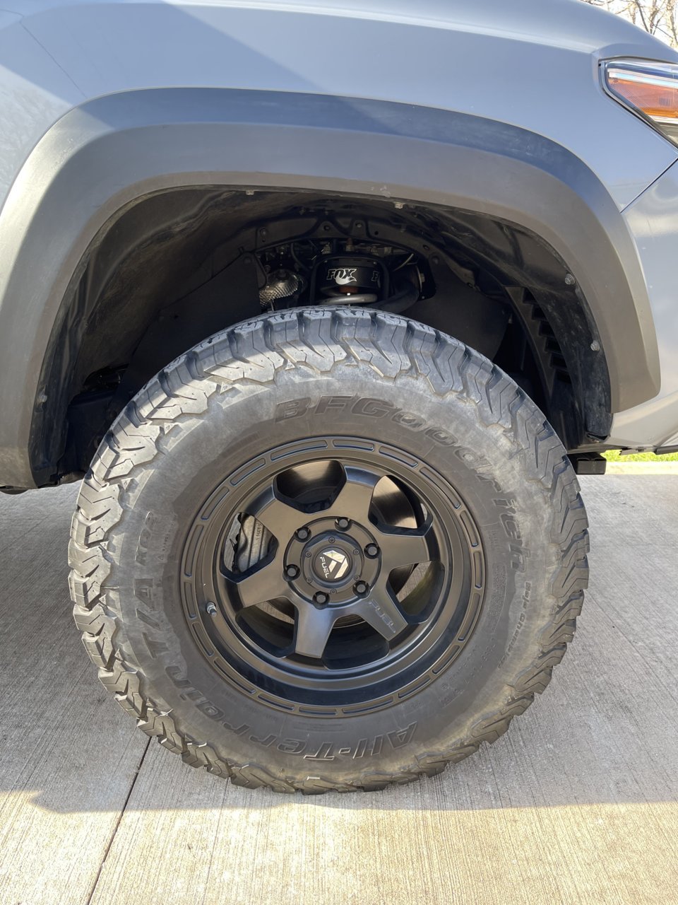

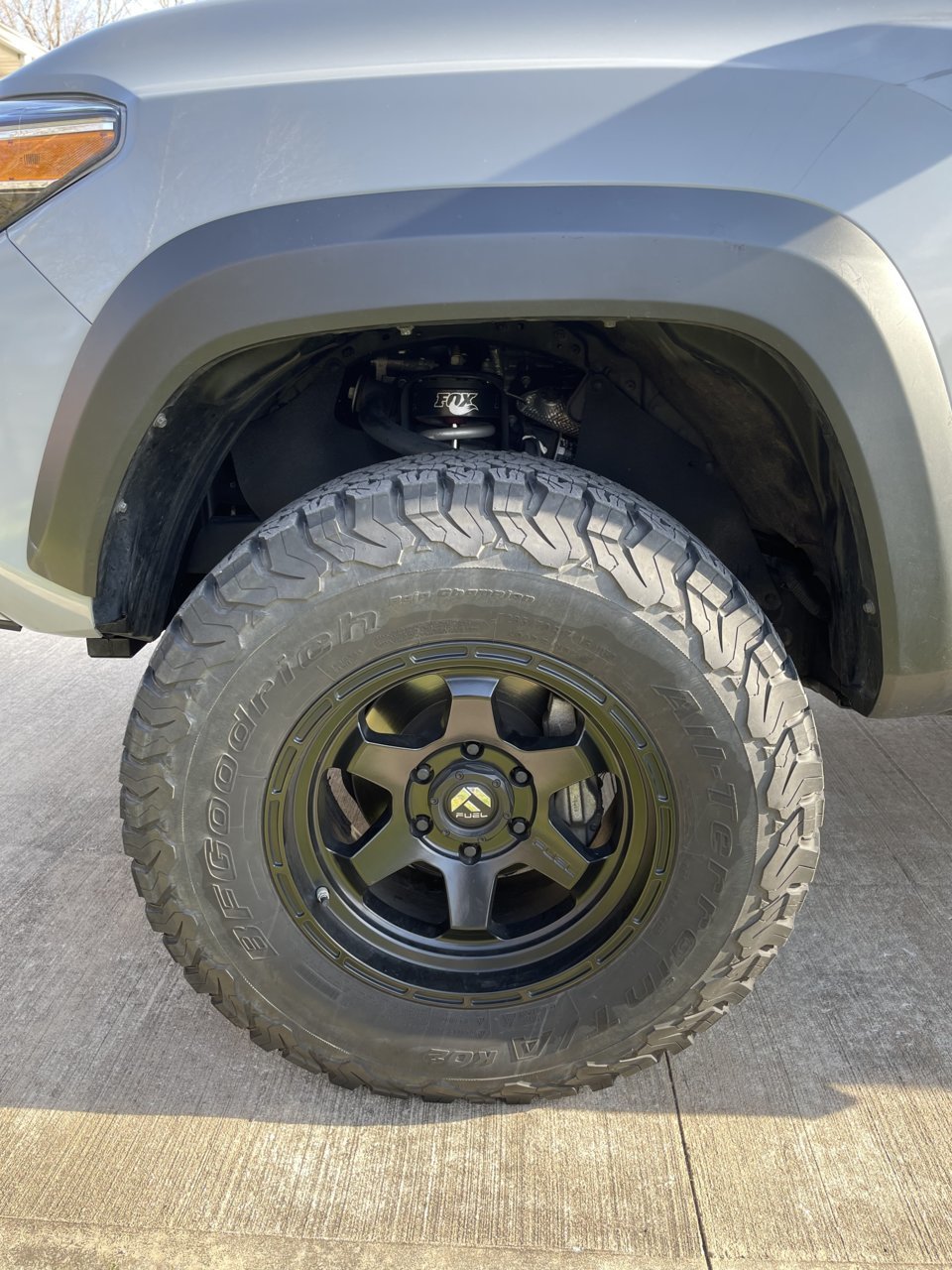

    In case tire spec would influence anyone's opinion on the aftermarket UCAs causing rubbing issues with the Fox 2.0s:
    Fuel Shok 17x9 with an offset of +1 wrapped in 285/70/17 BFG KO2's
