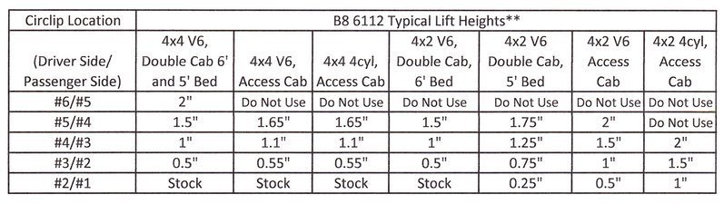

  18. Sep 9, 2021 at 1:30 PM
    #38
    Dazed
    Dazed Well-Known Member
    May 7, 2016
    #186370
    92
    2016 TRD Sport 4x4 DCLB
    Completely new to doing anything suspension related, looking to bounce some ideas off you fine folks.
    I'm looking at getting the Bilstein 6112/5160 just for light off roading and to level out. If I can get any lift it's just a bonus.
    Looking at getting the full replacement leaf pack from Icon because I do use my truck for trailer and transporting stuff.
    With a lift as minimal as 1.5 to 3", should I be looking at getting a differential drop kit? How about Upper control arms since one of my uniballs has started clicking when stopping or going over a bump?
    71tattooguy likes this.

    Kings 2.5” front and rears from Accutune / ICON RXT LEAF PACK black badges doors and tailgate / method 315 / 255/85/16 Yokohama G003 / magnaflow exhaust , axle dump / meso int delete kit / meso led map lights / dome lights / wheelers front super bumps / accutune Flip kit with spacer and new bumps / Cali raised fog light pods / Cali raised ditch lights / RCI FULL SKIDS / SLIDERS / RCI rear bumper / rigid backup lights / tuned on 4.88’s
    Hers is the 6112’s settings I went with 6/5 600lb springs I have full skids / sliders on the way. I’m a little under 2” which is fine IMO. RIDE is great. I have about 1.5” of rake which I like for loading and using like a truck. I have Deaver 1.5”- 2” aal with overload in. I will be getting Icon RXT leaf pack in the future. Hope this helps. Also UCA’s will help with a lot. IMO I would get them

    Sapnjack
    Sapnjack Well-Known Member
    Dec 2, 2018
    #274538
    535
    Daniel
    Phoenix AZ
    2016 TRD-OffRoad
    Bilstein 6112/5160 Dakar EL096R Leaf Springs KO2 265/75/16 Tires OCF Rock Sliders Cali-Raised Hidden Lightbar Diamonback Cover HD KB VooDoo Premium Rack CVT Tent ARB Awning
    6112/5160 are great overall shocks on and off road. Stick to under a 2 inch front lift and you won’t “strictly need” upper control arms. 6112’s at the highest setting are a 2 inch front lift so you should be good.
    In a stock vehicle, the rear is 1/2-1 inch higher than the front so that you don’t sag when you fill the bed of the truck with stuff; this is commonly referred to as “rake.” You’ll need to raise the rear an equal amount as the front to keep the factory rake. Either with add a leafs, new leaf pack, or blocks. Icon add a leaf or their RXT pack are good options.
    if you find yourself sagging when towing heavy loads consider a product called “Sumo springs” which add extra support only during heavy loads. They replace the factory bump stop. Another option is to get a leaf pack designed to carry heavy loads (not just raise the rear), but they give a harsh ride when the bed is empty.
    A 2 inch lift may look odd with stock wheels/tires. A 2 inch lift pairs well with 275/70R17 wheels/tires (32 inches). If you go wider/bigger than that then you’ll need something called a “cab mount chop” and will probably need to regear your truck so I don’t recommend it unless you’re going all out. If you have 16 inch wheels then your option is 265/75/16 (31.5 inches). Stock tires are 30.5 inches.
    lastly… you can just lift the front 1/2 an inch with the 6112’s and not worry about touching the rear or new wheels/tires. You’ll be closer to a level front/back and lose your “rake,” and might sag when you have a heavy load (unless you add sumo springs).
