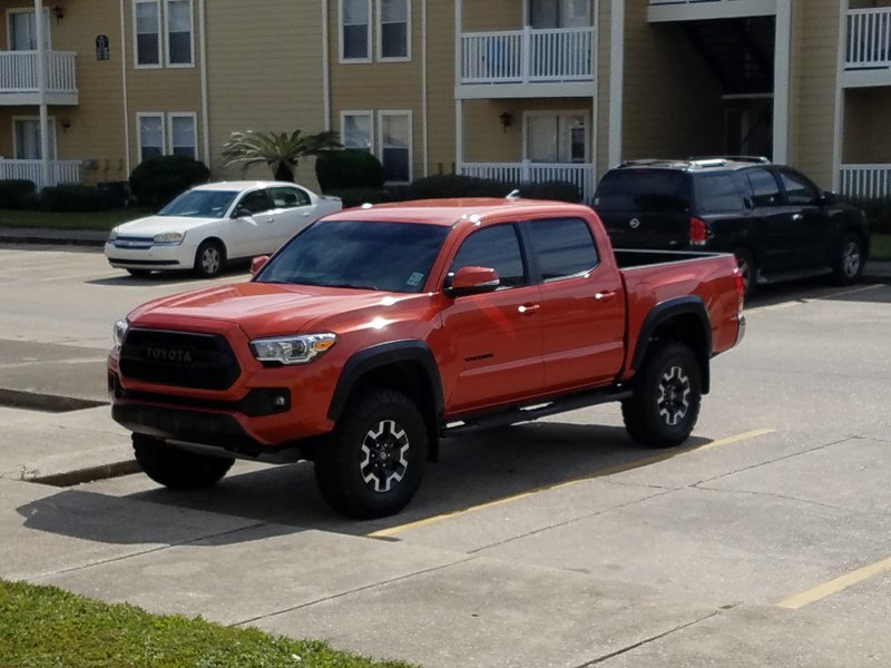

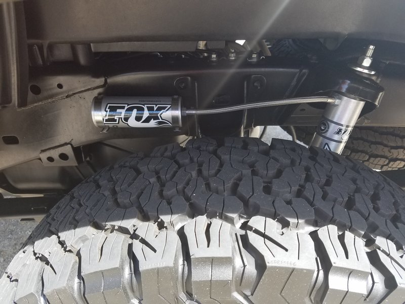

    If anyone is thinking about lifting or improving their factory suspension , and are thinking about Fox or Bilstein this is my personal experience with both of them. My truck is the Inferno Tacoma , and I went with the Fox 2.0 coil-over in the front ,and the Fox 985-24-117 remote reservoir in the rear pair with a 2 inch block (If you have a 2-3 inch rear lift this is the one you need). The ride is firm and well control especially when cornoring and stoping , there is no nose diving at all, Off road is the same but a little too firm .

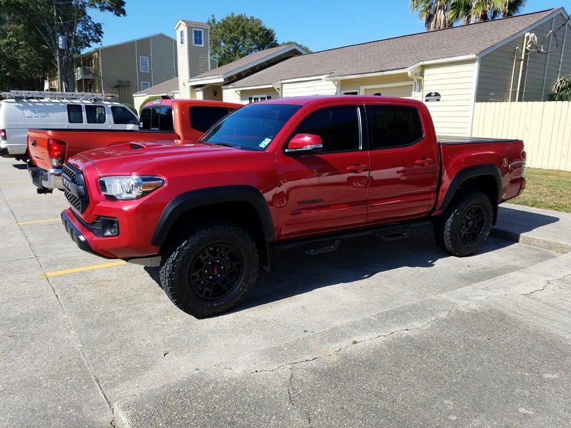

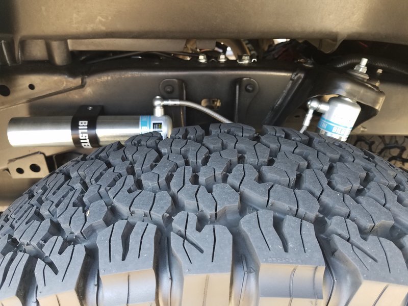

    The Barcelona red Tacoma belongs to a friend of mine , it has the new Bilstein 6112 up front and 5160 also reservoir in the rear with 1.5 block. The ride is way smoother and softer than the Fox , but not as control . I think the Bilstein shocks are way better than the Fox , especially when you go over bumps or bad roads, plus they are cheaper
