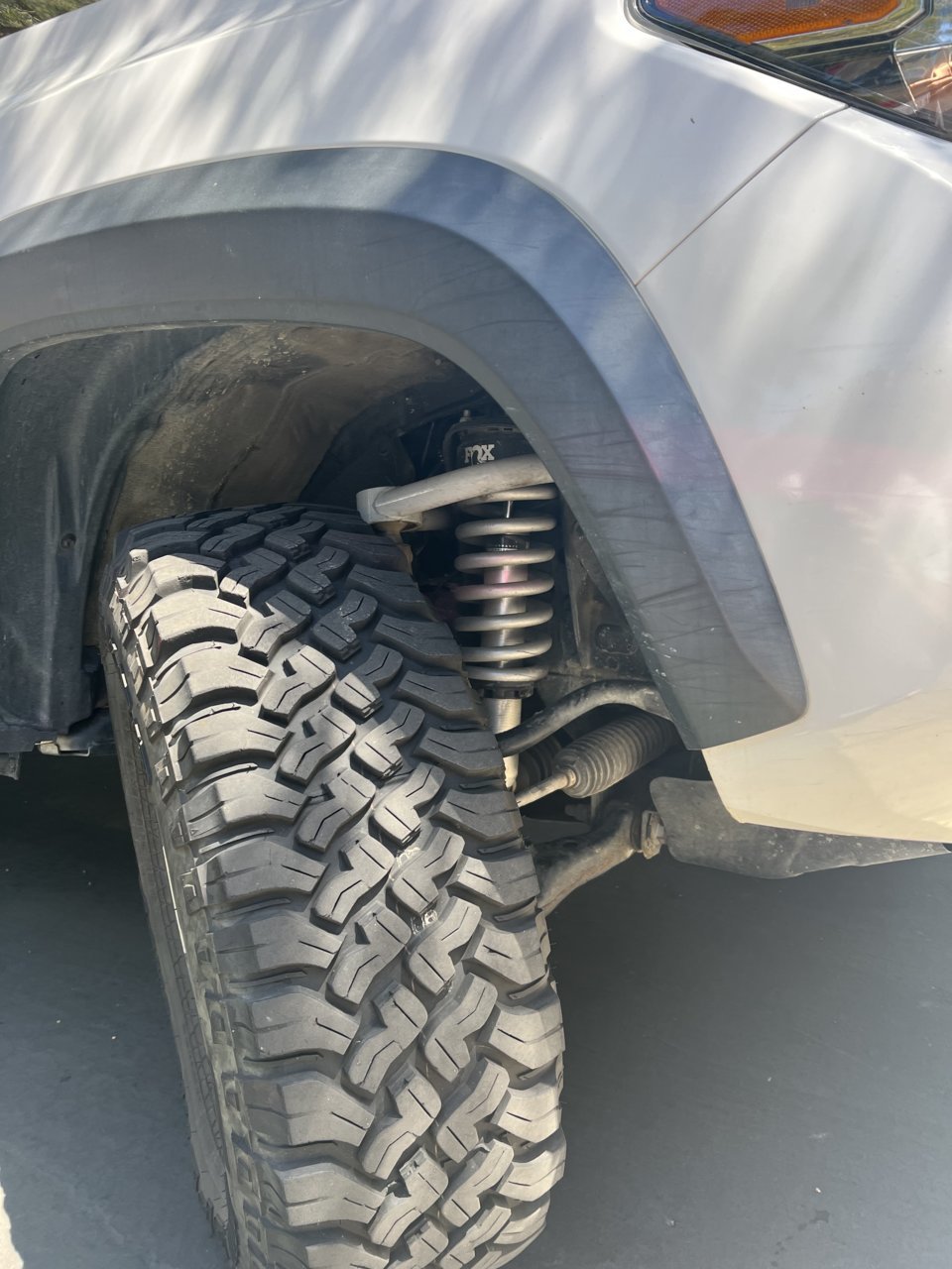

    Hello!
    Not too long ago I had fox 2.0 coils installed along with all-pro chromoly upper control arms.
    We used the stock settings on set and there’s almost no real lift over stock.
    Anyone have a setup like this and added more lift? How much should the collar be raised? I’m looking for a 1-2” lift over stock.
    thanks!
    PJ

    The motion ratio is about 3:5, i.e. raise the spring perch 0.6" to get about 1" of lift.
    Temporarily disconnect the sway bar and loosen the LCA cam bolts while you are checking the lift height (so the sway bar and bushing bind won't give you a false reading). You'll probably need to raise the driver's side spring perch more to account for Taco lean.
