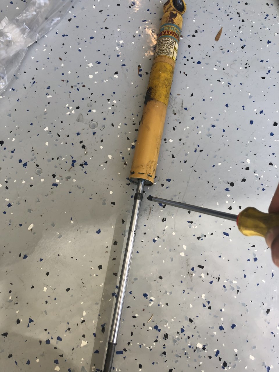

    931DE69F-D526-4970-9D4A-1A6F4B54B407.jpg Pic of the blown bearing housing

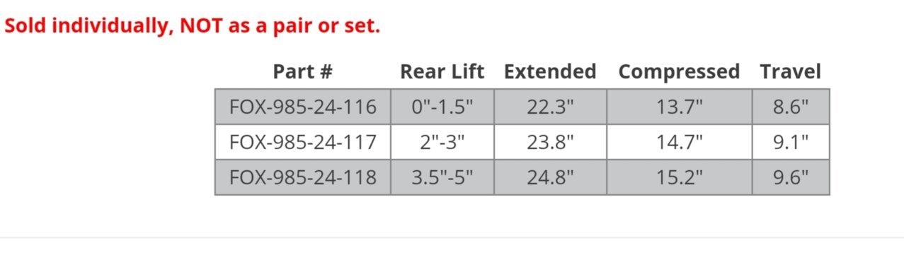

    Just went out to measure.
    Body on the 117 is 12.5
    on the 118 it’s 13.5.
    not just a internal spacer/travel limiter issue

    My quick search shows 117 as non- adjustable and 118 with a compression adjuster. Both fit.
    Why would you go to Fox and get it rebuilt?
    "Running it additional 0.5"", what does that mean? That won't matter.
    Oil volumes different? Totally irrelevant on shocks like this.
    Make sure you don't have 2 different models of shocks. If they're the same and they don't bottom or top out early as your suspension cycles everything is technically fine.

    I'm with you now. 117 spec'd to fit 2-3" lift and 118 3.5-5". If you're just 1" the 118 may very well be a touch long.
    Not that big of a deal just very frustrating.

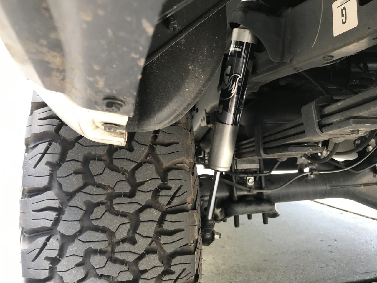

    Here is my rear fox 2.0 with no additional lift. (its the 117 so I can lift the rear if I want to... currently sits nearly level)
    265/75/16 KO2s
