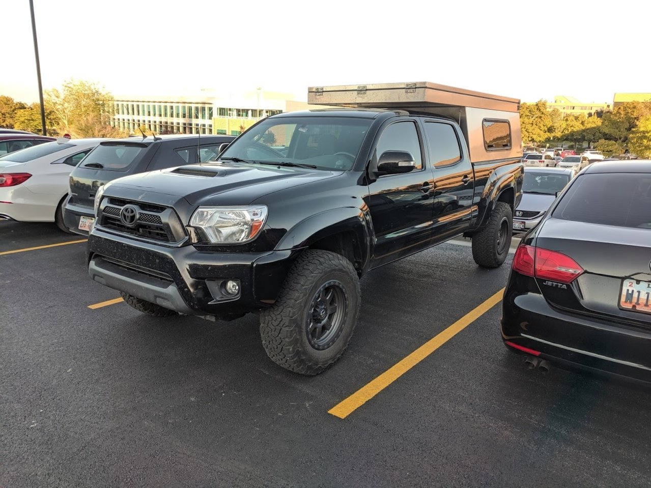

    To be clear, I have the Fox 2.0s set at 2.5" up front now.
    Leaf pack is Icon RXT stage 3. I carry about 500lbs in the back daily and it still has a slight rake...

  15. Oct 3, 2019 at 1:15 PM
    #215
    BajaBornOffRoad
    BajaBornOffRoad Well-Known Member
    Aug 7, 2019
    #301520
    87
    2019 Cement TRD Off Road
    that's my exact setup, lift that I'll have them set it. 2.0's at 2.5" lift. Looks solid! I'll post some pics after my install tomorrow.
