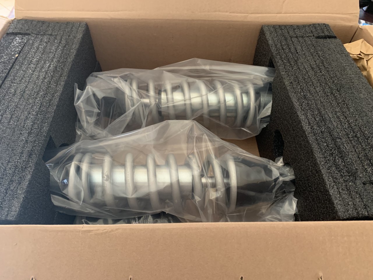

    Mine just arrived too. OMG. I am amazed and must give WheelWell their props.

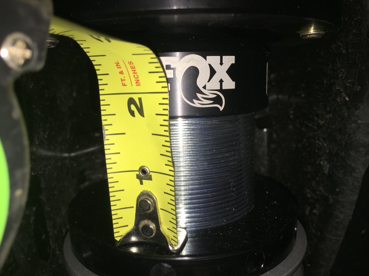

    Just installed Fox 2.5's on the 2020 with 200 miles on it. Install was easy- I unbolted the sway bay and links, disconnected steering tie rod and the shocks came out easy.
    I did notice a 2 inch lift, but it settled almost to the original stock height 35 1/2 front.
    Will be selling the rear 2.5's as am not going to use them.
    Sungod likes this.

    U left the preload collar at the height it shipped at? What length was it?
    Unitedgrey likes this.

    Yes. I installed them as is.
    I hope you mean the pic attached. If not I can measure it.
    Skydvrr[QUOTED] likes this.

    Yup! That’s what I meant. And u settled around ride height eh?

    I am on stock 265/70's for now so height doesn't matter yet.

    I'm just saying, that measurement brought you to around stock ride heigh?

    yeah. I was kind of surprised too. The shocks do have a lot of thread to raise it. Still can't believe they actually arrived.
