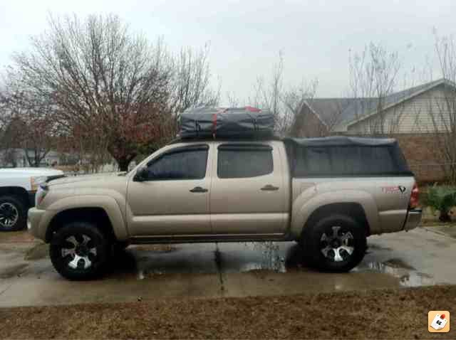

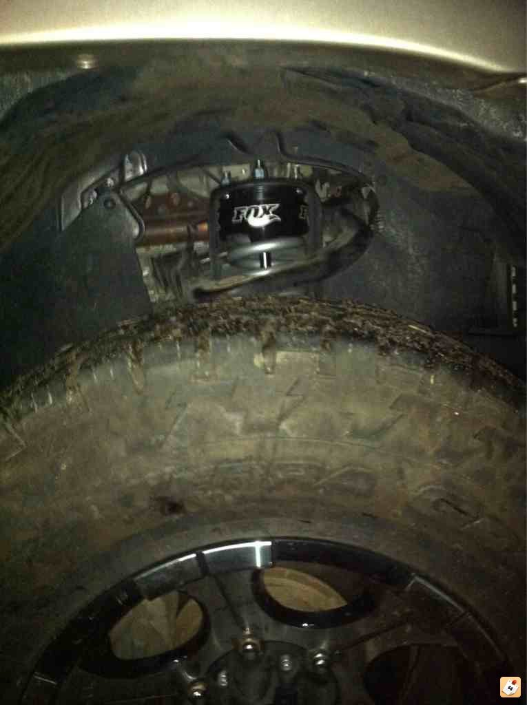

  3. Nov 27, 2013 at 7:28 AM

    I didnt want to do a review yet because i wanna ride a couple thousand miles before making a thread on this suspension.
    Quick review thus far(2 tanks of gas so far since the install)
    *Note, i removed the sway bar*
    -Flex is very good(Went to Gulches Off-road vehicle park)
    -Lift is quite nice ~ 2" out the box without making any adjustments
    -The ride is plush. We rode down some back roads and it didnt feel too shabby at all
    -For the price... Eh, i got it for a good deal so it was worth it to me. TO those who say it isnt worth it, i disagree. If your uses for your truck doesnt include high-performance activities(prerunning or rock crawling) Its a very decent shock for the buck with the ability to increase lift at the same time like it's 2.5 counterpart.
