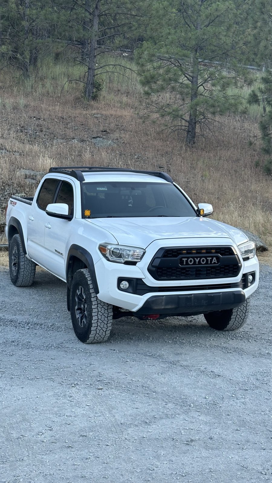

    This is my 3rd gen build. I’m 21, in college, working construction part time. I’m broke as shit, but I’m saving for a suspension upgrade. I like the OEM/stock look of the 3rd gen, and want to keep my build kinda sleeper and lightweight. Not trying to cut any panels, or do a crazy lift. I overland once in a while, but I mainly like “racing” off road trails, and was planning on hitting some desert trails this summer with some buddies. Stock suspension does ok I guess, but the ride is pretty rough when hitting more rocky terrain. So I was thinking about getting some fox 2.0 coil overs and rear shocks. I heard the progressive operation of the fox shocks is better for more “racing” oriented off road stuff compared to bilstein 6112’s which im told are better for slower crawling/overlanding stuff. What Yall think? The fox with reservoirs for the back will be like 1400, the bilsteins will be like 1200-1300
