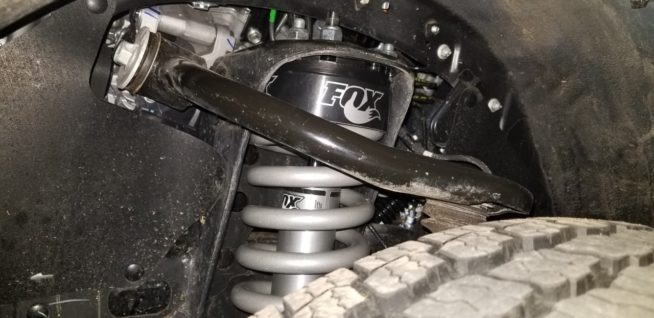

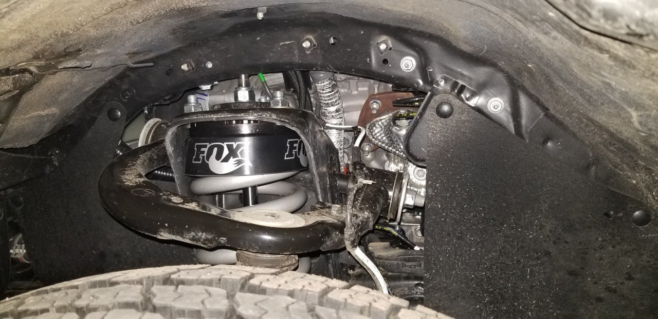

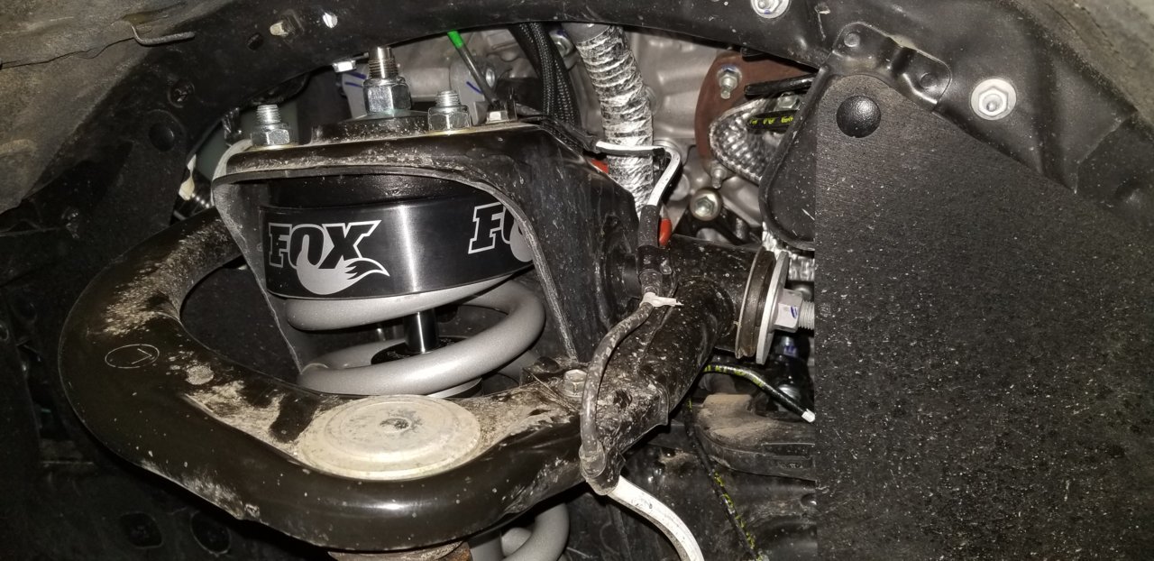

    Are you completely maxed out or did you just install them right out of the box? Can you post a picture of how much thread you have left?
  12. Jan 21, 2020 at 3:50 PM
    LazloCO
    LazloCO Well-Known Member
    Apr 5, 2019
    #289206
    581
    Brian
    Morrison, CO
    2019 Cav Blue TRD OR DCSB
    Rock Lights, Sliders, Softopper, Fox 2.0 shocks F/R, AAL
    I installed them (or my friend did) right out of the box. I can get a picture to attach.

  19. Jan 22, 2020 at 9:06 AM

    Here are pics.
    doubleBibbs likes this.

    Those are adjusted from the bottom, not the top.
    Measure from the center of the lower shock bolt, to the top of the top hat. From there we can make a suggestion on how much taller you can go.
    For reference, that IFP coilover is rated to 0-2" of lift.
    Collapsed length is: 17.60"
    Extended Length is: 22.225"
