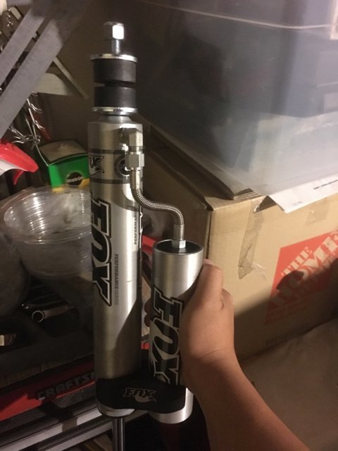

    Happy easter everyone. Anyone got a pic of how they mounted their fox 2.0 resi rear shock? We mounted it yesterday and ended with this

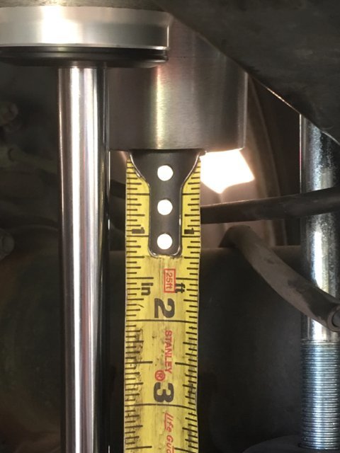

    Only 1 in space between the axle, so i took it off and will call fox to verify.
    But then could not sleep last night and played around with the shock it ended up like this.
    Just wondering if its suppose to go this way.
    Thanks.

    I have a set of these same shocks on order. Can you spin the shock 180* so the the reserver is on the other side? Or move the resi around the shock a little? Keep us updated.

    I run this same setup on my Jeep JK. have had no issues in 2 years of service. You are not likely to hit rock bottom on that shock and if it did contact something it would give before smashing. My Tacoma has them mounted to bracket on the frame, but by looking at the angle of that resi tube coming out of the shock it may not want to bend 90 degrees.

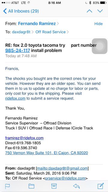

    Nope the fittings hits the shock mounts. Emailed fox and the said i have an old stock. So i sent them in for service. New ones come with 10in hose and v fittings.

    thats good on Fox to do that.
