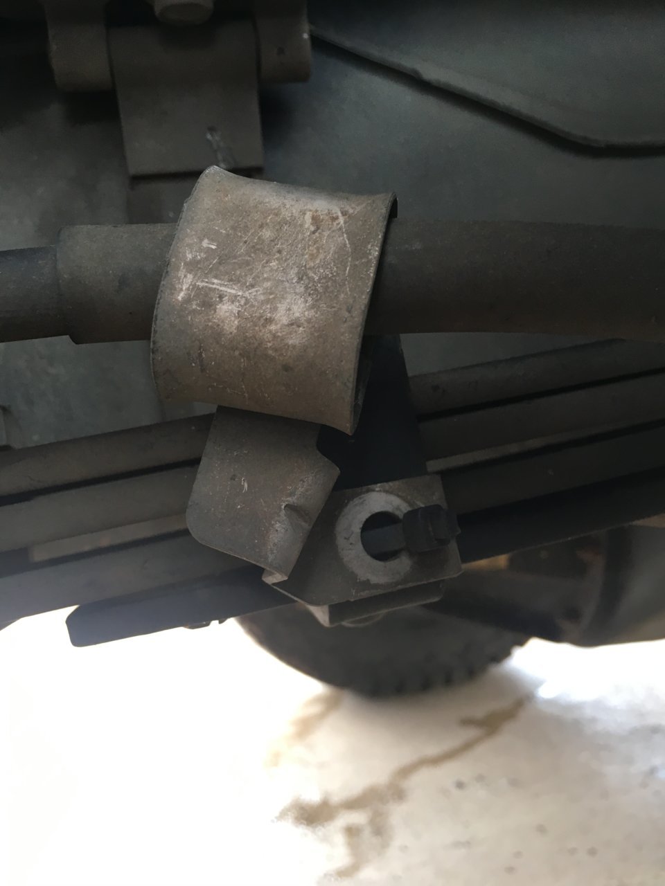

    I’ve got the same setup as you and am wrapping up my install. Where did you end up putting the brake line holder that used to be connected to the overload leaf?
  9. Jun 4, 2018 at 9:08 AM
    #69
    AY_ARONTRD
    AY_ARONTRD [OP] Well-Known Member
    Sep 25, 2017
    #231065
    4,074
    Aaron
    Murrieta ,CA
    2019 DCLB Cement OR 4x4
    We ended up putting mine on the bolt for the leafs.
    drewhaus[QUOTED] likes this.
  10. Jun 4, 2018 at 9:20 AM
    #70
    drewhaus
    drewhaus Well-Known Member
    Feb 28, 2018
    #245938
    241
    Andrew
    El Granada, CA
    2018 Tacoma
    Thanks, did you drill the hole to be a little bigger? I tried that originally and noticed the leaf bolt wasn't getting through.
  11. Jun 4, 2018 at 9:32 AM
    #71
    AY_ARONTRD
    Sep 25, 2017
    #231065
    4,074
    Aaron
    Murrieta ,CA
    Yea just hit it with a unibit. Worked out just fine
  12. Jun 4, 2018 at 10:11 AM
    #72
    Yotaholic
    Yotaholic Well-Known Member
    May 19, 2017
    #219388
    276
    Oahu, HI
    2017 DCSB Sport 4x4 MT
    i zip tied mine to the AAL bracket. No issues so far.

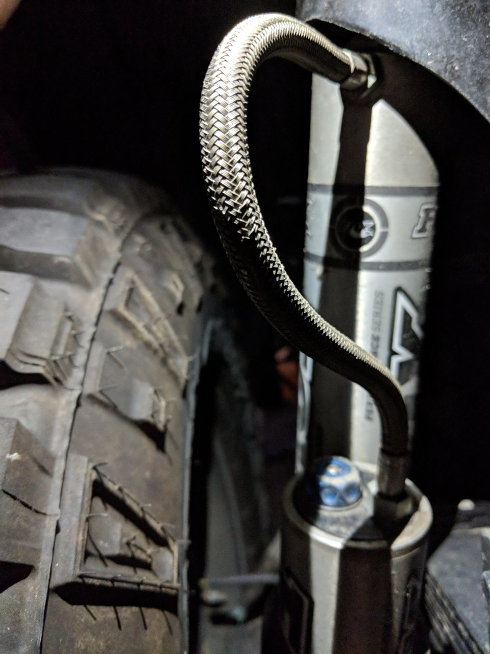

  13. Jun 4, 2018 at 6:00 PM
    #73
    drewhaus
    Feb 28, 2018
    #245938
    241
    Andrew
    El Granada, CA
    2018 Tacoma
    Alright, wrapped my install up and took a spin around the block without any issues.
    One thing bugging me is that it feels like the rear reservoir is a little close to the wheel on the passenger side. I can’t adjust it much more without the hose getting close to the shock mount.
    How much space do you guys have between your rear wheel and reservoir?

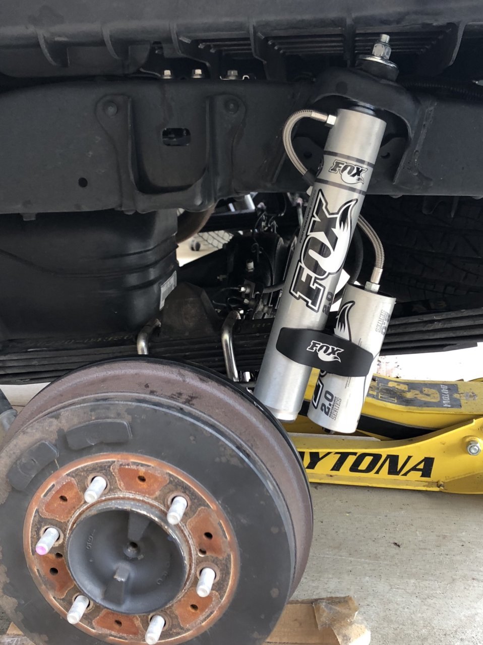

  14. Jun 4, 2018 at 6:06 PM
    #74
    AY_ARONTRD
    Sep 25, 2017
    #231065
    4,074
    Aaron
    Murrieta ,CA
    Here’s what we ended up doing with the rears 7578572B-893D-4064-92D4-457479E5915F.jpg
  15. Jun 4, 2018 at 6:09 PM
    #75
    m603holden
    m603holden @Koditten Pirate Radio member #063
    Oct 18, 2014
    #140581
    11,732
    Marteeen
    New England
    2017 Tacoma DCSB OR MT
    Lots of sail boat fuel
    That hose connection is awfully close to that sheer point on the mount. Just a friendly comment. I like the idea though.
  16. Jun 4, 2018 at 6:10 PM
    #76
    AY_ARONTRD
    Sep 25, 2017
    #231065
    4,074
    Aaron
    Murrieta ,CA
    Yea after the photo we ended up turning the shock a bit. So far so good.. check it every so often
    drewhaus and m603holden[QUOTED] like this.
  17. Jun 4, 2018 at 6:13 PM
    #77
    m603holden
    Oct 18, 2014
    #140581
    11,732
    Marteeen
    New England
    I check after every fire road scramble. After hearing stories it just sits in the back of my head haha.
