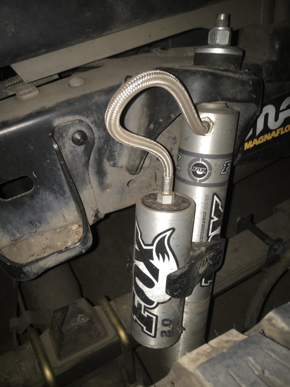

    This is home my rear passenger is set up. I had my resivoir towards the front at first but it would contact my brake line. I’ve fully stuffed my rear wheels with no issues with my current set up.

    Yeah, I’ve got mine in the front right now and it crossed my mind to do this after I noticed there wasn’t much clearance. I might flip it around like this.

    list is growing fast
    This is how I did mine too.
