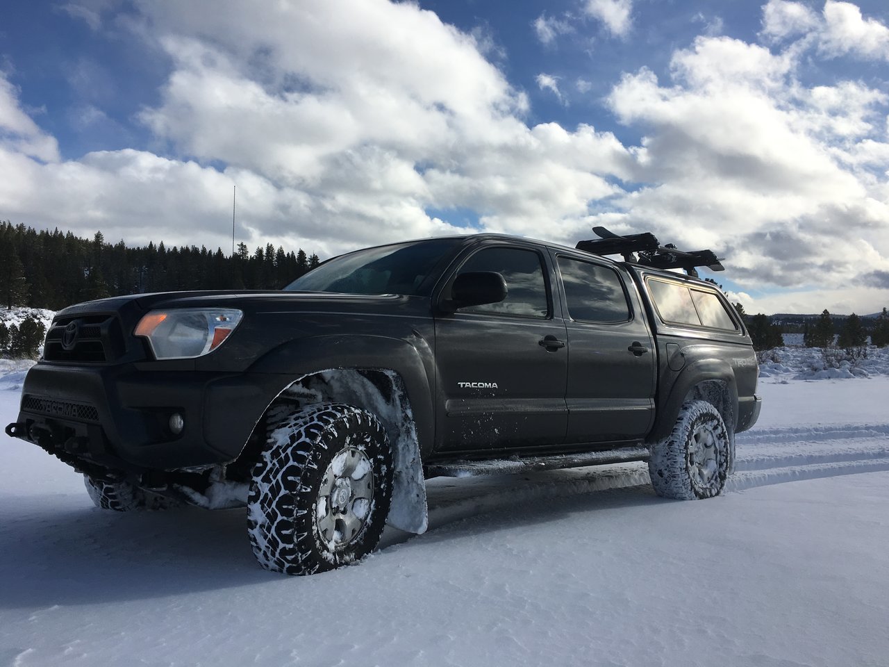

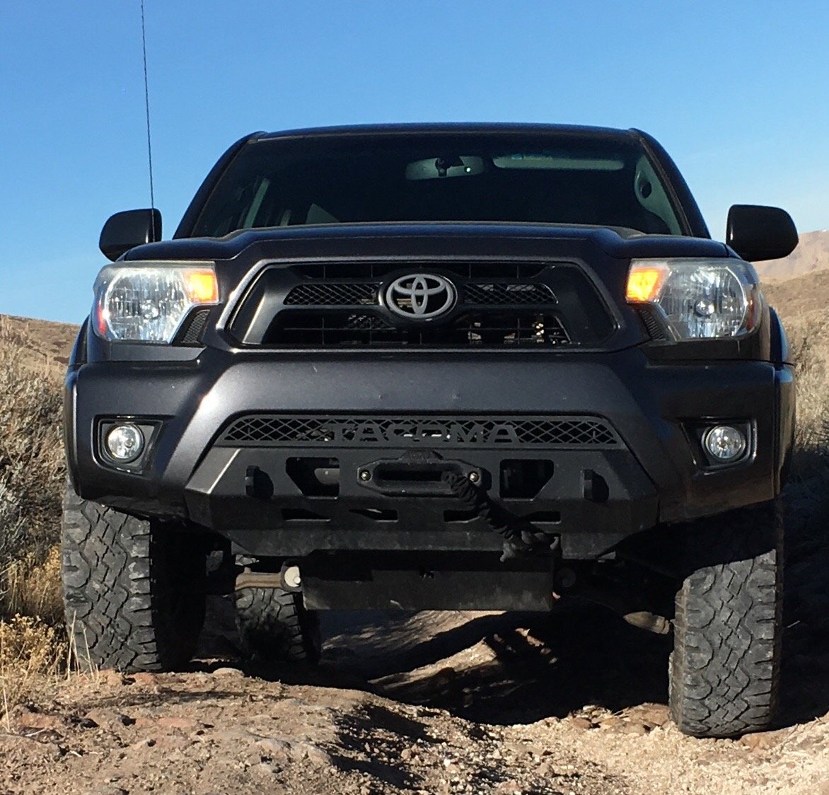

    I'm running factory valving and no additional preload, 2.5 extended travel up front and 2.0 remote reservoir in the back. Extra weight (winch, stingray bumper, skid, bolt on sliders with fill plates), and a shell with 100lbs of gear. Sway bar removed. Light racing UCA. Dakars with the 3rd leaf removed. 265/75/16 load range C.
    I think it rides great on and off road.

    @stickyTaco looks good! Same kit from @HeadStrong Off-Road I'm looking at purchasing. Out of curiosity what ended up being the limiting factor in your ifs droop?Shock? Or other suspension components?

    Not sure what the limiting factor is for droop up front. I didn't cycle the suspension with the shock removed to see if it was more or the same than with them installed.
