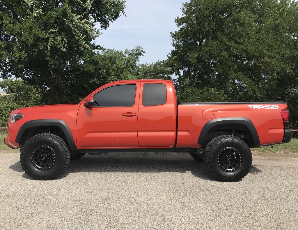

    I got Fox 2.5, Total Chaos UCAs, Fox 2.0 rear, Dakar heavy rear, CMC all installed yesterday. My question is...am I ok to crank the front a 1/2" to get me 1" more of lift in the front? They're installed at the factory setting currently which I believe is 1" of lift on a 3rd Gen. I know the rear will settle some but right now, in person, the rake is quite pronounced. I feel like that photo doesn't do it justice. I figured since I got the UCAs I'm ok to be around 3" lift. I'll obviously get an alignment afterwards as well.

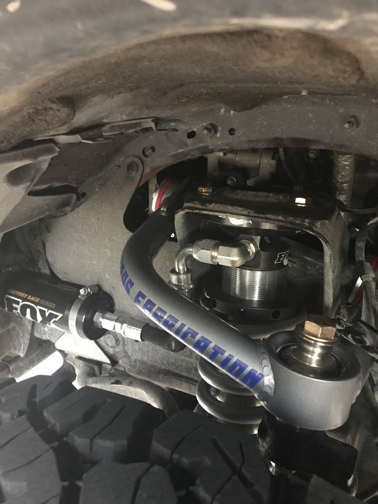

    26C2FBC2-A6F8-41DB-8CCE-BADC9646C50D_zps_694e6bf7d9b17b403e46aeea6c2362bf122e596e.jpg
    Figured it out.

    I did the same center punch method others have used. 5/16 punch and WD40 with all the weight off the wheel.
    I added a 12" pipe to the center punch. I was able to get leverage and it went really easy.
